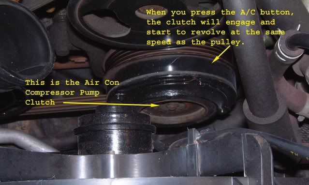

I’ve got a nasty noise that I have tracked down to the a/c pulley area.
(click picture for full size image)
It seems the stationary bit on front of the pulley assembly is kind of flapping about and striking against the rotating pulley, making a tinny clanging noise. There is also some gungy black stuff coming out of the from of the assembly, between the stationary bit and the rotating bit in the middle.
I don’t know much about the operation of this area and my workshop manual is sparse on air con – basically saying “You need to take it to a professional”.
What’s the likely problem? Is there anything I can do, other than pay a professional?
Dave
(1.6 import, 1991)

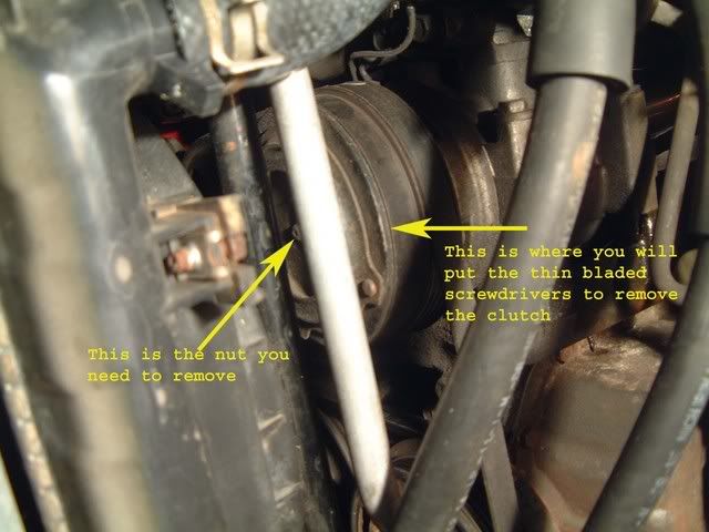

It looks very much like the compressor pump clutch is disintegrating. The clutch is made up of two rings held apart by a rubber material, this material disintegrates over time. Loosen the belts and remove the centre nut and with a bit of help from two screwdrivers it will slide off the shaft but be carefully not to loose two or three distance spaces that are behind the clutch as it comes off. You will need to try and source a S/H one from somewhere but check the name of the make of the compressor as I believe two different makes of compressor were used by Mazda.
Two pictures that may help you from one of my previous posts.
