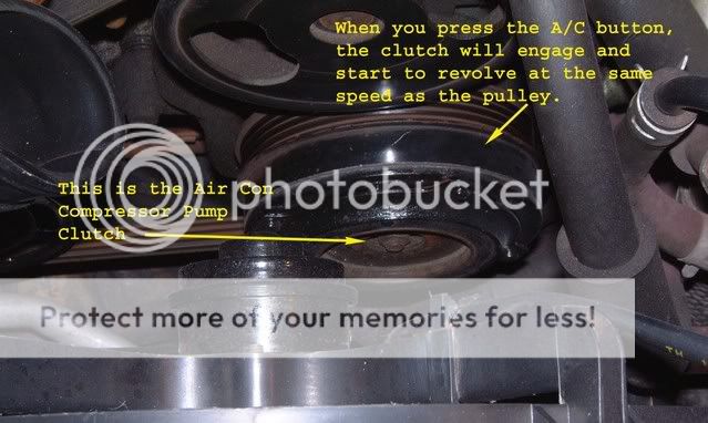

Are you sure that the A/C compressor is working OK? My car is a bit younger than yours and I found that the clutch had started to disintegrate and it was that which was not working. When you switch the a/c on you should look at the clutch to make sure it is turning. If it isn’t the clutch is nackered. If it is then you need to take the clutch off to identify the make as two different makes were used

I think my system is different! the pulley shown in your photo is rotating all the time the engine is running - when I press in the aircon button, this activates the fan immediately in front of this pulley. (I have two fans - I assume they all have!). Does this mean I have an ‘electrical’ system rather than mechanical? Any help out there?
