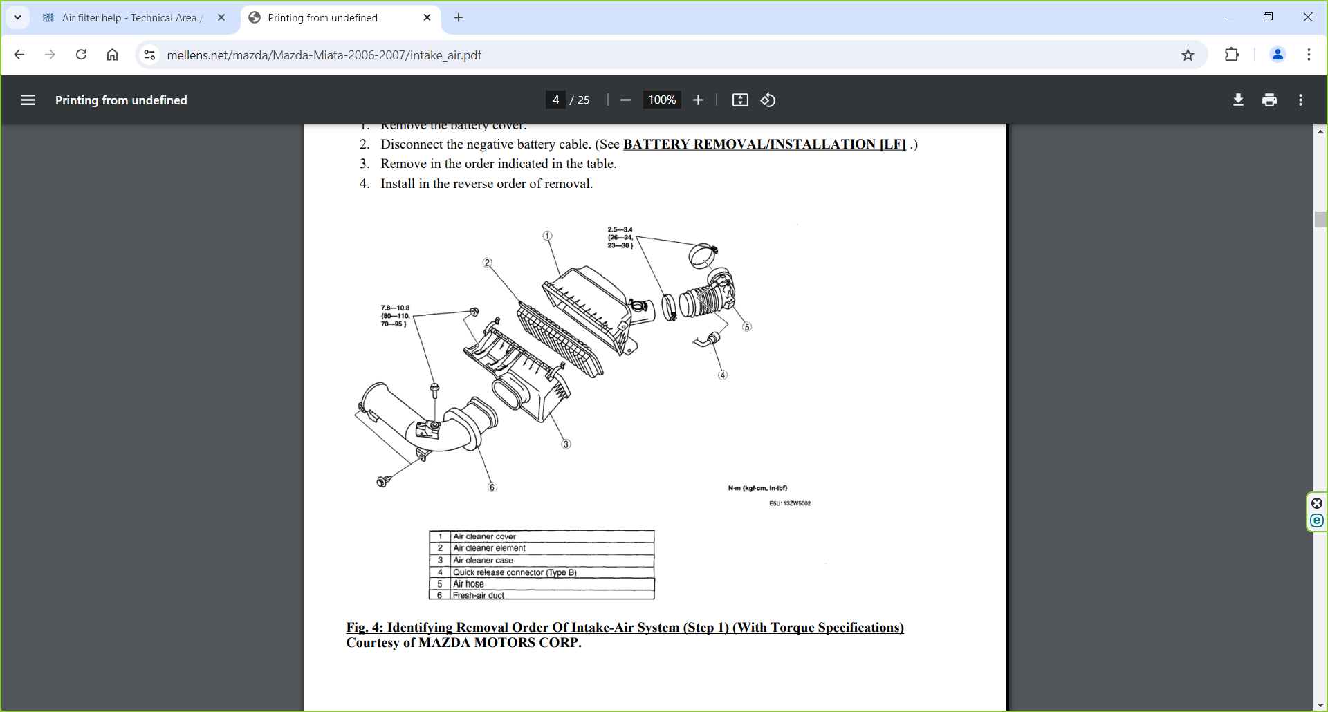

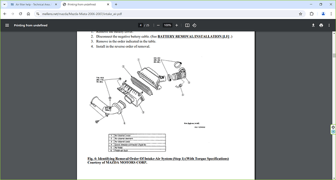

If you fit it with the bulk of the filter underneath so the arrow points upwards, that should be the right way round if I remember correctly.

The filter housing has a a different profile on one corner to aide getting the filter to marry up and fitted the correct way.
