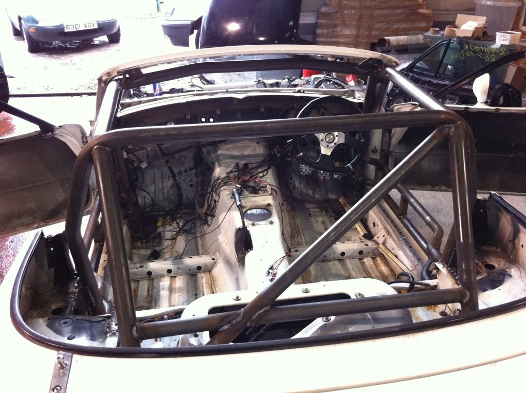

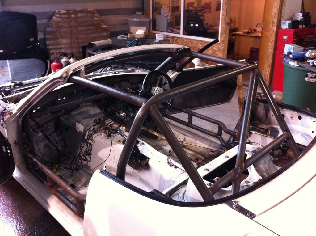

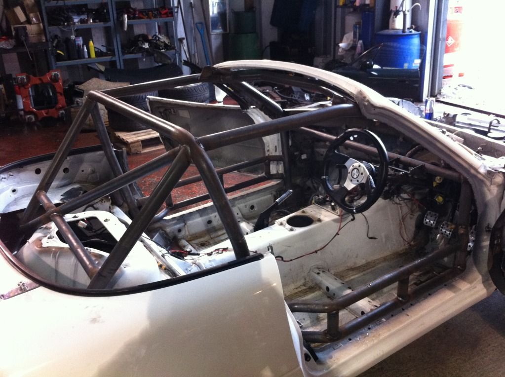

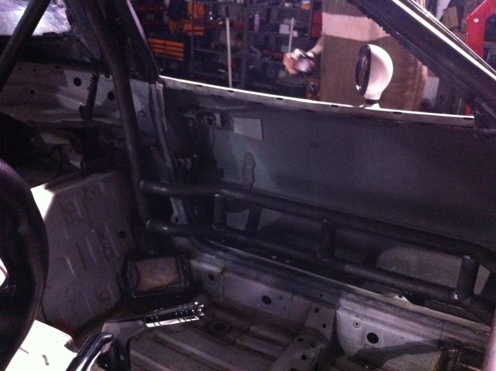

We started out by stripping the car completely and having a custom roll cage built that would allow the addition of a hardtop. The car was then fully seam welded to further add rigidity and the initial diet started with every bit of useless material being removed.

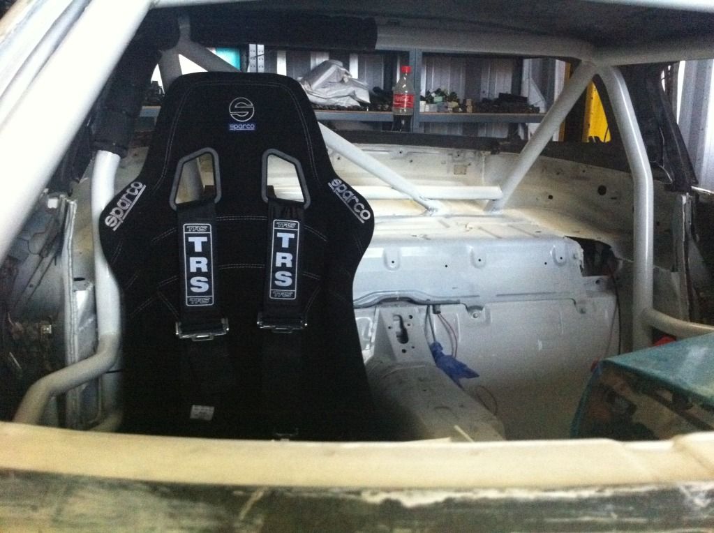

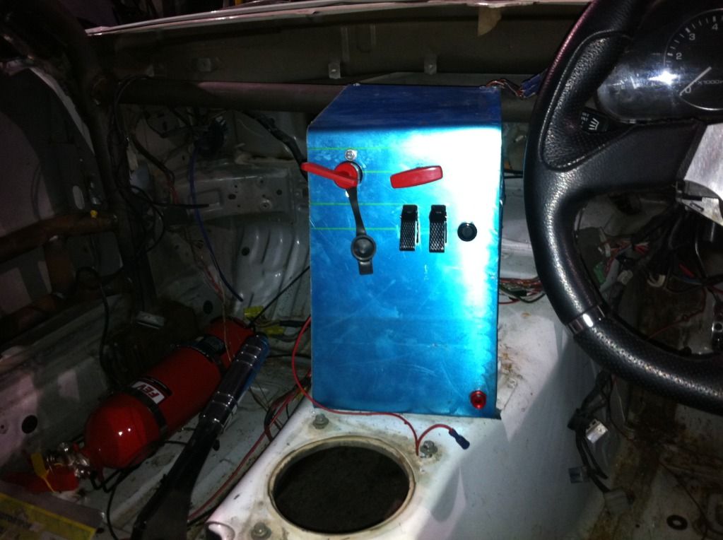

More assembly with the beginnings of the dash and the fitting of the seat.
Posted Image
Posted Image

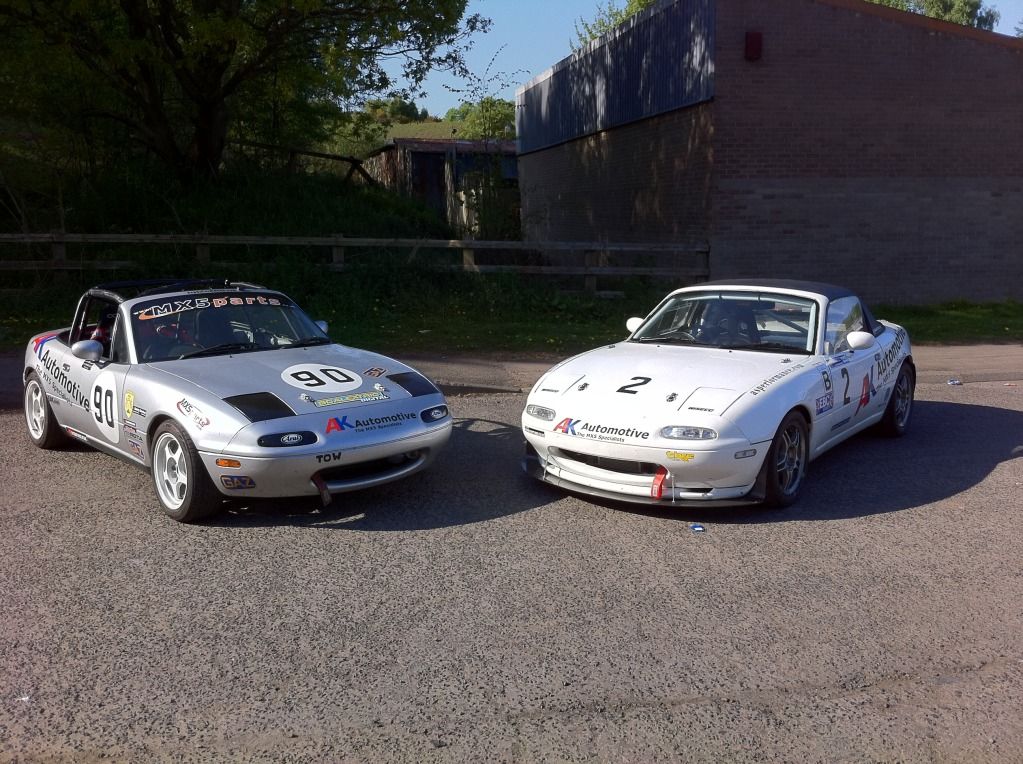

some pictures of the car last year…

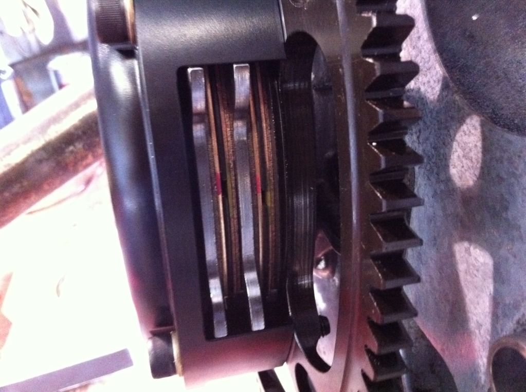

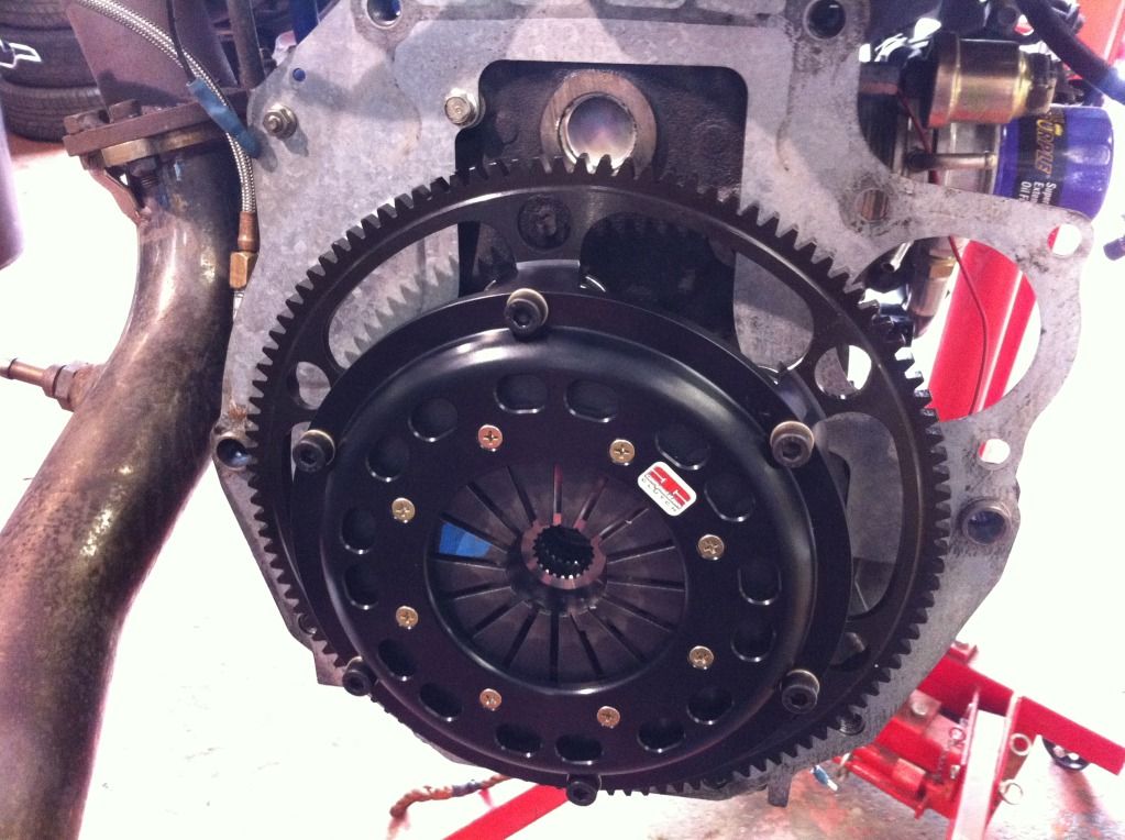

During a race at Knockhill I stupidly hung on to the clutch a bit too much on the uphill start and it ended up slipping in the later parts of both races. We decided on a twin plate 3 puck clutch and a super light flywheel from 949 racing. It is rated to 600ft-lb so should be future proof. Operation is not bad considering but it really does rev like a motorbike! We had also been having a few temperature problems so some vents were added to the bonnet.

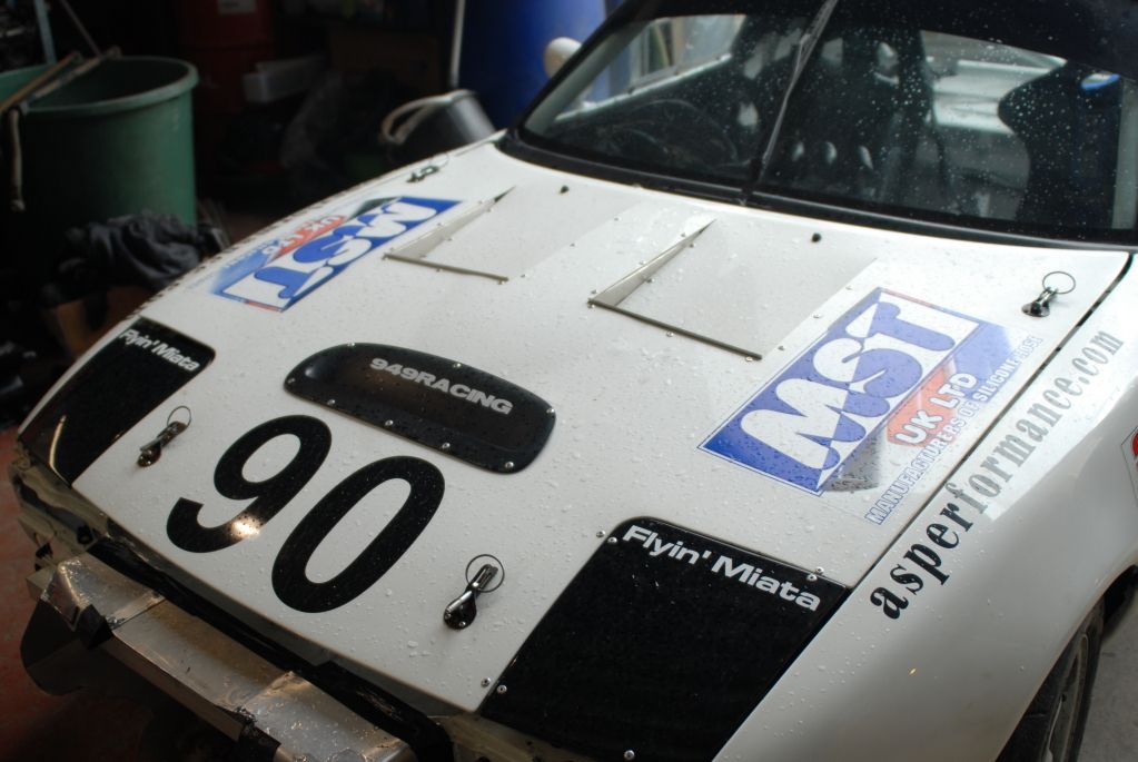

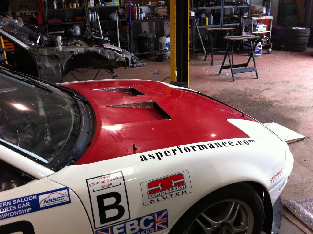

mock-up bonnet
Posted Image
the finished vents

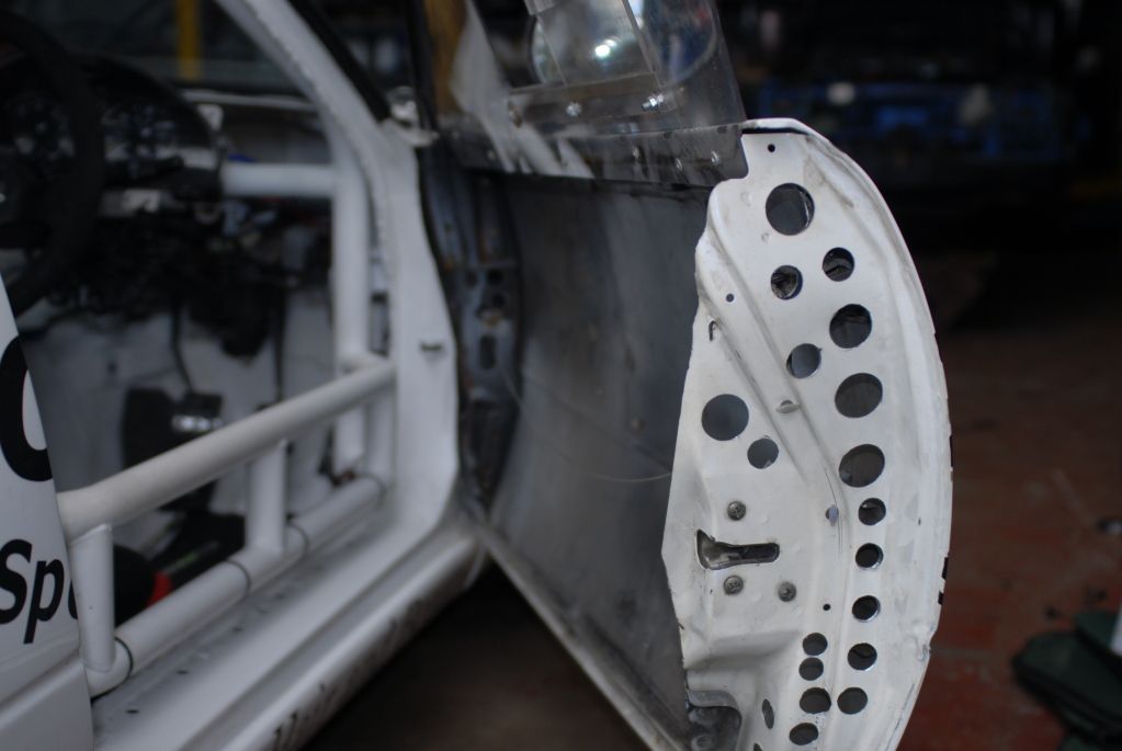

We have been busy over the winter months making some substantial changes to to the car. Some more effort has been made to lose weight, from the car and also myself! :rolleyes: The front cross member has been totally removed and replaced with aluminium and i have been let loose with a hole saw and step drill! :wallbash: this and a good few other bits of weight loss has given us a pretty impressive wet weight of just under 900kg!

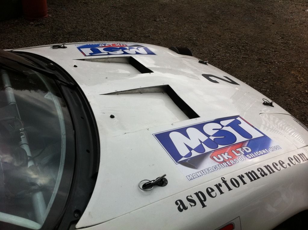

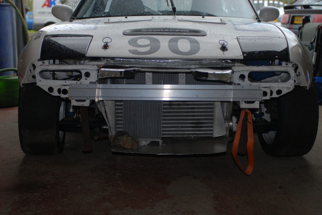

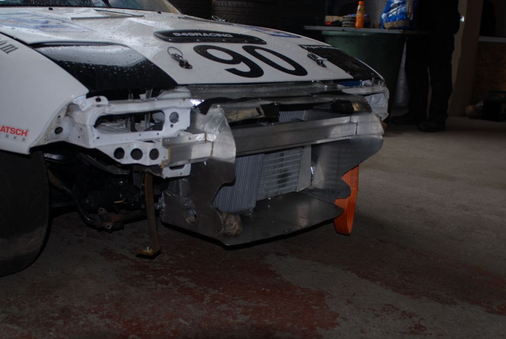

A lot more attention has been given to the cooling with yet another bonnet vent and more radiator ducting which is contoured to fit into the front bumper. It wasn’t quite finished in the picture but you get the idea. The oil cooler has been replaced with something larger and more up to the job and also the orientation has been changed as it will work more efficiently this way.

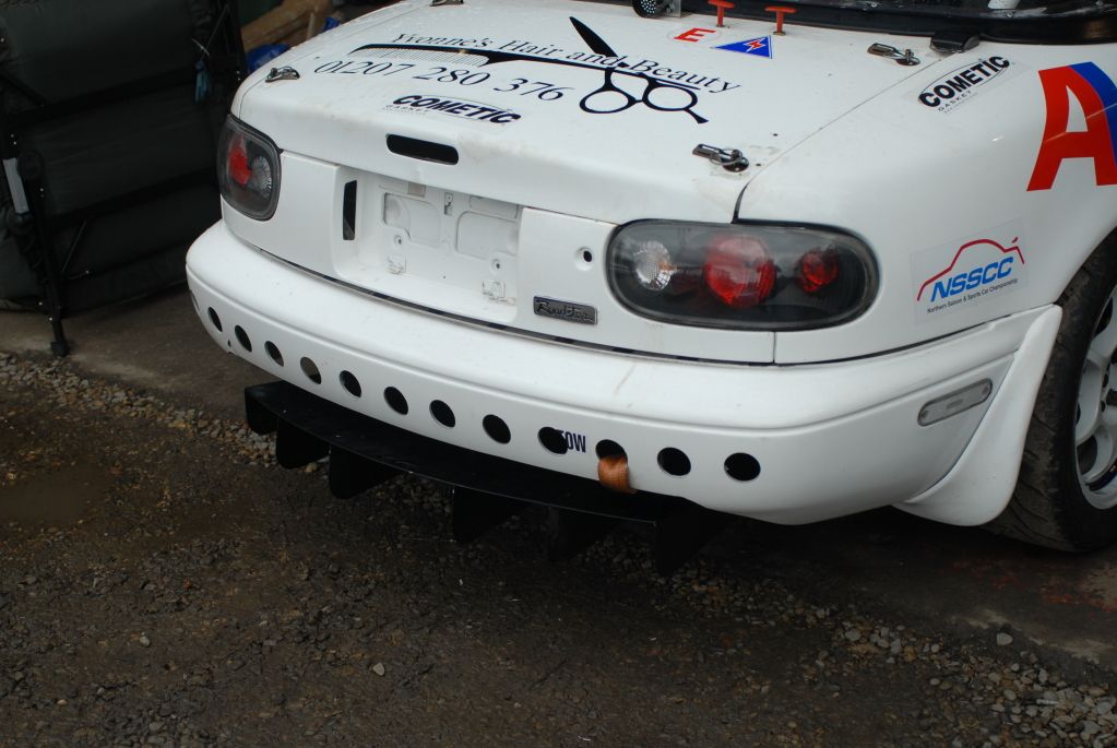

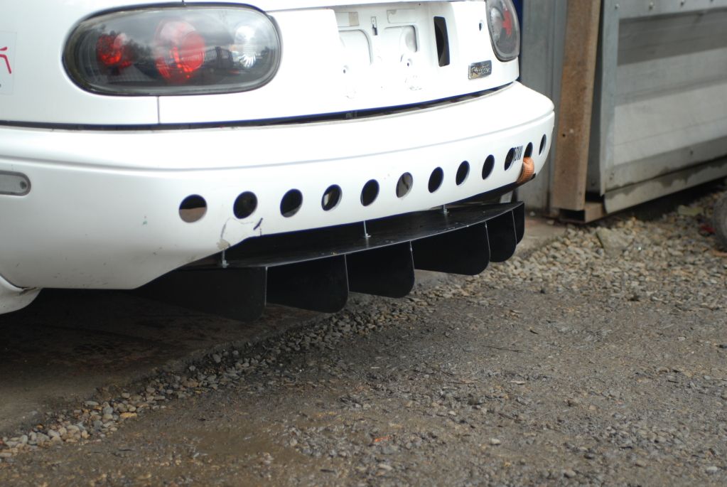

We have also decided to add a rear diffuser and flat floor to try to shift the aero balance rearwards a little. The floor is not currently finished but the diffuser is fitted so you can see how it will look.
Posted Image
Posted Image

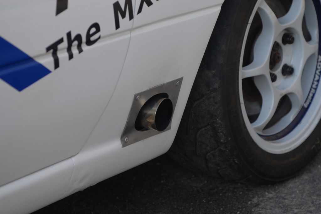

The reason we now have room for the diffuser is the new side exit exhaust. It follows the normal route until just before the rear subframe where it turns and exits just in front of the rear left wheel. not only does it save weight over our old system but it frees up room at the rear and looks super cool lol
Posted Image
Posted Image
Posted Image

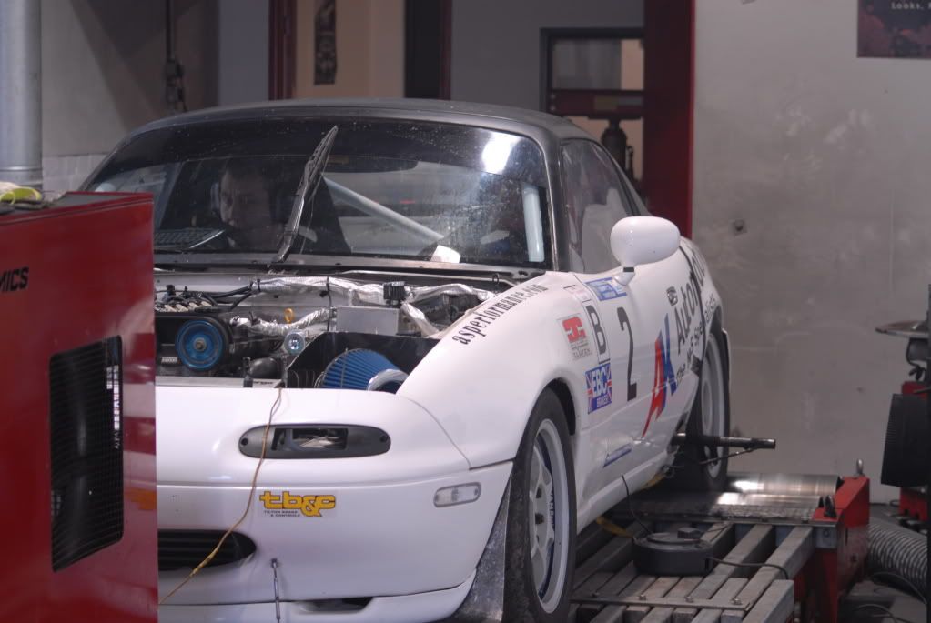

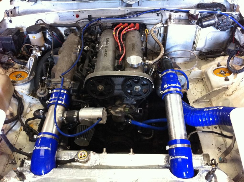

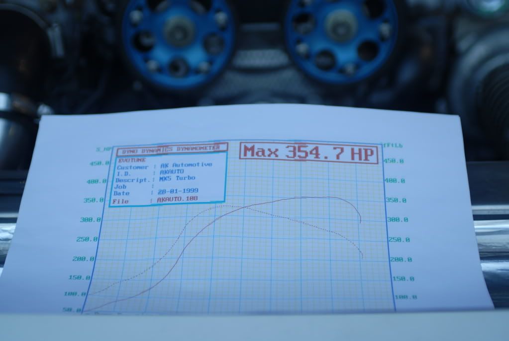

The biggest change we made was the engine. The old 1.6 has been replaced by a fully forged 1.8 and a different turbo setup. We originally bought a car from a forum member for the engine and fitted it but when we went to the dyno the turbo exploded! When i say it exploded it really did explode! The turbine housing went off like a grenade due to a compressor wheel burst causing pieces of turbo to be embedded in the dyno walls! I will try to get some pics up of the carnage! This was the setup pictured below before the “incident"
Posted Image
So…after that we decided to go back to basics and aim for reliability in the form of a ceramic coated Flyin Miata cast manifold drilled and tapped to accept 10mm inconel studs. The turbo we decided on was a Garrett GT2871R with a .64 A/R hotside which we had modified with steel bearing carriers by owen developments who supplied the turbo. When we got the car back to the dyno the numbers were very impressive making over 350bhp at 1.3bar of boost. More power could have been had with a bit more boost and some tweaking of the cam timing and ign timing but we were happy at that and wanted to keep the car as drivable and reliable as possible.
Posted Image
Posted Image
Posted Image
With the car mostly ready for the upcoming season we booked in for a test day and all seemed well. I went out for the first session to give the car a shake down and bed the pads in but still managed to take over a second off my previous fastest lap! The car was absolutely flying! After that session was over i came back in the paddock and noticed a very slight oil pressure problem. I pluged the computer in and checked the data and all seemed reasonably well. There had been no huge dips in pressure although overall pressure had not been great. When i restarted the car though the big oil pressure light did not go out and i immediately shut it down and announced our day was over. Got the car back to the garage, stripped her down and this is what we found

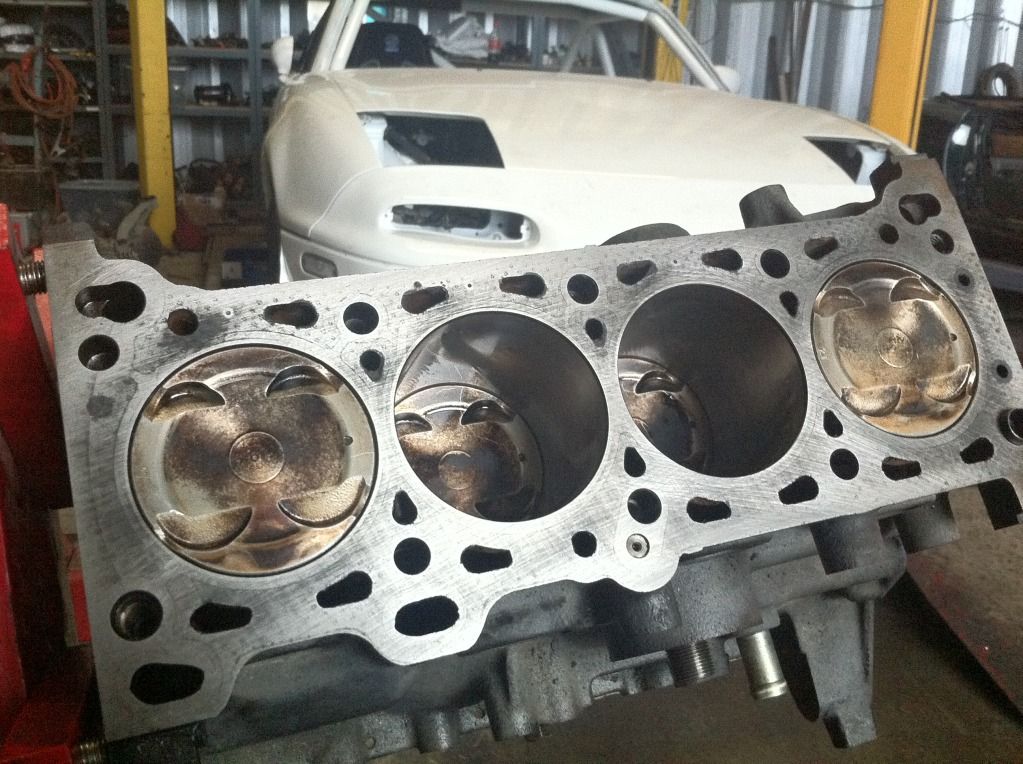

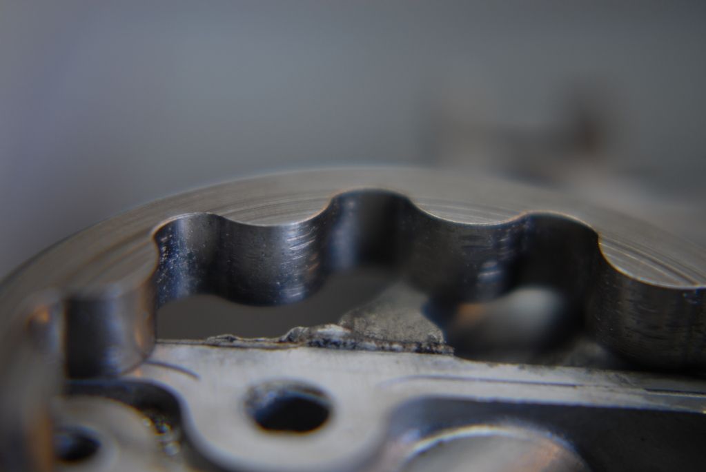

The pressure relief valve had stuck open on the oil pump and the pump gears were badly marked and scored. The rod bearings were pretty good but a couple of the mains had taken a bit of abuse as had parts of the head. Back to the drawing board! to combat this problem in the future we now run billet oil pump gears and an ATI damper to stop the harmonic frequencies in the crank caused by the high revving and loads. Rebuild time!!!
