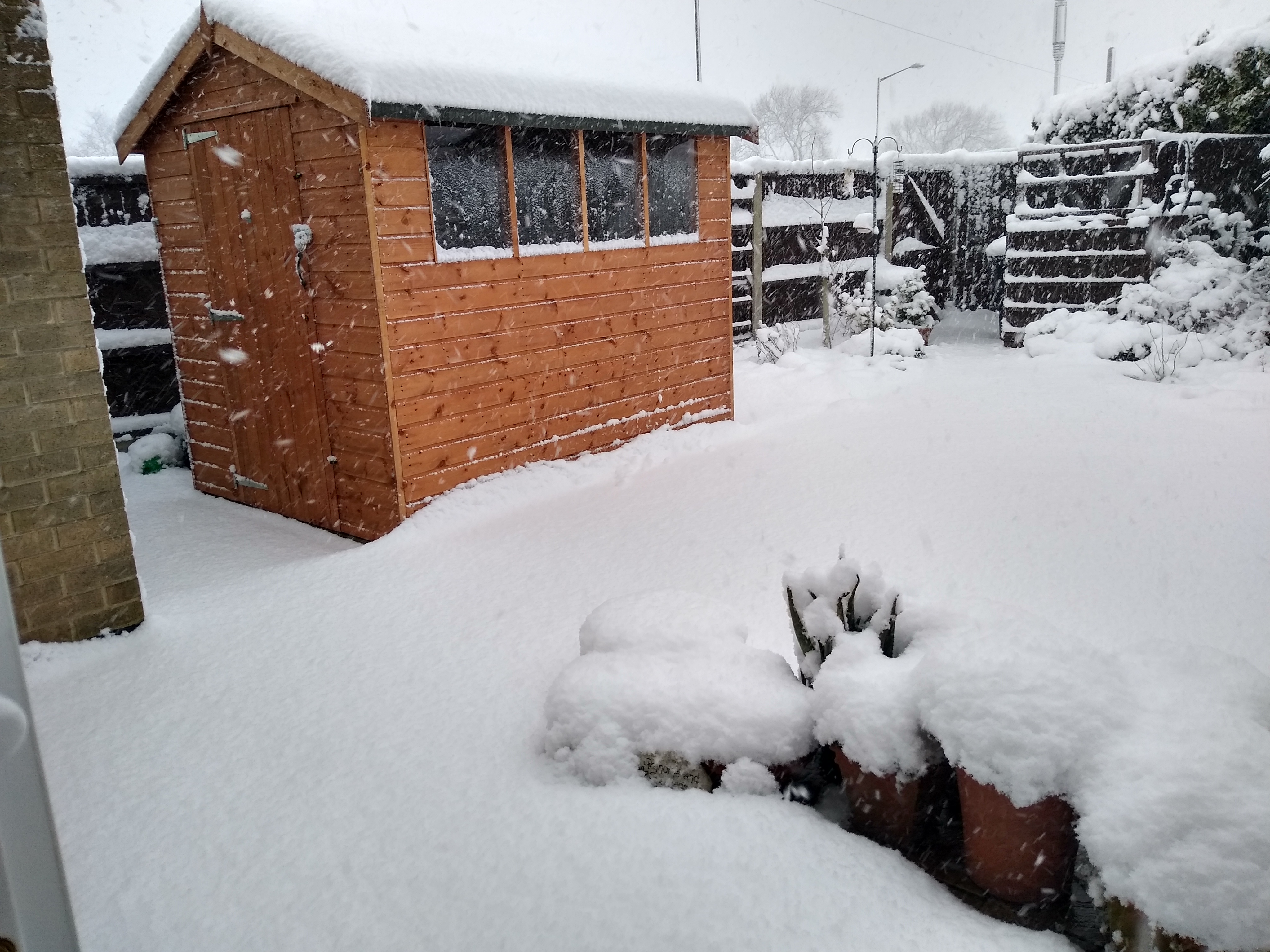

For want of a better title, I’m having problems with my shed alarm.
It’s the one pictured below…
I’m very suspicious that the enabling of a 5g mast about 50 metres away triggers the alarm now, could I be correct?
