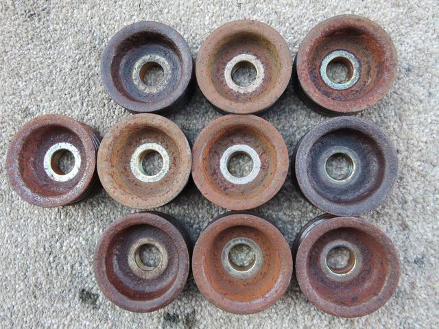

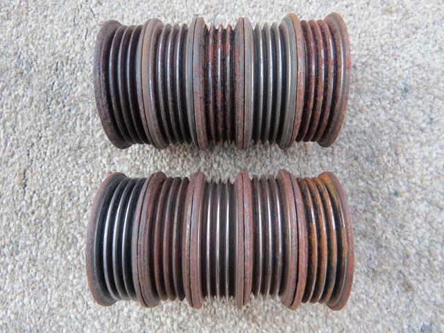

Hi Paul
I have a few of these spare - see attached photos below.
If it suits, take your pic - £5 fee free posted.
