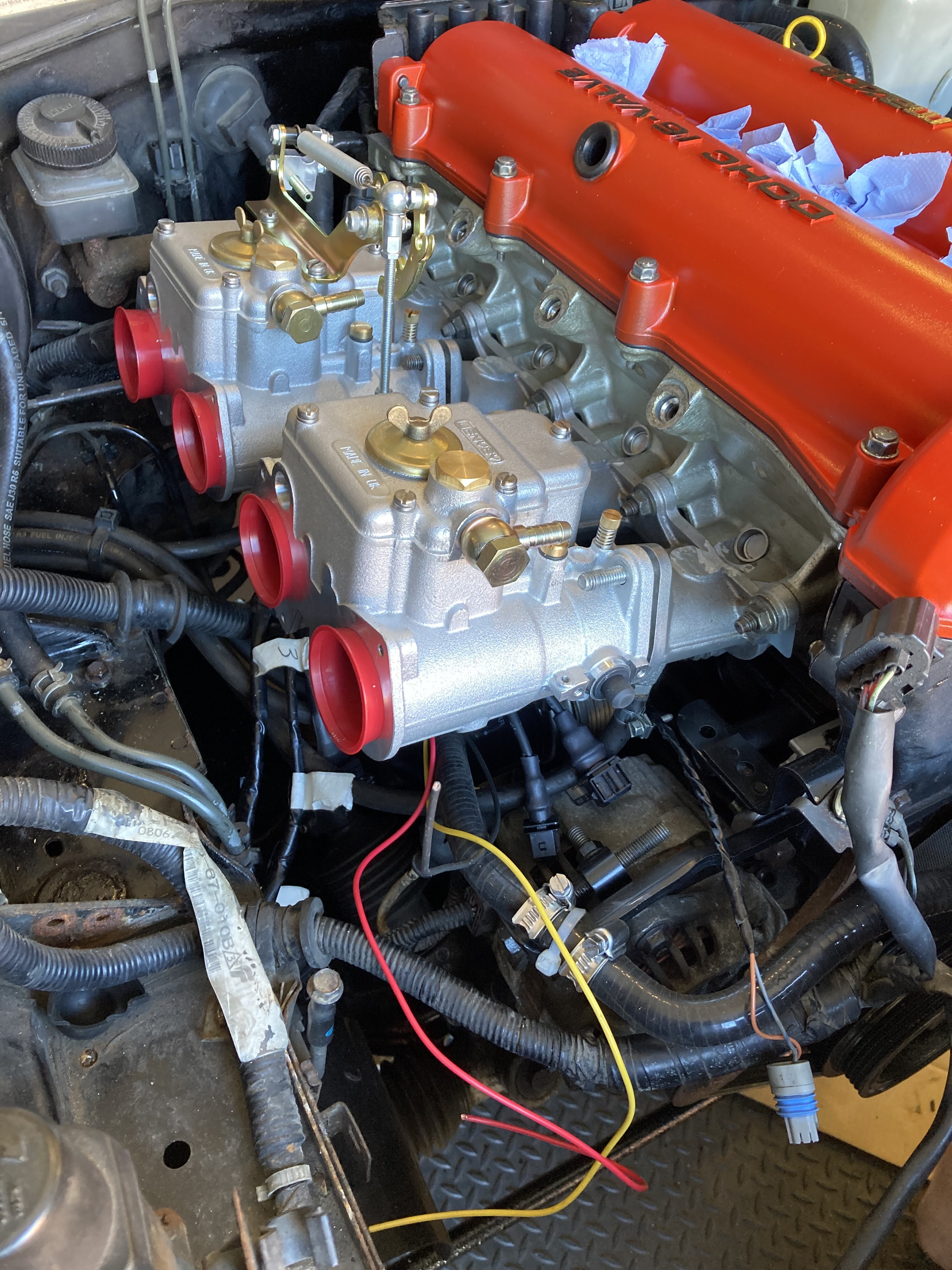

If it helps I have a heritage set of bodies fitted to a jenvey manifold on my mk1 mx5. The linkage is a bit of an issue and I have them looking at a modified linkage to solve it, or a wider spaced manifold, but that was the only issue , others were problems around sourcing and fitting the correct plugs for the injectors.
Mine needs more mapping (being done remotely at the moment) and I have a few little things that I want to change, but it runs drives and passes a mot.

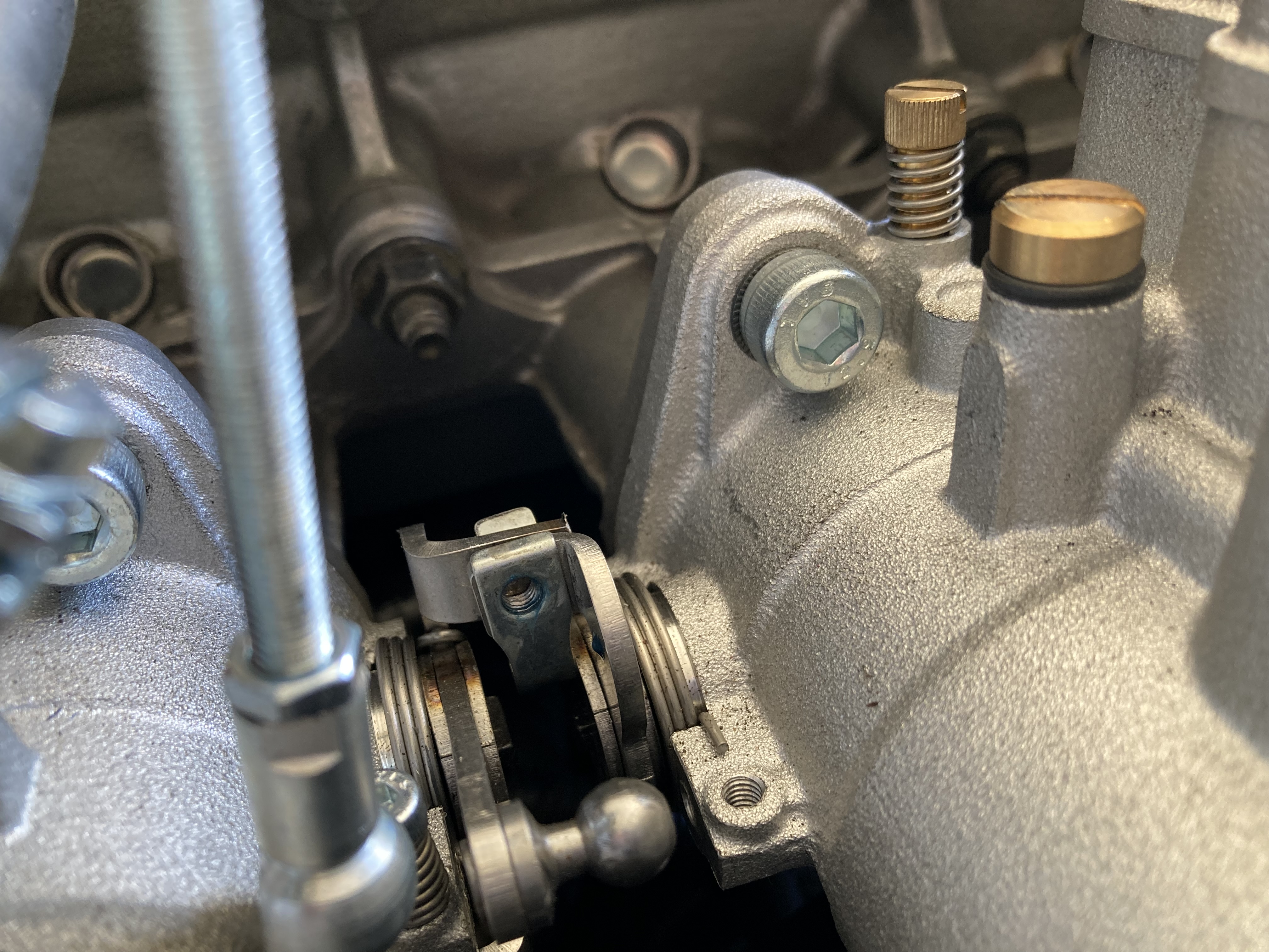

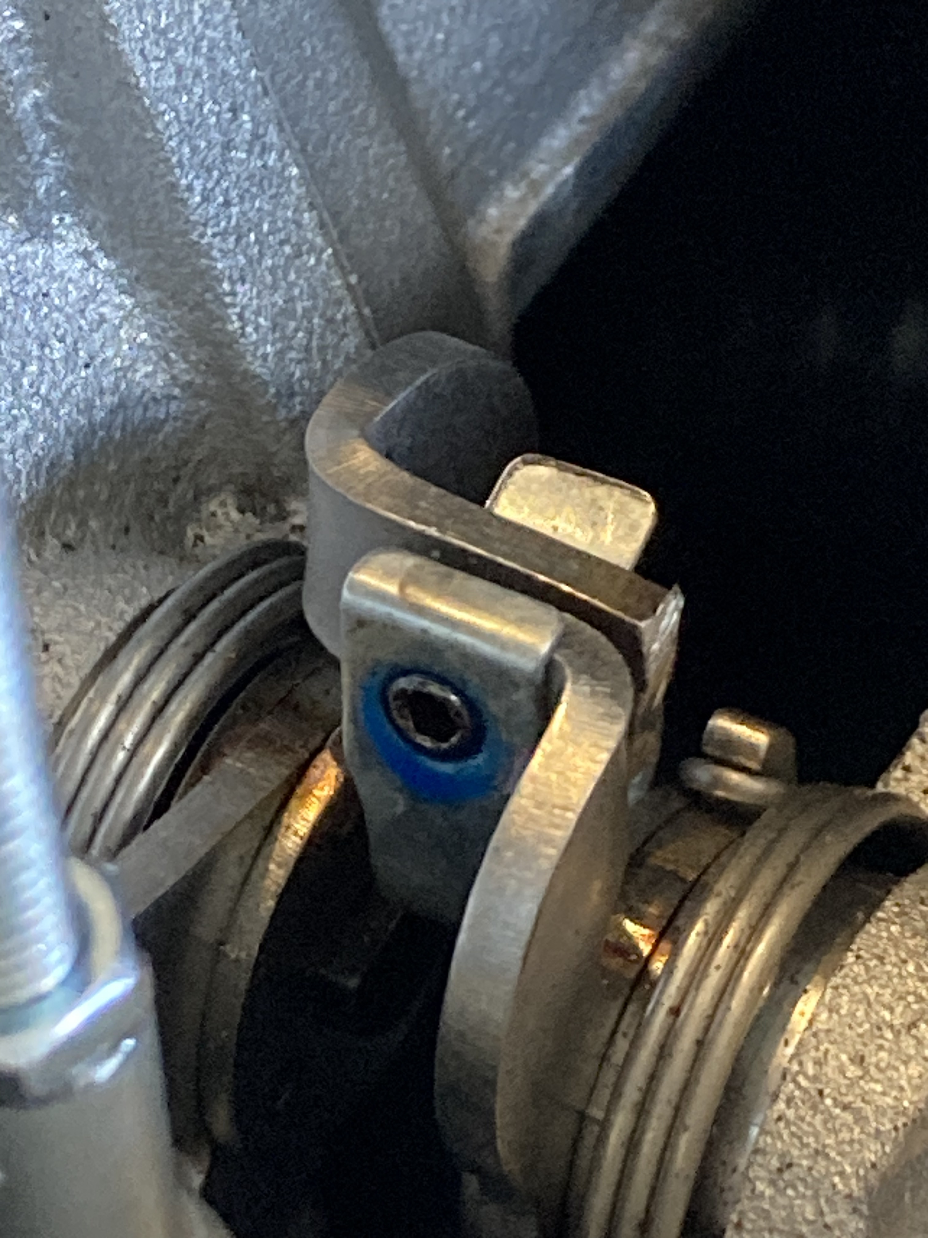

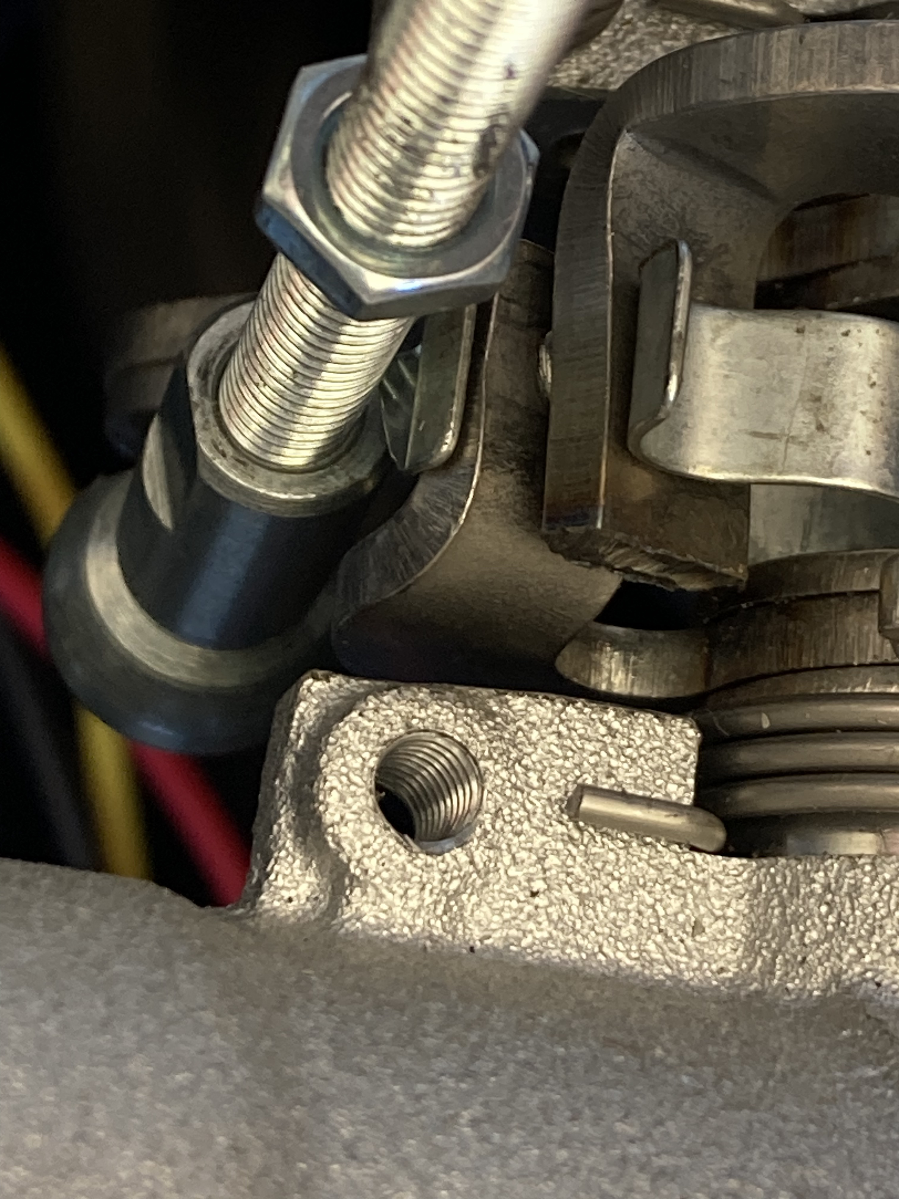

I have loads, the 2nd pic shows the issue with the linkage. At WOT the actuating rod fouls the linkage balancing screw.

No, their standard affair. This is why the two bodies are not far enough apart and the actuating rod fouls the balancing linkage.
They are looking at canting over or offsetting the fulcrum wheel and the actuating rod and using longer leavers, to give the clearance and keep the same peddle feel.
I made it fit by curing down the grub screw and lock tightening it together once balanced……not ideal.
