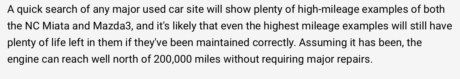

the 2.0 is definitely more reliable than the 1.8
Interested in where you get the evidence for this statement please
The 1.8 is known to have oil ring issues where it starts consuming oil, happens in ford focuses as well as the NC. I know as I rebuilt one and did the research beforehand
Strange, but interesting. Thanks for reply.

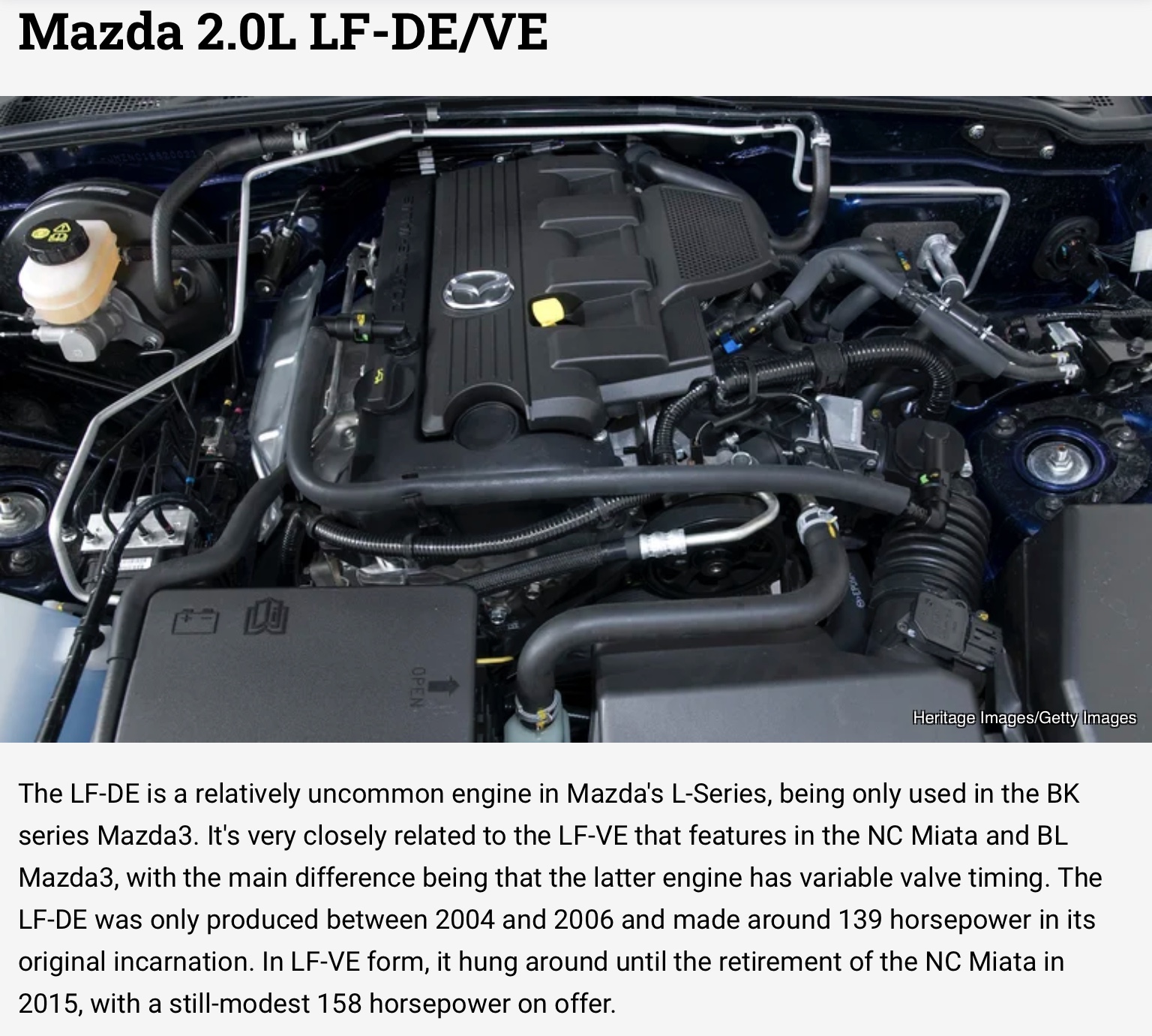

Both (NC) engines share the same block although the 1.8 has smaller bore.
Same stroke on both.
2.0 is of course variable valve timing.
So why is one more reliable than the other?

I’m also led to believe the MZR engines are Mazda designed used by Ford ( at the time they were related) as opposed to Ford engines simply dropped into the NC. Correct me if I’m wrong please.

Within the top 10 most reliable Mazda engines? How many Mazda engines have there been. I assume none of the rotaries made it.
The Duratecs were derived from the MZR, but after Mazda dripped the family, Ford continued to develop. them. All Duratecs were made by Ford. I don’t there is that much interchangeable in them. Plus it was intended as a FF configuration engine, not FR. The FR application is unique to the MX5, I suppose necessitating a new sump baffle design. I’ve heard of oil surge issues…
