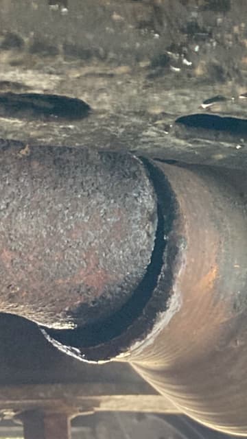

Hi folks, I took the car to work this morning and half way there things suddenly got louder. Once the snow had stopped I went underneath and found the exhaust had parted company with the centre box.

Mx5parts do a repair section (below) it seems to be a common place for them to give way.
Probably sort that out for you until you decide what to go with. Sometimes the flange nuts/bolts to the joint on the back boxes can get rusted up, can take some freeing up.
Thanks for the replies. I can get the centre piece in mild steel from work for £55 (it pays to work for a motor factor at times) so I will probably do that to get the car back on the road and then switch to stainless at a later date.
