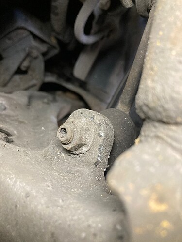

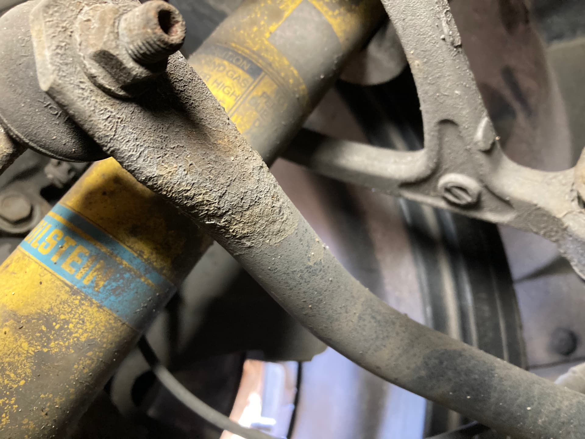

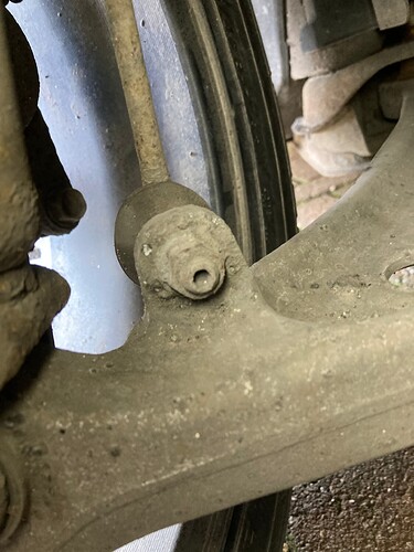

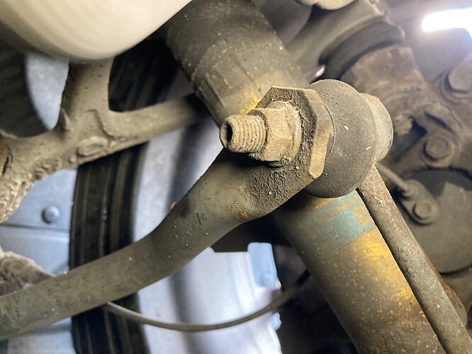

Hi, I have had a local garage look over my recent purchase. One of the things they have identified is the the Anti Roll Bar Link ‘locking tab’ is missing on the near side. Before I go back to them, can anyone advise what this is?
I have been under the car and inspected the roll bar and everything is the same on both sides. I though it maybe some sort of split pin but I can’t find anything. Based on my previous experience and what I can find through our friend google everything is there that should be.
Help appreciated even if it is to confirm there is no such thing.
Thanks
The nuts on the drop link should be Nyloc Nuts
Strange then that the original nuts on my NC were serrated flanged nuts. I know because I had to drill two of them out as the hex in the end of the drop links were rusted out. Certainly the replacements from Blueprint came with nylon nuts.
They don’t mean that one of the tabs which attach the end link to the suspension arm is missing? If the links have been replaced it’s possible that one of these tabs has been damaged and removed. In which case a new part will need to be fabricated and welded on. Pic would be useful.
First time with pics. The first 2 are drivers side, the last 2 are passenger side.
Anyone see anything different to their car?

Those pics look normal. They correspond to the drawings in the service sheets as well - no locking tabs shown or mentioned for the drop links.

I would go back and ask what they mean. If it’s genuine then they won’t have a problem you asking for clarification.
Agree with the other comments, this is exactly how they come from the factory, less the dirt and corrosion of course. I would find another garage. If you want to be helpful and give them half a chance spray all the fixings with releasing fluid (please not wd40) for a few days before you take it in.
