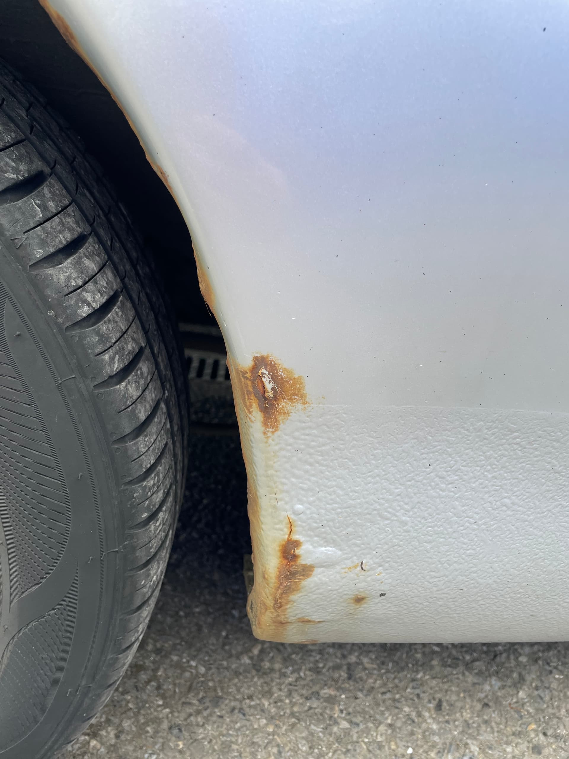

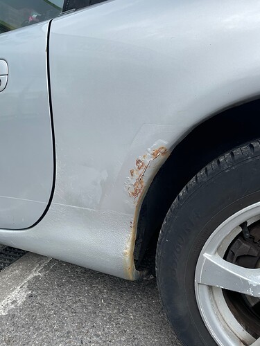

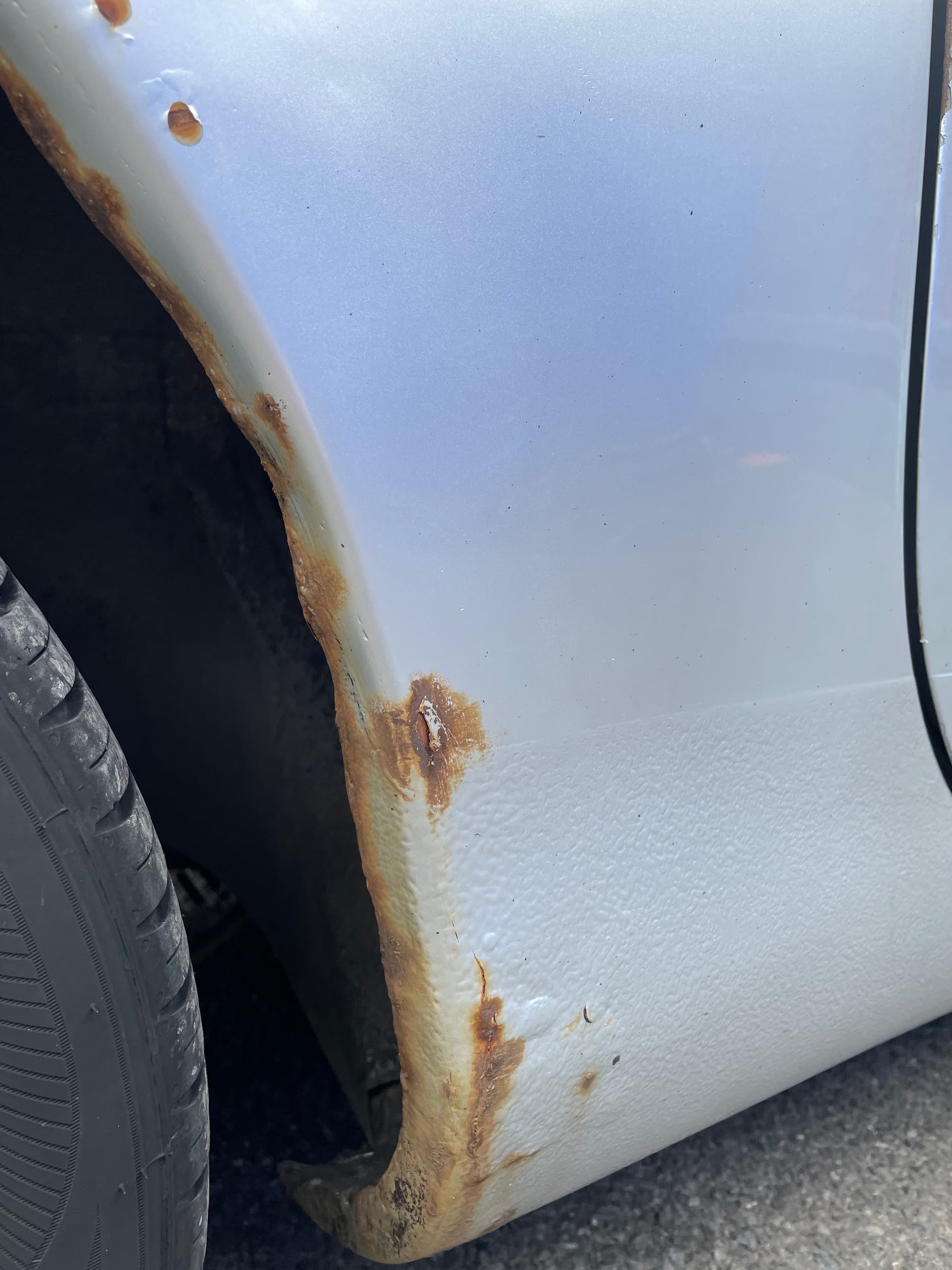

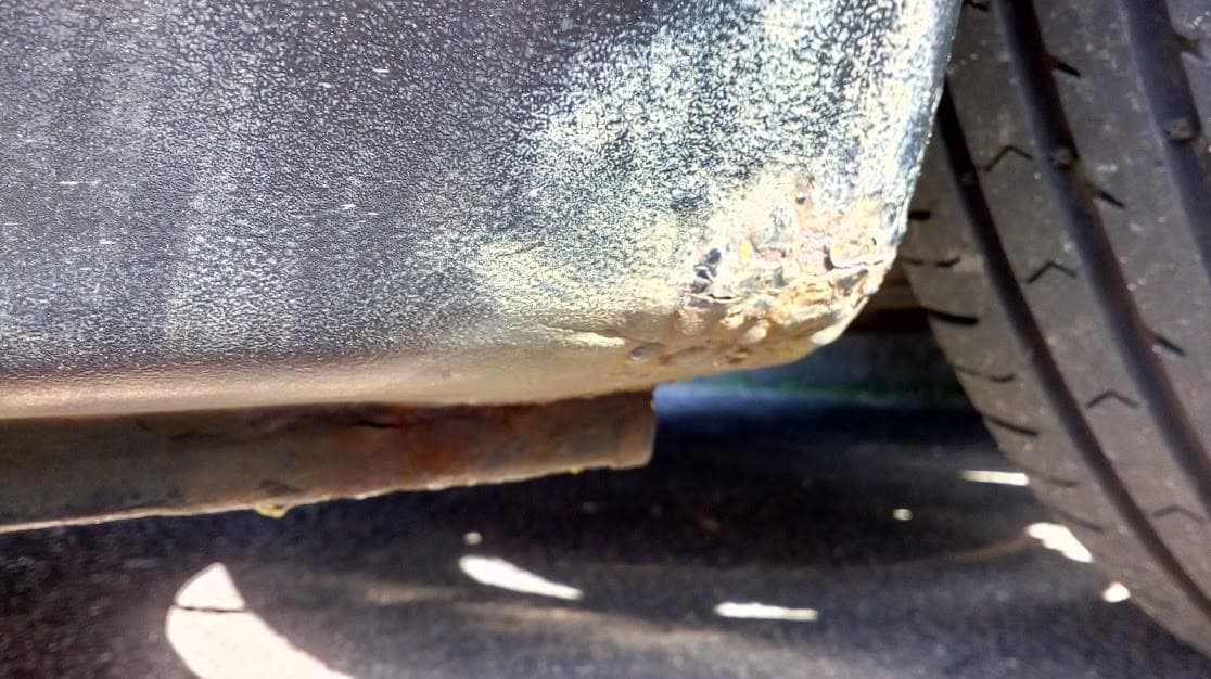

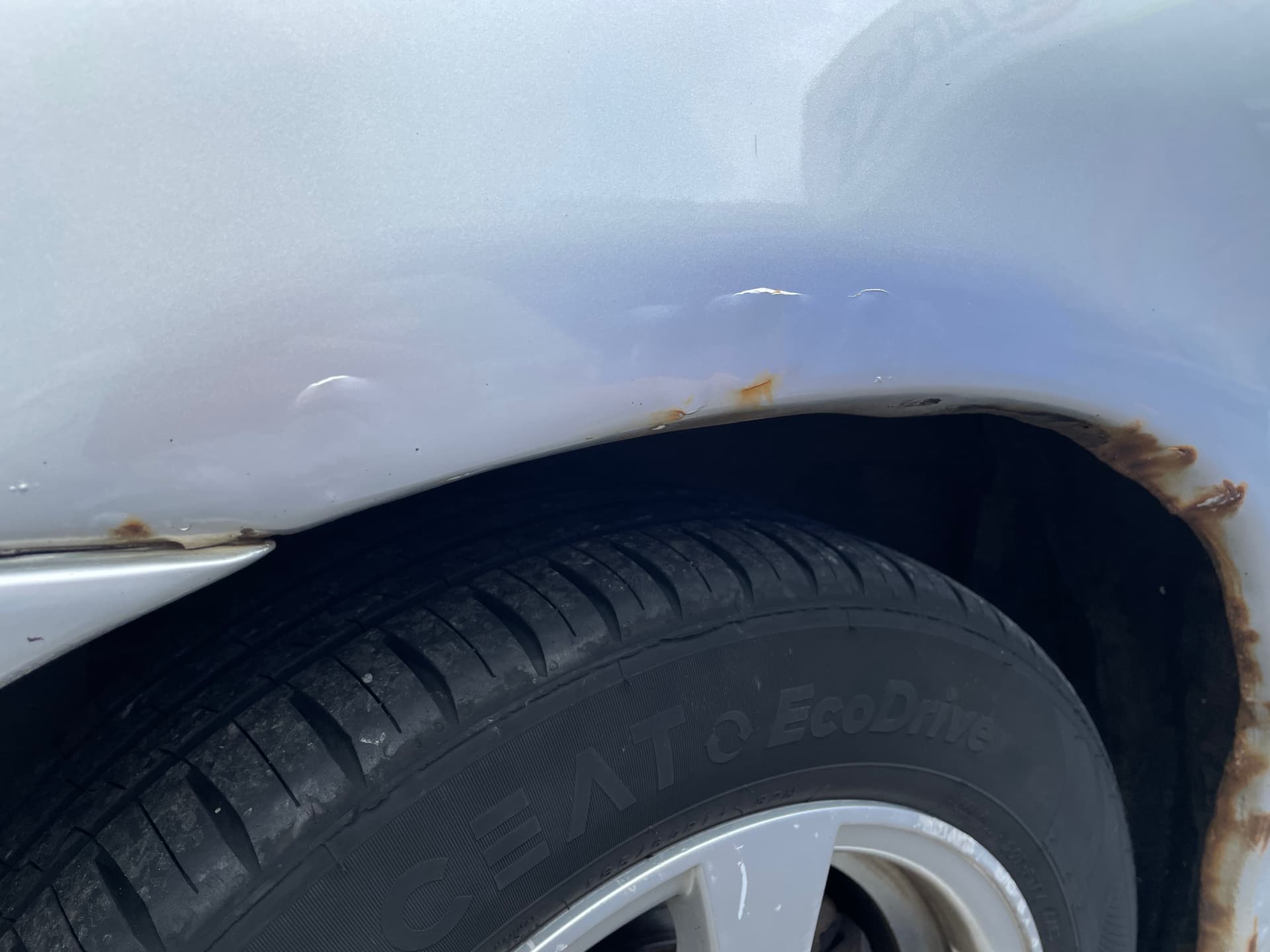

Well lads, only had the car 9 months and the arches (and the sills under i imagine) are in a sorry state already to say the least. Looks like the last owner just cobbled a bit of filler together to pass it’s last test. I’ll throw some photos of it for an idea of the extent
I know it’s probably worse under, and since i only paid 3000€ (~2500£. That’s a lot for one compared to you guys in the UK i think, but there just doesn’t seem to be many for sale over here. Every other 5 was in the same/worse nick for 2000 more) i don’t mind atleast trying to pay the value (at least) or more to have a solid shell to keep. But I’m also not opposed to tarping it and getting something cheap to get me round for a year or two. I just want it done once and done right.

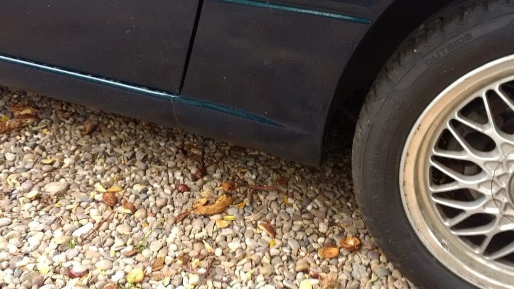

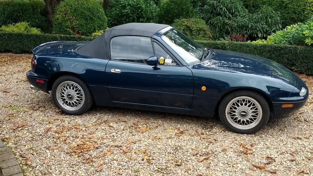

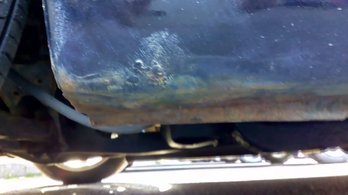

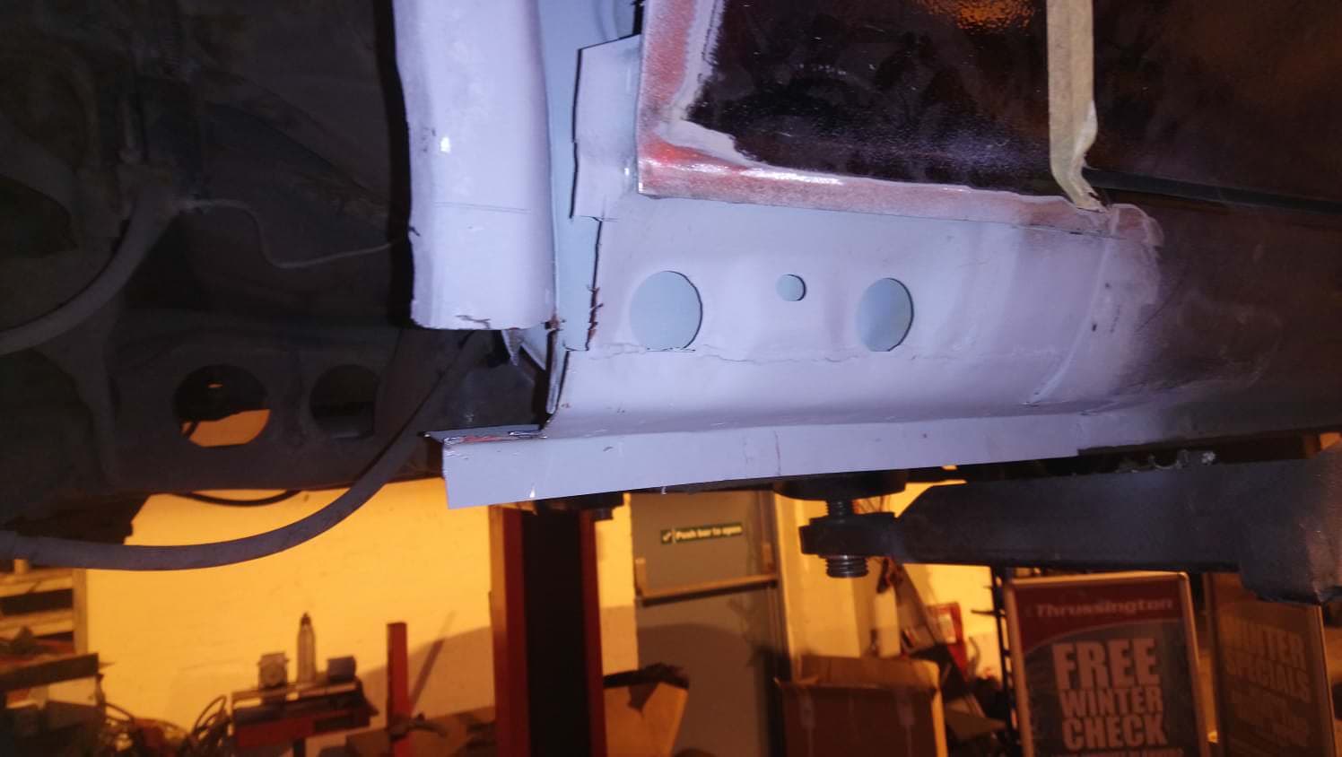

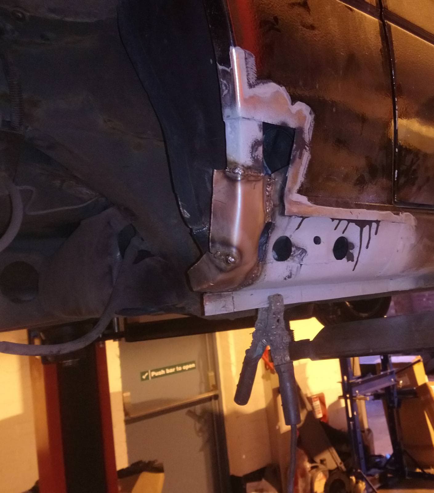

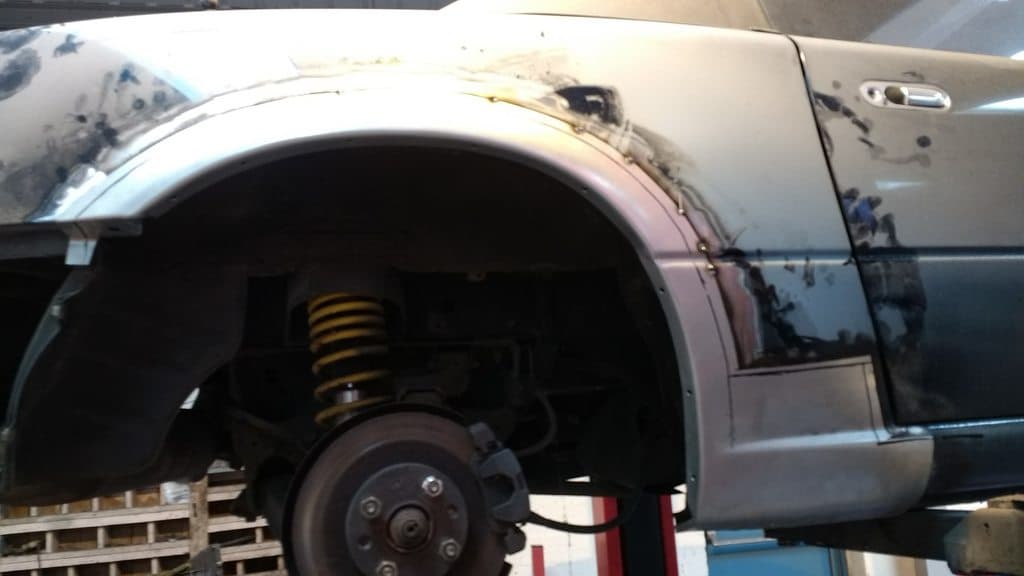

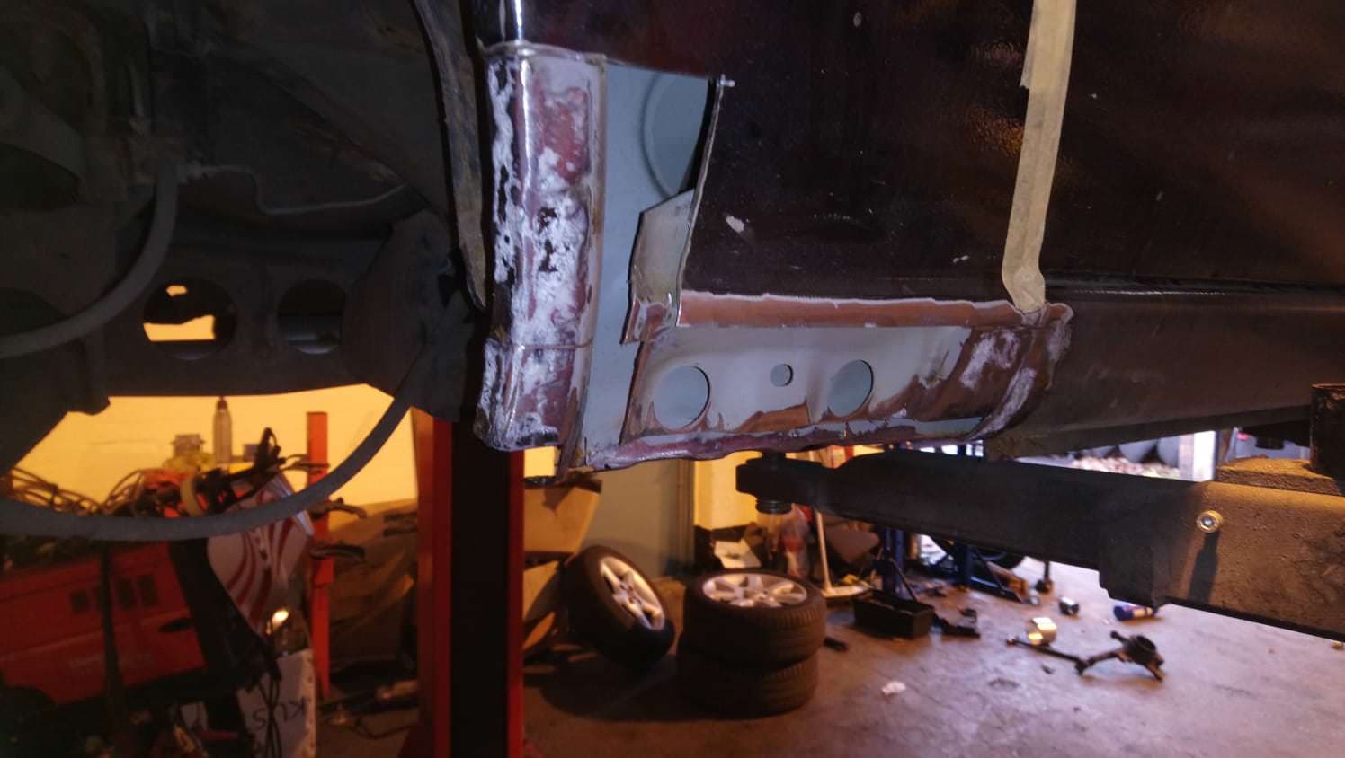

In GB, there are several places who can do a good job; most of them will do the welding and basic bodywork, and then farm out the paintwork. I had 2 sills, arches done, with a repainted rear bumper, for £1700 but that was a few years ago, and the work took 3 months (or 3 months to get the car back, largely due to the paintshop). I’ve had a couple of NAs done by Thrussington Grarage in Leicestershire. MX5restorer wanted £900 a side, and I don’t think the work would have been any better.
I would suggest you carefully inspect the condition of the front chassis rails, particularly around the front anti-roll bar mounting points, and the subframe mounting points. If they are shot, add at least another £500, and most garages will recommend both sides are attended to.

Lovely photos, that is a beautiful job and colour I have to say.
