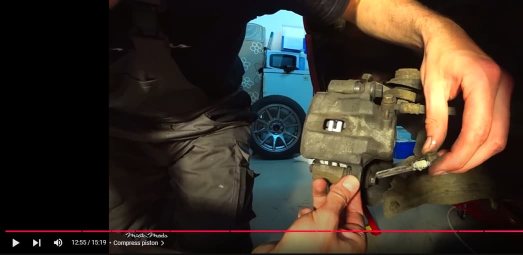

in this video from Miata Mods:
MX5 NA Miata - How to replace front brake rotors and pads (youtube.com)

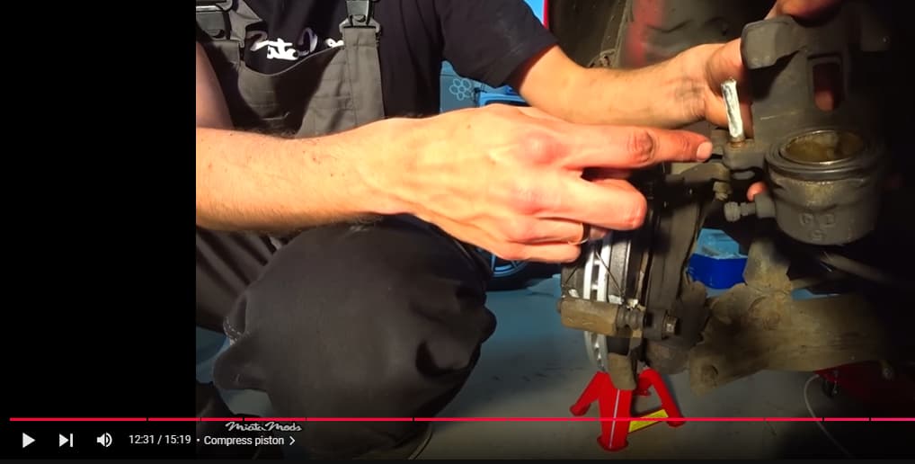

he adds some to slider pin at the top:
and this bolt which has the rubber thingy on it:
Brembo stuff is quality for what you need it for.
I’ve not gone wrong using bremtech pad goo, if it’s suitable for the temperatures seen on the pad itself it’s gonna be fine on the slider pins. Haven’t had one seize with it yet.

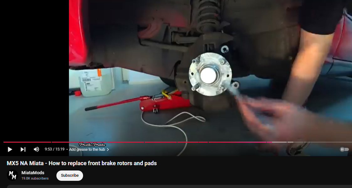

any suggestions for wheel hub grease?
A high temperature lithium grease for the hub. For the caliper pins i use a high temperature silicon grease which doesn’t dry out over time,
i should have added a still from the vid showing Miata Mods putting grease on the hub:
he doesn’t need to remove the hub from the spindle for what he’s doing here, but if you are removing hub from spindle and cleaning up, any grease on inside of hub where it fits onto spindle?
