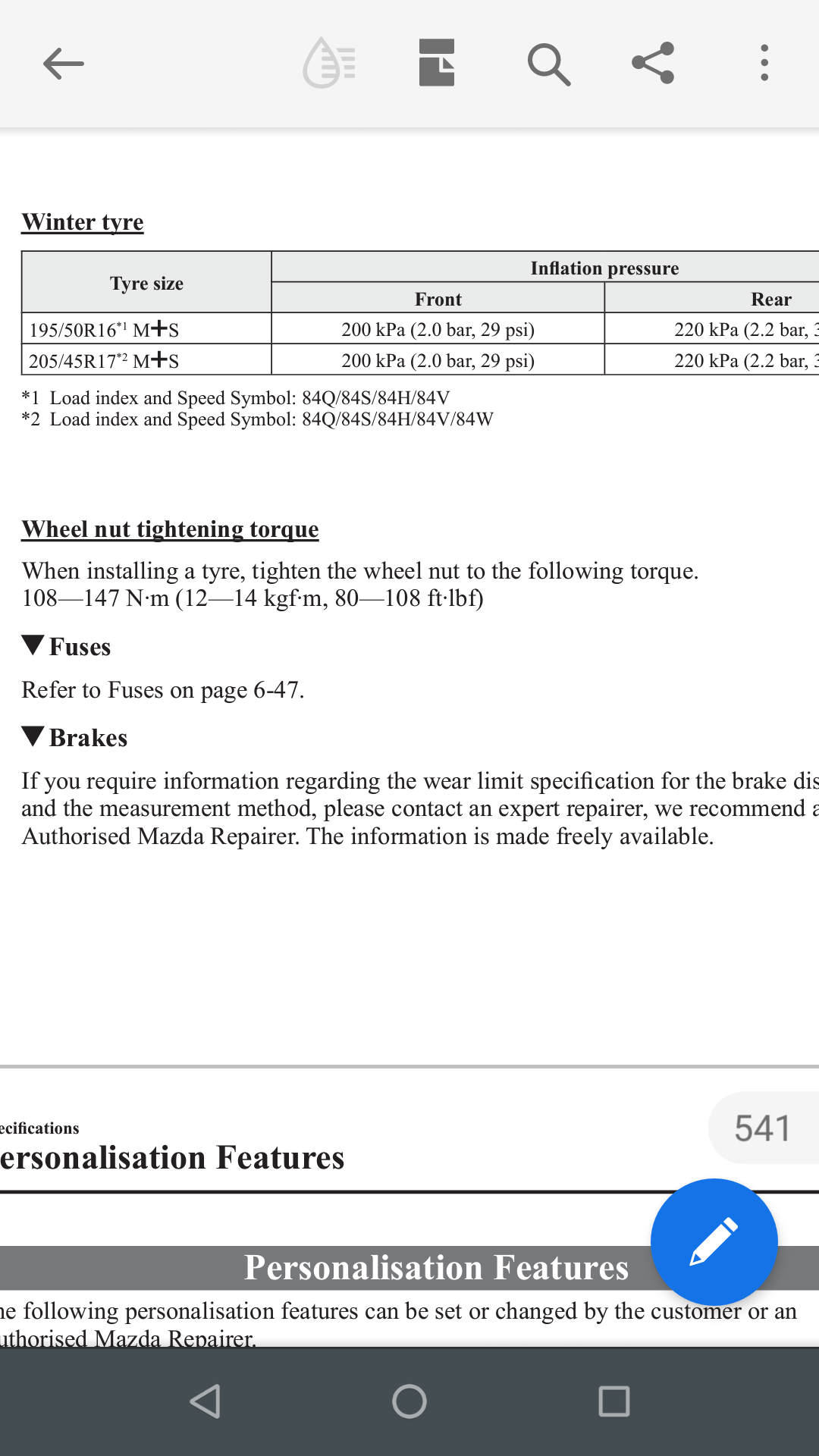

Anyone know what the correct wheelnut torque is for a 2016 MX5 ND?

About 120Nm from memory, should be in your handbook.
108-147nm
80-108 ft/lb
Taken from the owners manual.
See attached page from Owners Manual, confirming above replies from Ian H and Sunzoffski
