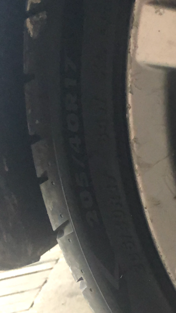

Hi. Has anyone had any experience of running these tyres? I bought my MX5 in late summer last year and it was parked up in the garage during the winter so I haven’t done many miles in it. I drove it to Bath last weekend and it was horrible. It feels extremely nervous and wanders all over the place and when driving in a straight line on the motorway I was having to constantly correct the steering. It felt like it was imminently about to veer off the road at anything over 50. I wondered if it was down to this non-standard wheel / tyre combination which were fitted when I bought the car. The tyres are all good and the two rear tyres brand new. Should I go back to the standard wheels or is there something else in play here? I have booked it in to have the tracking checked next week.

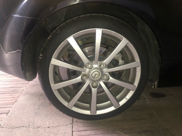

Hi. I have stuck to the standard 29 psi in the absence of any other information. No idea what the offset is. I have included a picture for an indication. They don’t look wrong. The original wheels didn’t come with the car I would have to buy new or second hand.

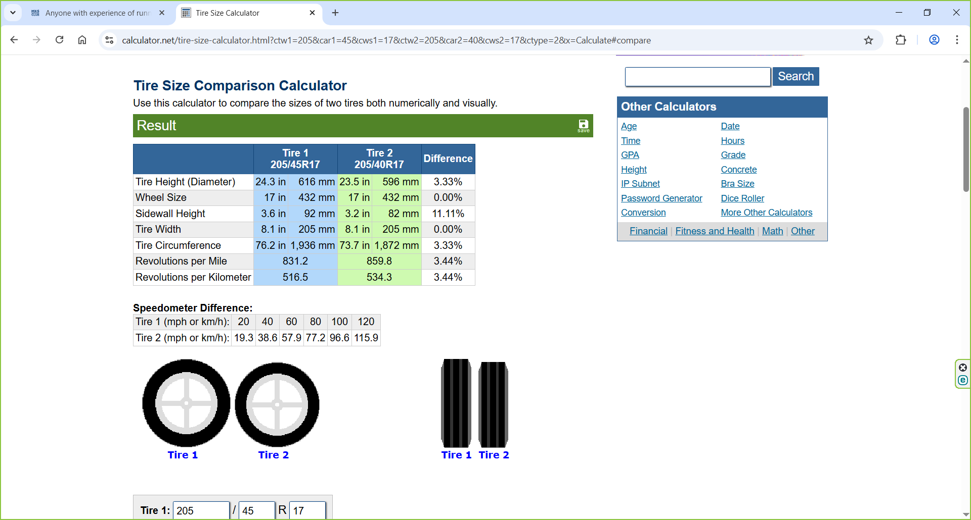

Given that I have just bought two new tyres, will the 205/45 make a big difference? Will my speedo be over reading significantly?
Your picture looks like std 17" MX5 wheels so there should be no offset or fitment issues.
205/40R17 vs 205/45R17
Your car will now be going SLOWER for each indicated speed compared to the 45 profile.

The wheel in your picture is the Mazda 17 inch wheel fitted to the Mk3 2L Sport so is not non-standard.
However it seems to be “kerbed” quite a bit.
Have you removed the wheels and checked for more serious wheel damage such as bent or damaged rims?
But definitely get an alignment check as well

Hi Mr H. You are quite correct. I’ve just consulted the sticker on the inside of the door and the only tyre size it shows is 205/45R17. ■■■■■■! I was side swiped by the fact it had 205/40R17 fitted all round when I bought it. I’ve only just bought two more! Well, I’ll have to get at least a bit of wear out of them before I replace them again.
