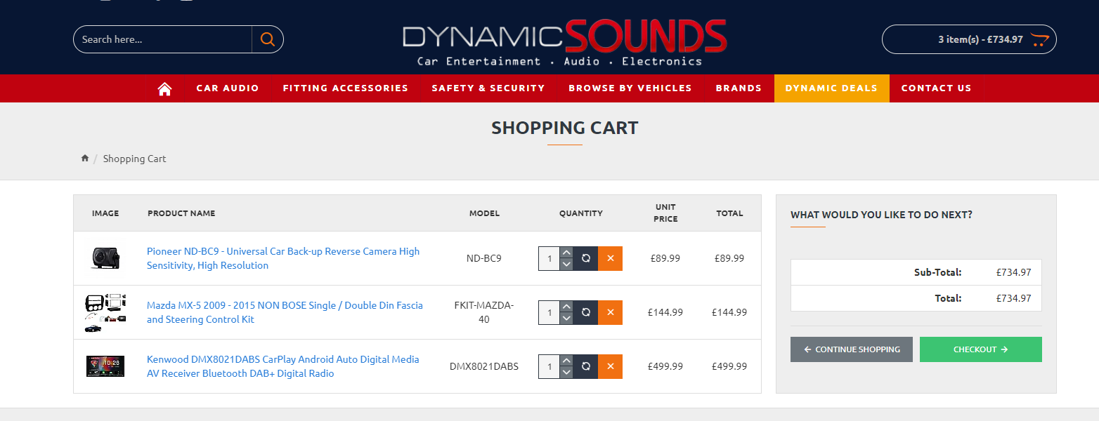

Anyone see any issues with the below? He said to go for the NON BOSE kit as I have the Alpine head unit currently - assuming that’s correct. Other than this I guess I’ll just have to source the aerial elsewhere, any recommendations?

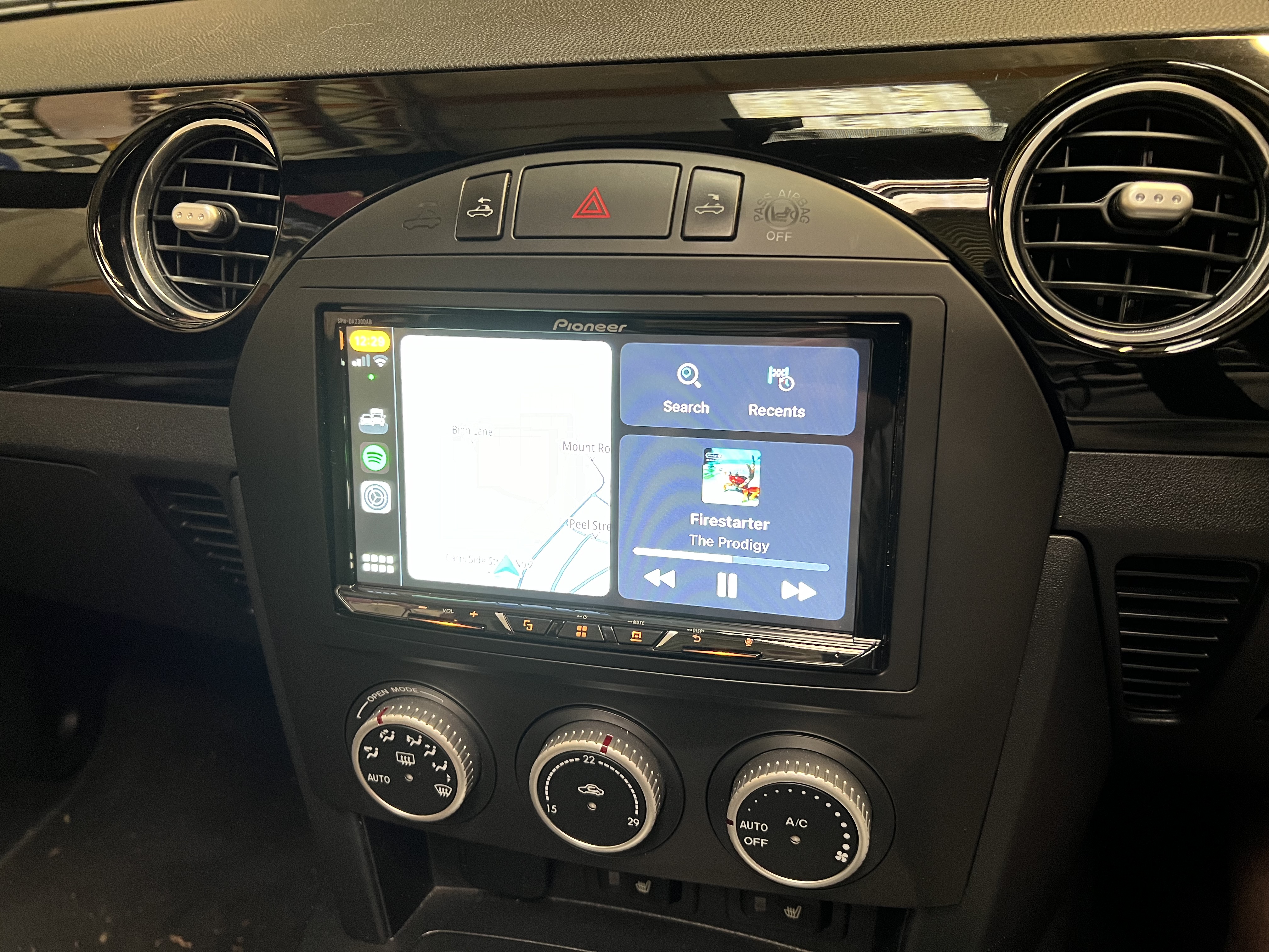

7” pioneer fitted ok

Am i doing the right thing buying the facsia kit I showed in the pic above or have I cocked that up too?
I was just looking at that for you.
It initially does look right.
Getting late now so will compare for you tomorrow just to double check.
You haven’t cocked anything up at all yet as looks like the shop advice wasn’t great. :+1:

I ended up filing the bezel so that the head unit sits as far forwards as possible.
The pic is a 7" unit.

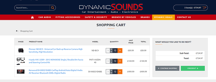

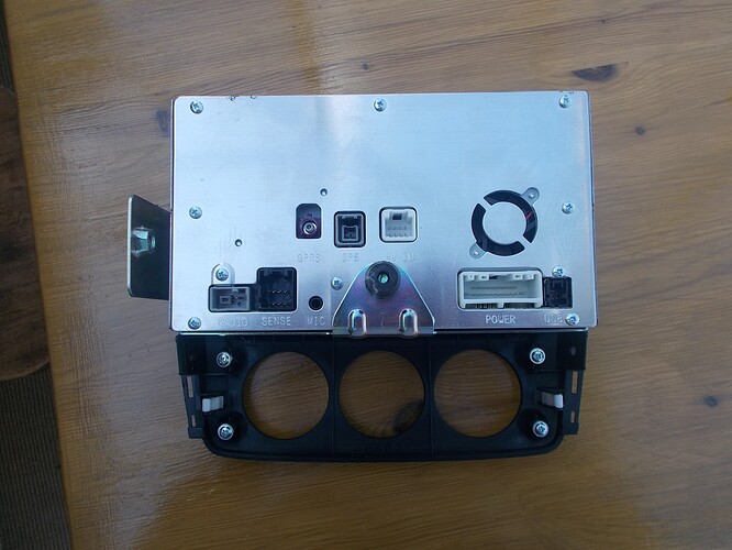

That kit to me contains the facia - CONNECTS 2 FACIA CT24MZ20. (States Matt in the description).
The wiring loom - CONNECTS 2 WIRING LOOM- CTSMZ002.2.
The “Generic” Patch lead.
You want the Kenwood DMX8021DABS.
The Kenwood CMOS 230 Rear Camera.
The DAB/FM antenna as the link from Lakkabay.
Again, DOUBLE CHECK all this is correct.
At the time of my install (as my post above) I bought the items separate as it kept the costs down.
Likewise, the bundled kit wasn’t available.
I bought the Kenwood patch lead separate too.
THIS MAY NOT BE APPLICABLE TO YOUR CAR.

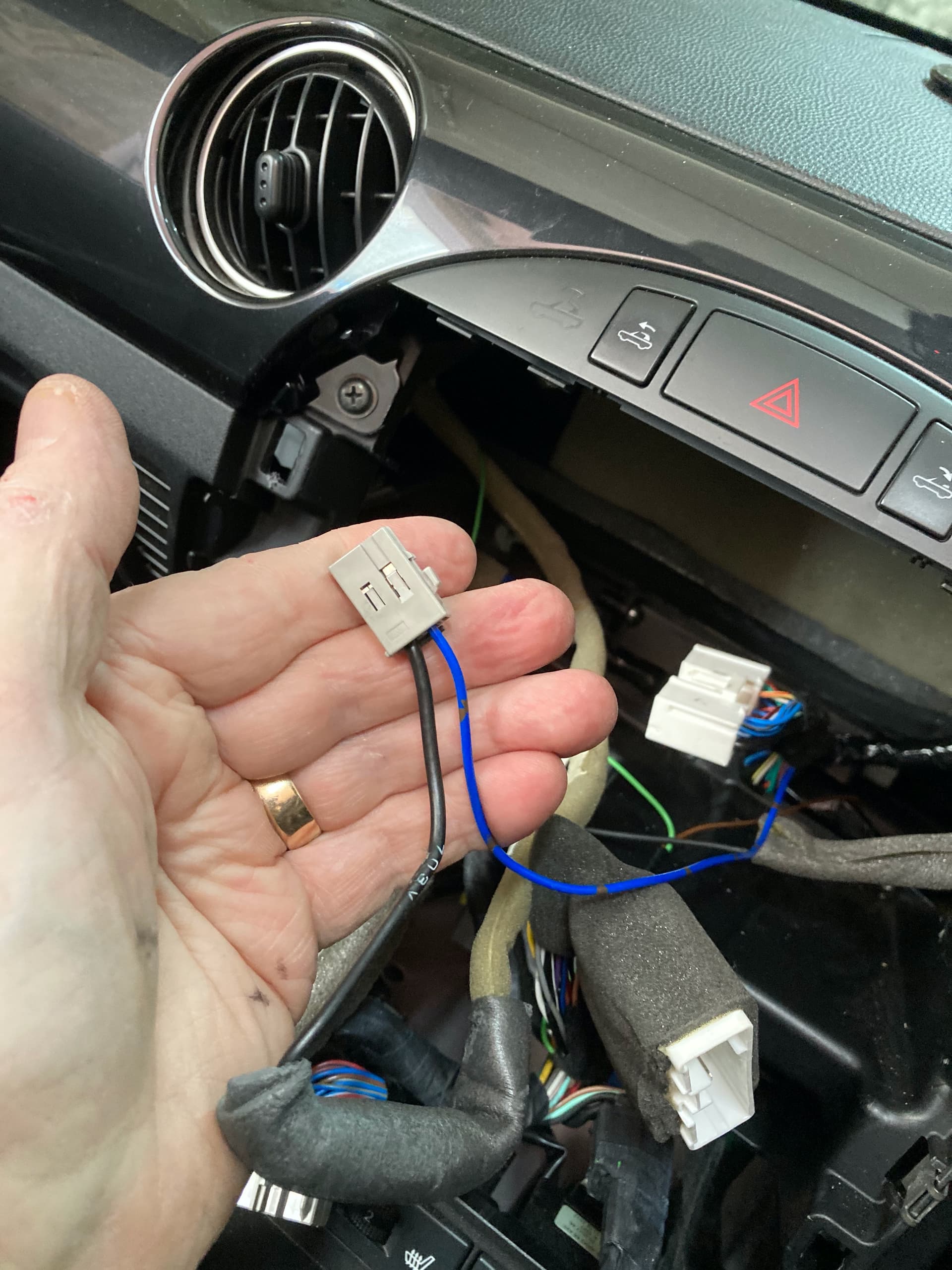

Now because the antenna is powered (signal) and also was fitted with a different plug on the back, I had to buy the CONNECTS 2 ANTENNA ADAPTER- CT27AA36.
This converts it to the standard round antenna plug for the Kenwood…

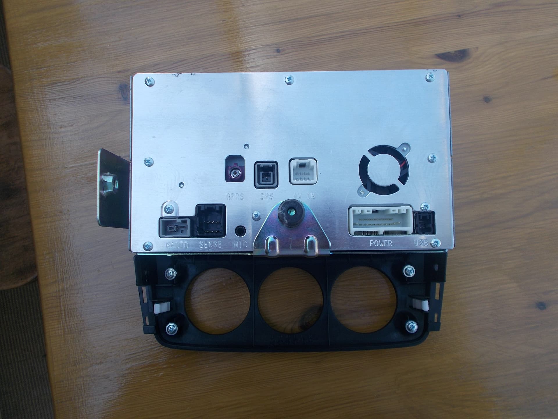

I DON’T know what is on the back of the Alpine unit you have.
Therefore, you may/may not need it.

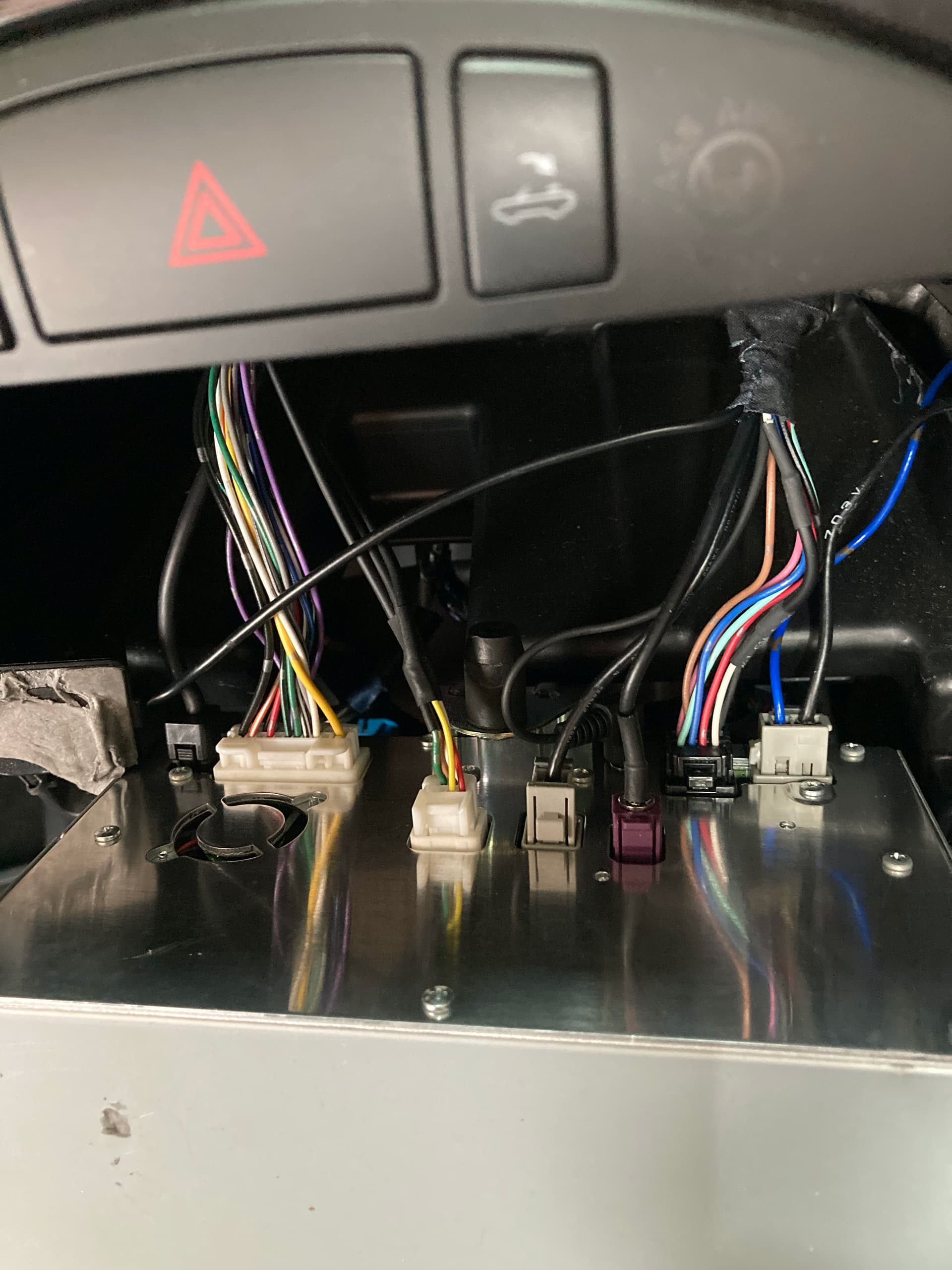

See attached pics.
A matter for you, but I took photo’s at each stage, plugs, etc etc just in case.
I also set up the new unit and made sure it all worked before pushing and securing everything back together.
Take your time and it will all be fine. :crossed_fingers::slightly_smiling_face:
Ah, thought you had! I didn’t even know 7" were available - thought 6.8" was the max. Even with the thinnest bezel in the kit from Dynamic I still had to sit the unit back a smidgen. I did consider a bit of reconstruction work on the bezel but didn’t want to risk breakimng it. Also the facia / bezel from Dynamic seems to have a satin coating on it (like many plastics in a car interior) - I guess so it matches in with the rest of the interior - and I didn’t want to risk this peeling off.
Thanks alot for going through that - and yep I those items you listed are correct. You mention the ‘generic’ patch lead though in the upgrade kit and then that you got the Kenwood patch lead - should I be getting that instead and buying the things in the kit individually.
Thanks for the aerial pointer - I may just get that adaptor as an insurance policy in case I need it - only a tenner
The pack states it will be fine and work.
Whether you buy the kit or source the items separately is a matter for your good self.
It would be wrong of me to spend your money! :wink:
