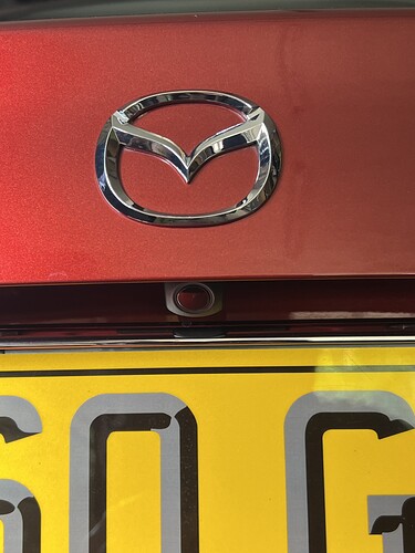

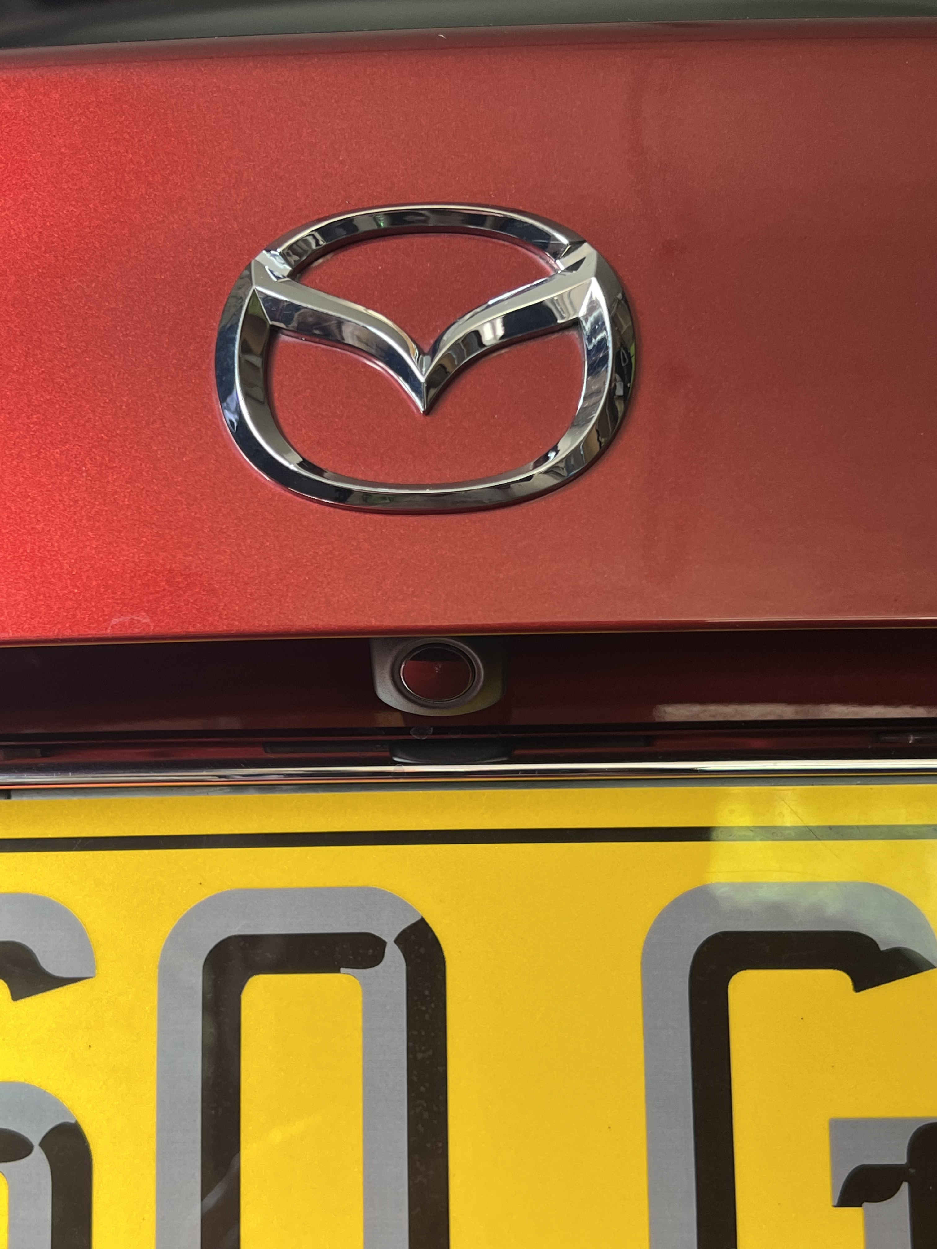

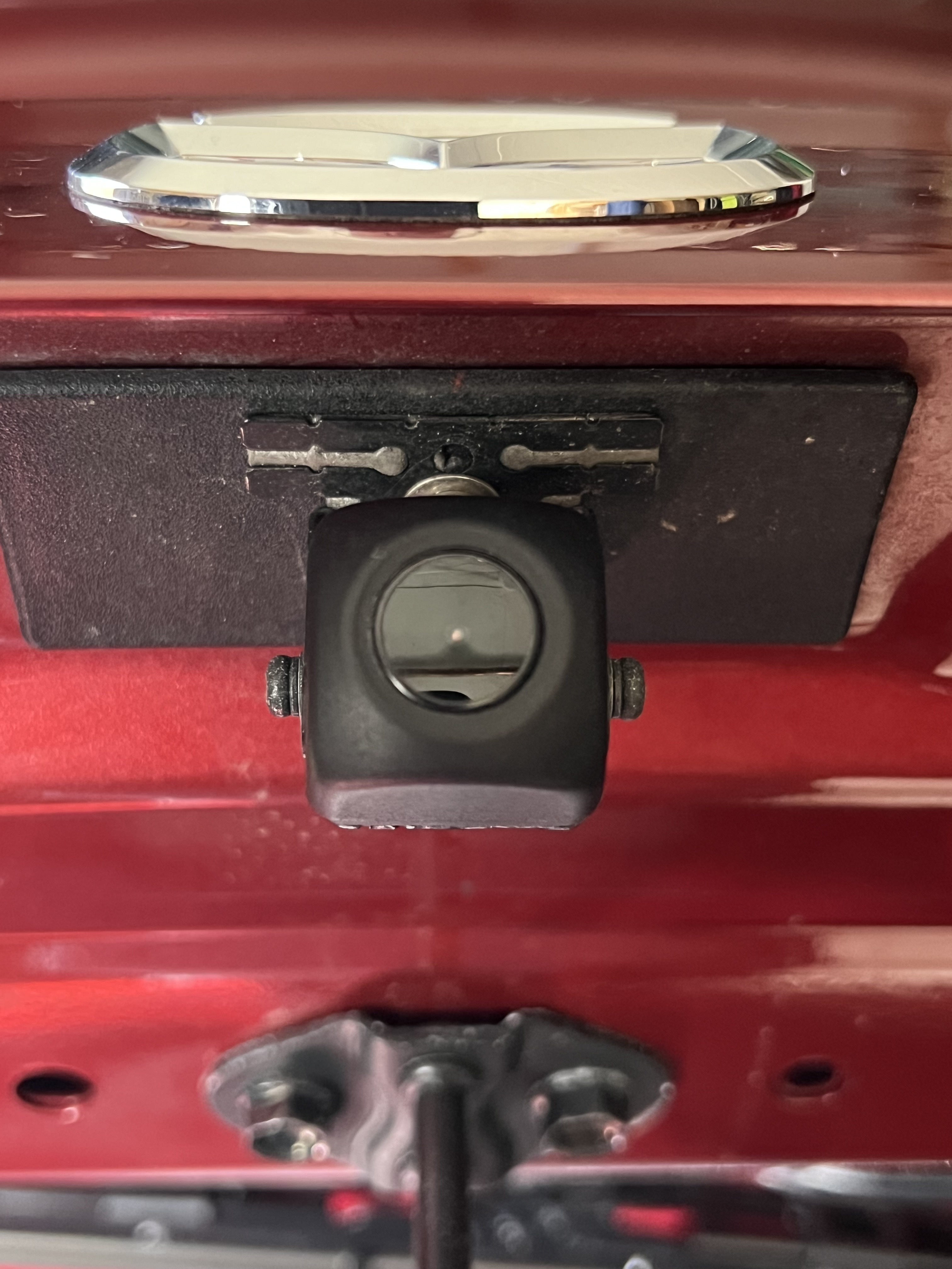

Okay, sounds like you will put the rear camera in.

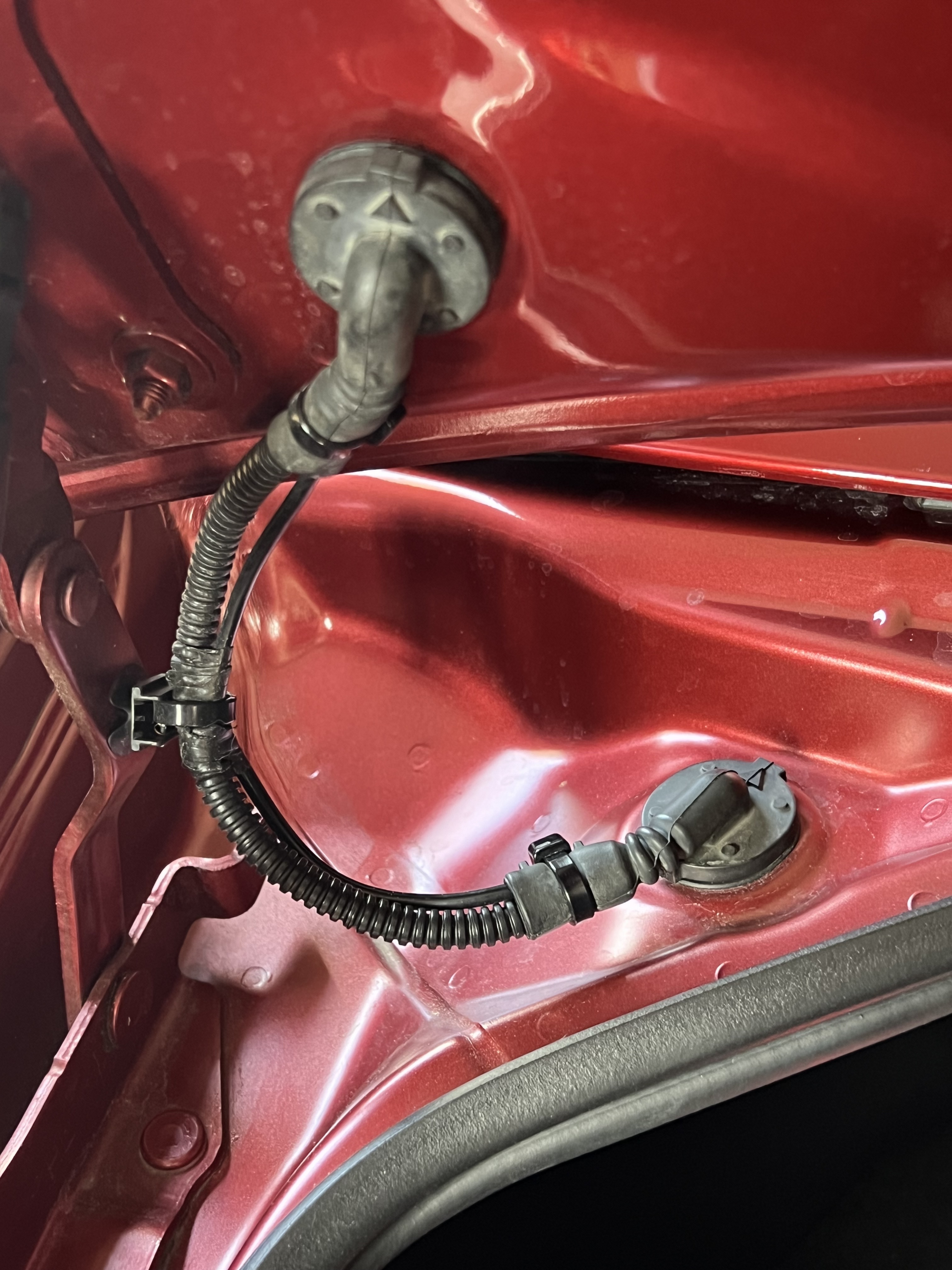

Top tip route it through the boot bulkhead in the existing waterproof grommets.
Get 2 silicon tube screw on nozzles and lube them into the existing grommets.
Perhaps a gentle heat from a hair dryer too.
You need to gently prise them out.
Cut the end off (of the nozzle) so the plug fits through and then cut the nozzles out and bobs your uncle.
The cable comes from the unit along the tunnel and then feeds through the carpet (slight cut from memory) and all hidden.
Wire coat hanger opened up did the job.
Pictures for your information. :+1:

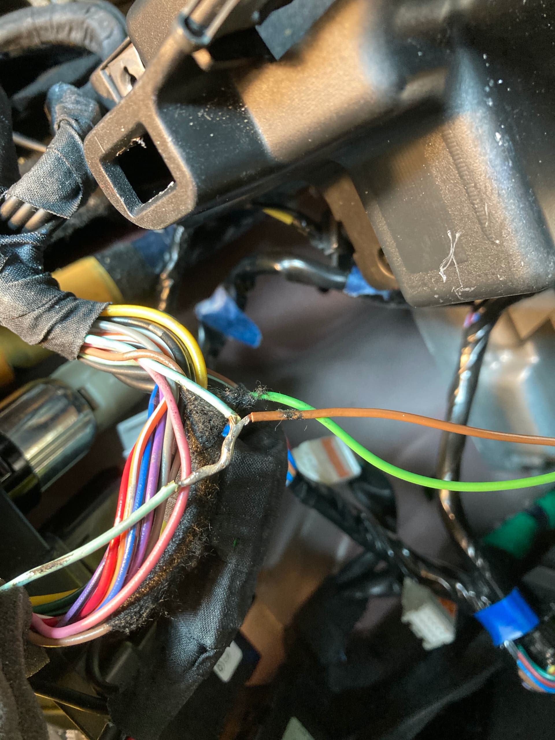

Edit- in addition the single LIME GREEN WIRE that runs behind the glove box and rearward is the one you do have to splice into for automatic camera operation when selecting reverse.
It’s actually spliced and taped in originally by Mazda.

Exactly what I did after following your instructions! However I didn’t cut the camera cable - managed to release the plug from the end of it (Pioneer camera) after looking up how to do it on YouTube! Once threaded through to the head unit I popped the plug back on.
Sorry, perhaps I didn’t explain correctly I didn’t cut the cable either just fed it through. :+1:

■■■■■■, I must have missed that wire for the camera - I went digging around the passenger footwell for the reversing light cable!
Is the lime green wire going to involve the dreaded soldering?
Nah, you can always use a scotch connector to snap onto it!
That was a top tip from Robbie when I was doing it. :+1:

I installed the reverse camera on my NC, best route for cables is go down the driver’s side, under the sill cover through into the boot. There’s a small opening in the very bottom corner of the boot (past the suspension turret) leading through to the cabin. You’ll need to remove the plastic back panelling that side enough to get to see how it goes, then in the boot remove all of the plastic liners. Feed the cable through the grommets already there to the boot lid (shown in the pic above) you may need to open up the rubber grommet a little, you can seal it with silicone seal.
You’ll just need as mentioned to connect up the live to the reverse lamp and an earth, easy enough. The more difficult part is finding that hole in the corner of the boot to pass the cable through. I attached a stiff piece of wire on the cables and poked away
