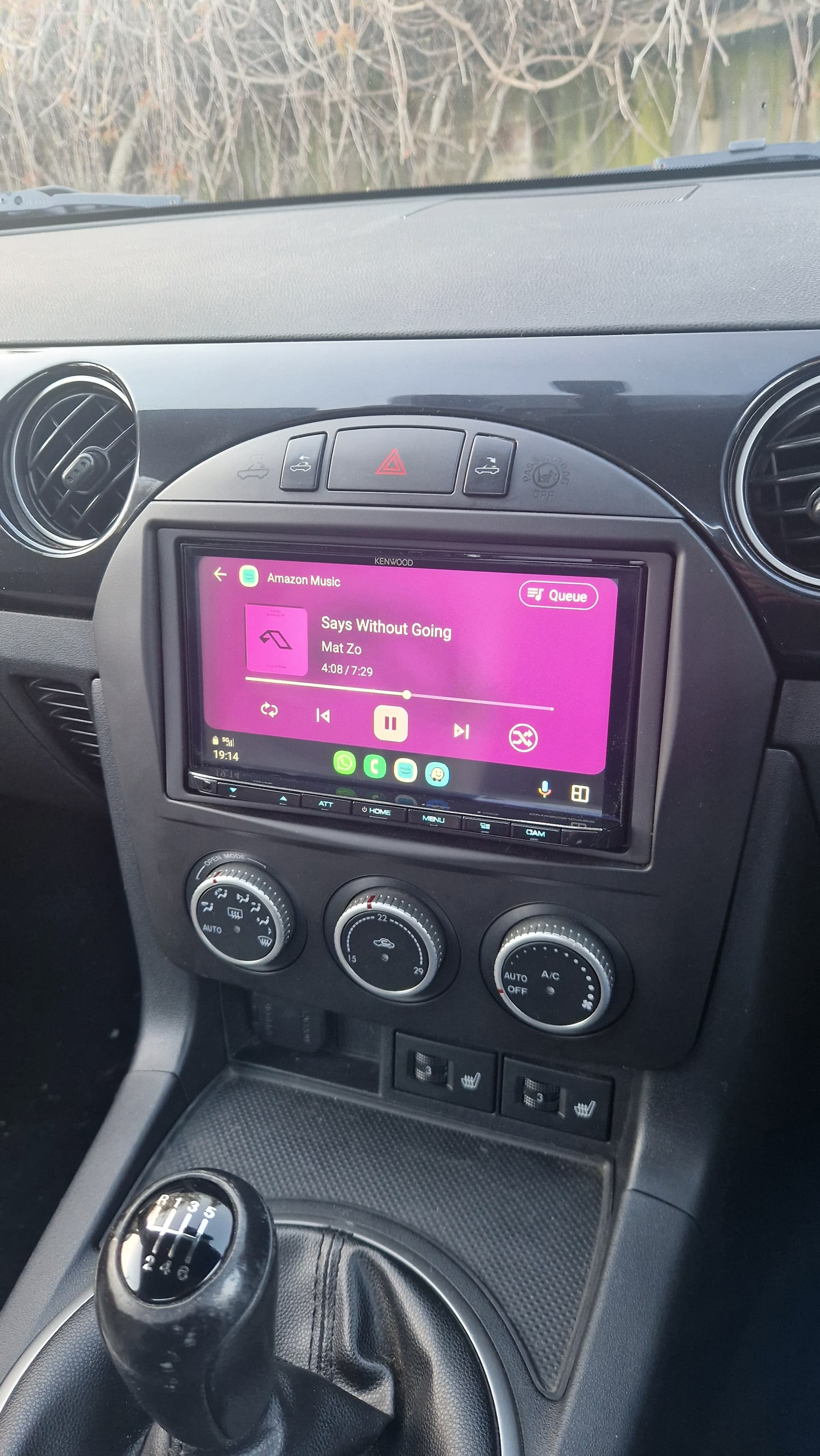

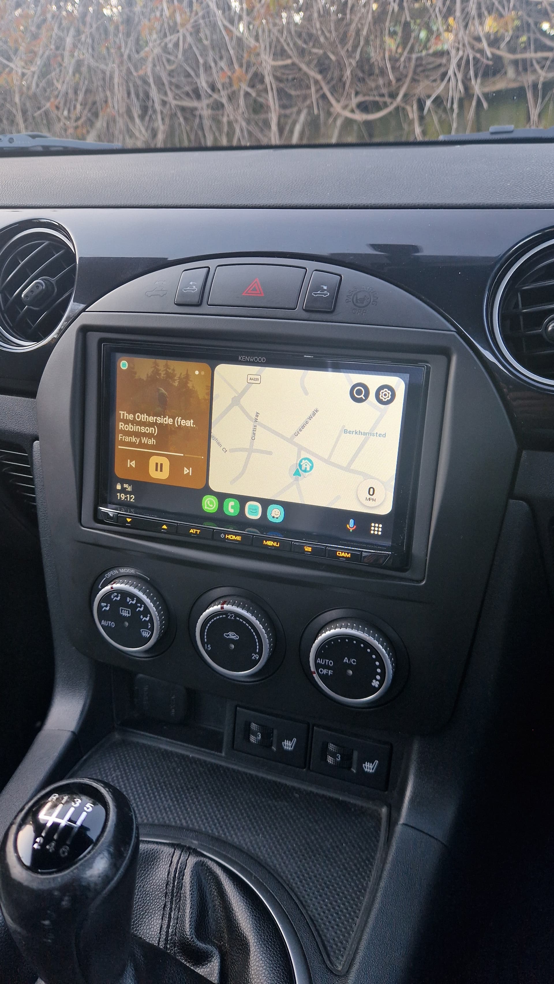

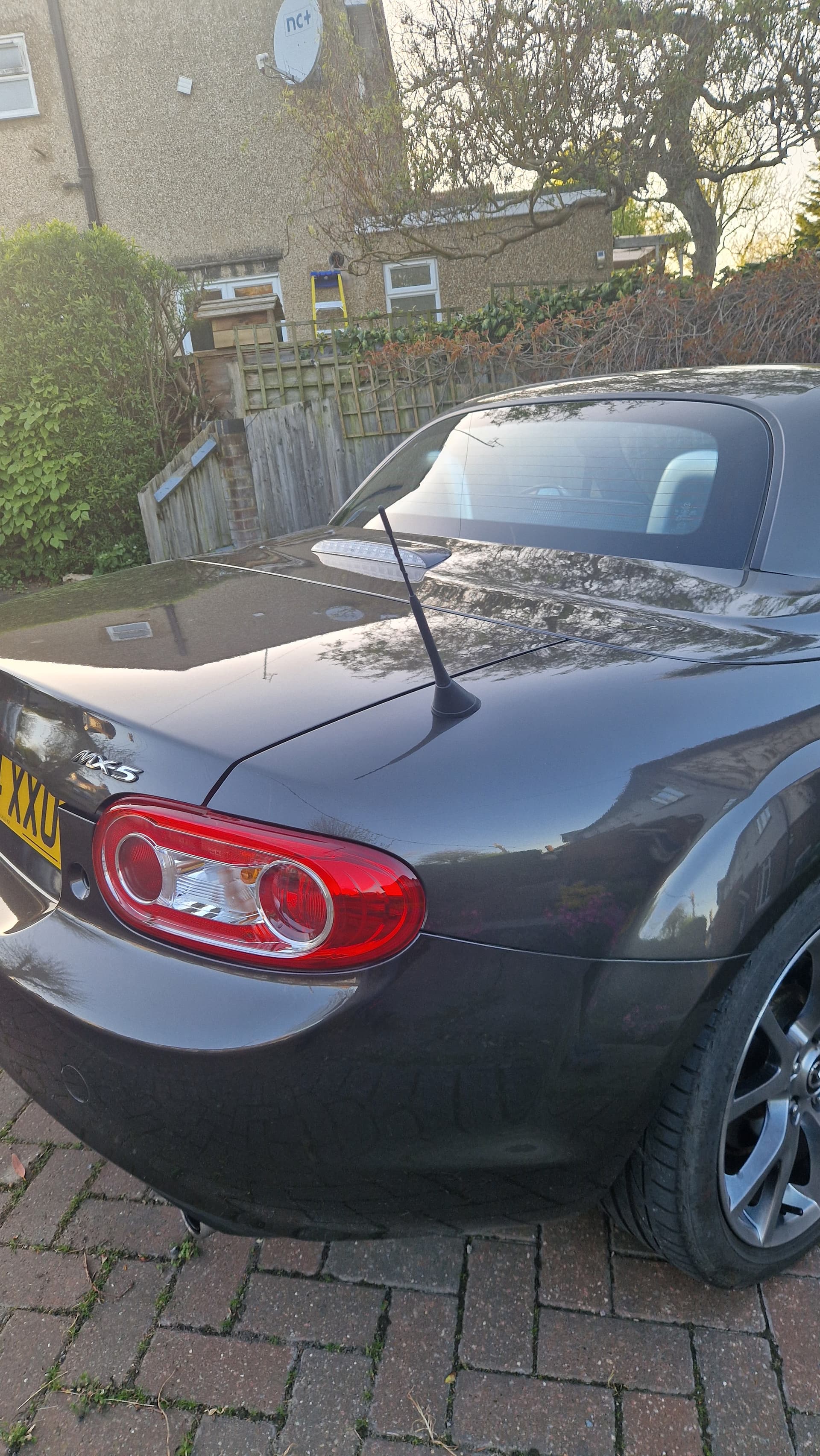

After a very long day, bleeding knuckles and a flat battery we are done! Thankfully my friend helped and I would have never been able to do it without him. There was alot of wiring being looped together, run to fuse boxes, through grommets, tied with string, we even utilised a tree branch to pull it through small spaces :laughing:

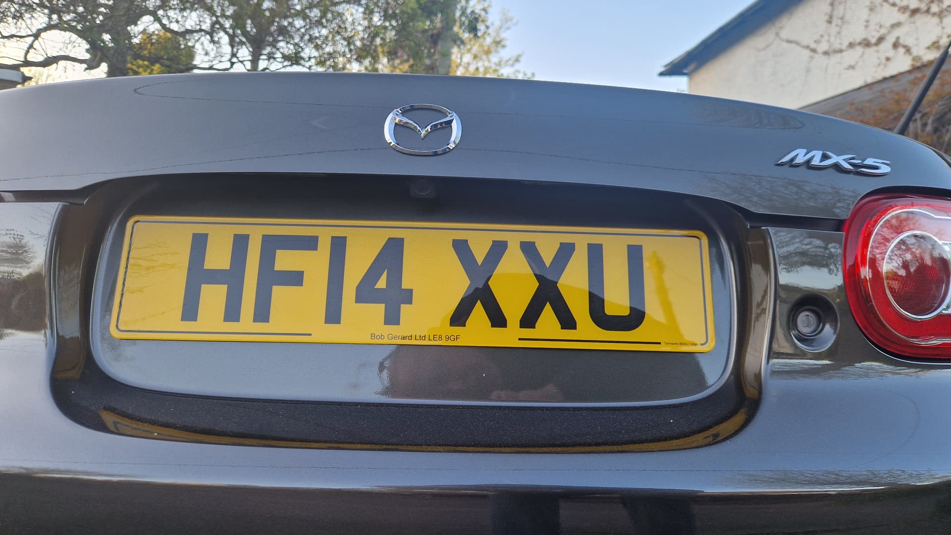

Everythings done and working bar one ■■■■■ up, we have the reverse camera working but when pulling it through the hole in the plastic plate we drilled we broke the wire connector. So thats borked but my mates coming back another night to rewire it. It definitely did work…!
Loving my new setup, and THANKS SO MUCH to all on here who’ve been helping and advising me, you’re the best!
Tell you what though…NEVER AGAIN :laughing:

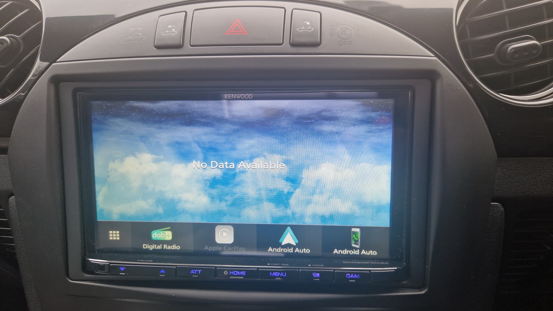

Quick one, anyone know what this screen is on the Kenwood 8021? Its the first window of you swipe left and whatever I do it just sits there saying no data available, weird
I think its for a no longer supported traffic app.

I did wonder as if you install their ‘weather/traffic’ app on your phone as instructed in the manual, it pops up with a message saying ‘no longer supported’ or something. What a weird thing to leave a dead screen there with a message in the middle like that - you’d have thought it would update itself to change it some way!

The issues for me came when I wanted a DAB aerial and a reversing camera. These head units come with the capability for these so I thought ‘may aswell get them too’. Que nightmare of pulling off all trim, threading wires though the bulkhead and rubber grommets, drilling holes etc. And I absolutely would not have been able to do the wiring without a friend who is very good at that sort of thing. The wires are connected via multiple scotch connectors to the fuse box and reverse lamp. He had to thread multiple wires together as they weren’t long enough. I would not have had a clue. You may need to get an aerial adaptor for the FM also, I got one and did note that the FM aerial lead wouldn’t have plugged into my new unit. However I got a whole new aerial and lead so it was a moot point. I still have the adaptor.
