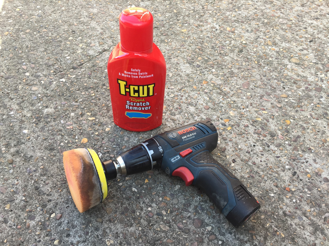

T-Cut or Autoglym paint restorer. The former I’ve only ever used on headlight lenses the latter is similar but not as harsh as the T-Cut. Apply by cloth and some elbow grease or on a mini buffing pad type of tool, Dremel or drill attachment.

where did you get the drill attachment/buffing pad?

drill buffer from ebay
