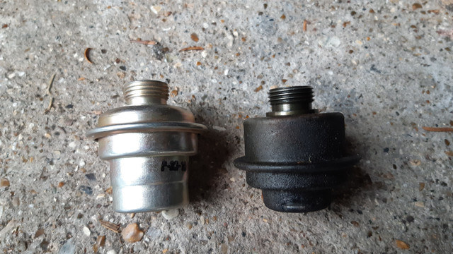

I recently replaced the ATF in my '92 imported Eunos. I’d been having that “white smoke” issue for a while and figured I’d replace the modulator as well. Turns out they’re almost impossible to find in the UK. I ordered one via Roackauto, the TN59 as it listed the OEM part number I was looking for.
https://www.rockauto.com/en/catalog/mazda,1992,mx-5+miata,1.6l+l4,1190898,transmission-automatic,governor+/+modulator,8500
The pic in the description looks the same as my original, but when it arrived it looked taller than my original. According to “Mike the Miata King” on Youtube https://youtu.be/cdgzilEXQL8?t=466, the tall one is for the 1.8 and the stubby one is for the 1.6 (which is the one I need). I got a refund and then ordered the TM59T. Again the pic in the descripton is identical, but now it’s arrived it’s the taller one again. (Clean = new…dirty = old - also discovered the original didn’t have a rubber o-ring )
vacuum-mod
My question is, does it actually make a difference? And if so, does anyone have any tips where I can find the stubby one?

The only thing I’m worried about is how the different sized modulators will affect the timings of when it changes gears. Why else would “Miata King” differentiate between them?

You have fitted the wrong one bud…

Thanks for that. I hadn’t looked at that shop link before. It kind of confirms that there is a difference for the pre-94 cars. And maybe that high price reflects how rare those stubby ones are to find!

As per the guide…the MK 1 1.6 needs the 1.6 item as the 1.8 needs the 1.8, they are designed the way they are because of where they fit and space. the 1.6 and 1.8 devil parts are available from Autolinkmx5
M-m
It will not fit, the design is different for a reason.

I’ve now ordered yet another modulator from Autolink. A bit more expensive then the previous ones, but at least they’ve taken the time to differentiate between the part needed for the 1.6 and the 1.8. The only reason I’m going to wait until it arrives to cheer is…the first modulator (bought from RockAuto) showed a photo of what I wanted, and delivered a differently shaped part. Same for the second one bought through Amazon.

Just to finish this off…I put the latest (and proper) modulator in today and the little car is back to being it’s sparky self!
I also had a look for and replaced the o-ring, but only because I had already bought it and figured, why not.
And for the hell of it, while I was waiting for delivery, I did put in the taller modulator as per rhino666’s suggestion to see if it fit. It did fit, as the threads are the same, and it did “work”, but the gear shifting was slow and passive. I assume because the shape of the can itself is different, but the shifting really reminded me of my old '68 Chrysler 300…really lethargic, like melted chocolate. The stubby modulator has given me back the old bitey, aggressive feel.
