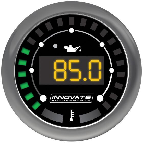

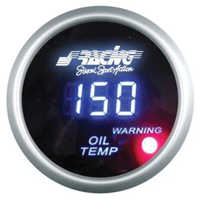

Surely on the track, you want oil temperature warning. Sudden loss of oil pressure at full chat is usually momentarily followed by the sound of the engine eating itself.
Some gauges, including combo units
You can set pressure and temperature warnings with this:
Thanks- I might add others but specifically with this post, with the duratec combined with the nc’s ridiculous fake gauge I’m looking at pressure.
The Innovate ticks all the boxes, that’s a great recommend- thanks! I feel a bit like i can get 9/10ths of the benefits with cheaper gauges but I do like their stuff. I’ll put it in The List
