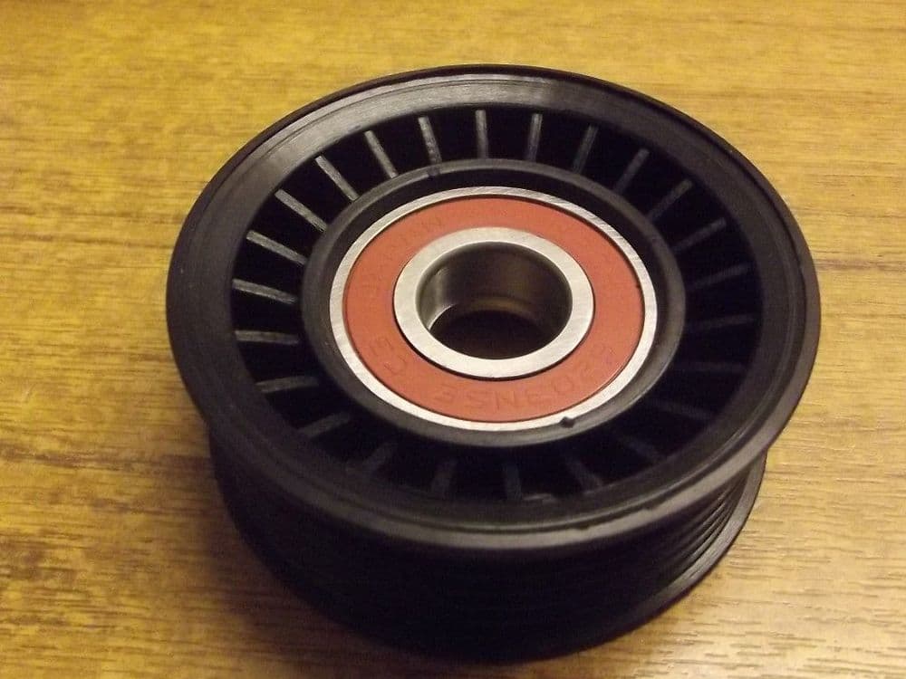

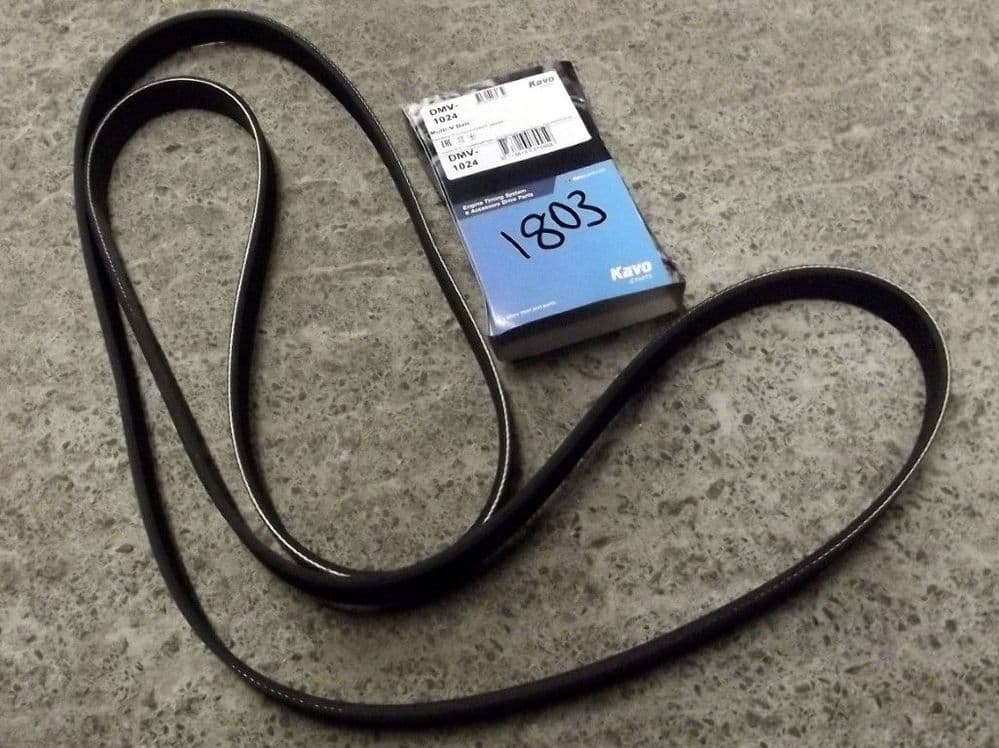

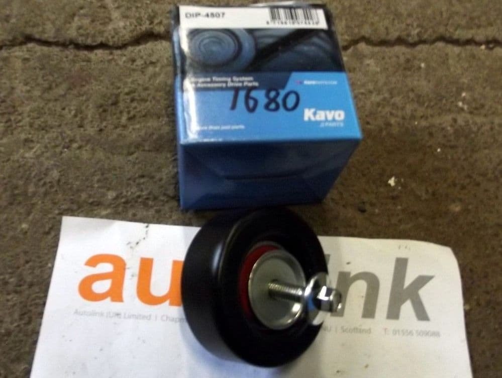

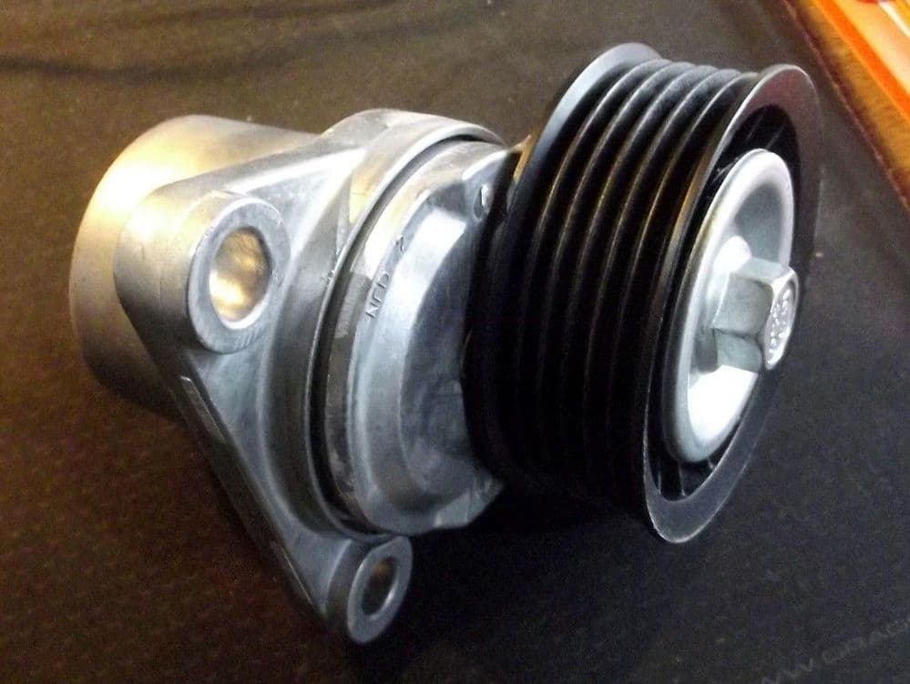

Buy these parts…

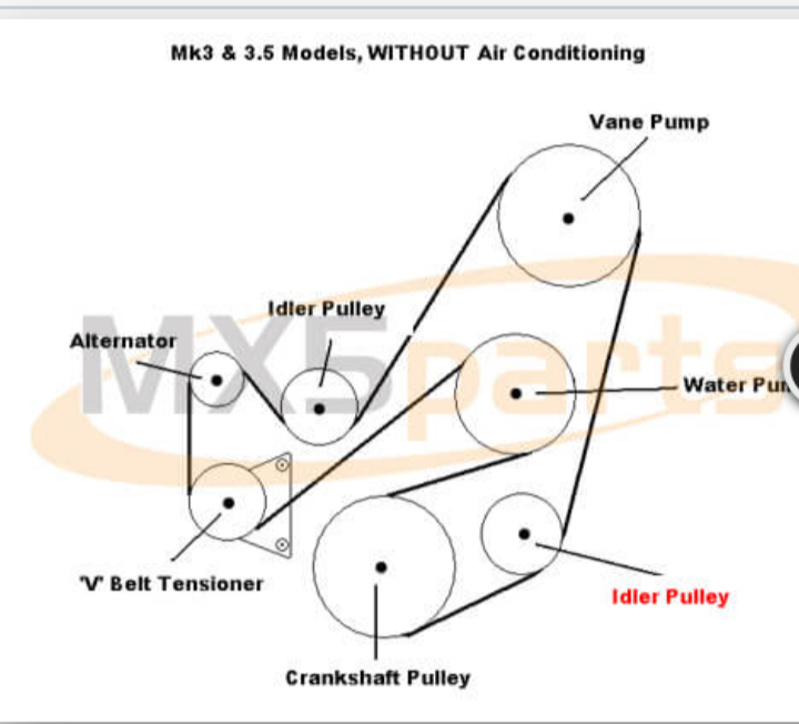

The tip is, this last selection above is just a replacement pulley for the tensioner assembly (second link down) it’s much much cheaper to buy that than the dedicated pulley option you can buy. This fits in the idler pulley position where you would have the Aircon cars pulley marked in red below.
Use the plate (large washer) from the old tensioner pulley that you removed/replaced. Doing it this way saved me around £40.

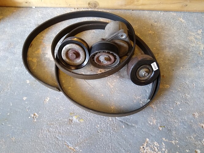

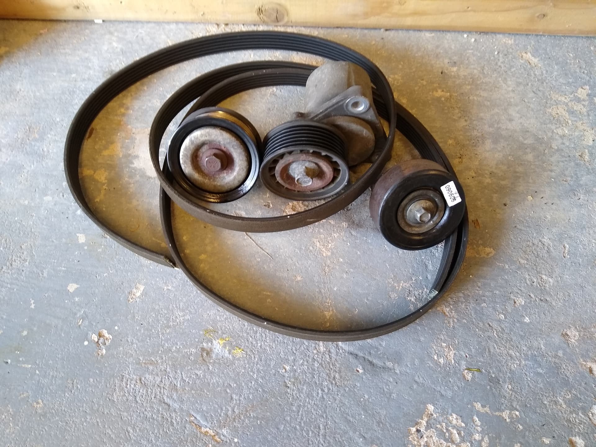

The bits I replaced…
So am I getting this right… You’re saying to buy two tensioner pulleys, one to reuse the existing tensioner spring part and the large washer and bolt, and the other instead of the idler pulley?
Buy the 4 items I have linked to. The fourth item I’ve linked to is just the pulley for the tensioner. That will replace the bottom pulley (no Aircon) shown marked in red. To fix this use the plate off the tensioner pulley shown centre of the picture I’ve posted. The left pulley (idler) I removed if you notice has a larger plate with bolt which didn’t fit the new idler.
You can if course buy this one below instead of the one in link number 4 but the price​:thinking::thinking:
I think I prefer the lower priced one.
It all fitted nicely, good job and great parts.
