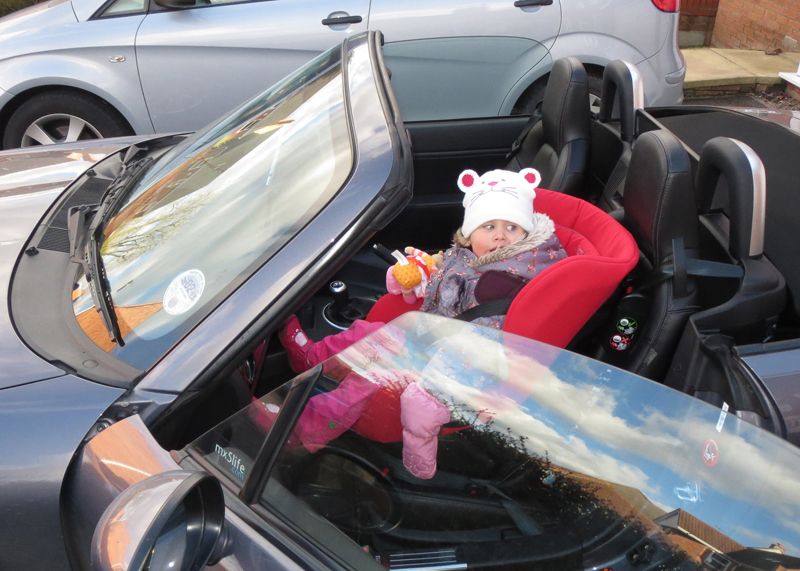

That seat is a Bebeconfort Axiss so it rotates through 90degrees, to put the child in and then swings back. It is not Isofix, but would recommend ISOFIX as it’s much easier to change between cars
