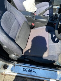

Hi All,
I have bought nice MK1 for me, however I am not able to enjoy driving it as I get lower back pain when I drive. I had back pain issues since long. I don’t have this problem with my other cars.
Is there anything I can change in my MX5 like seats or suspensions so improve driving experience.
any advice on this will be much appreciated. I like my car and I want to enjoy driving.
Many Thanks,
Parag

Thanks for response,
seats looks like original factory fitted for MX1,

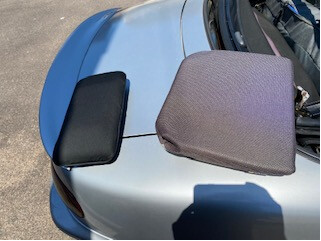

Hi All,
For the back pain problem I have added a wedge and back support shown in the photos. and it is working well for me. Before driving even a mile was painful but with these modification I can drive without pain. I haven’t tried long distance however I am now able to enjoy with roof down driving locally.
Regards,
Parag
