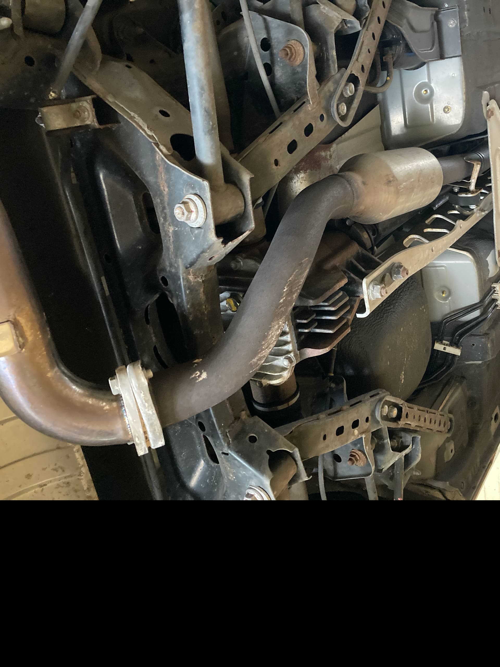

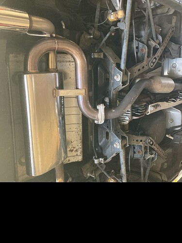

So in the end decided to take out the standard “resonator” box (centre standard cat remains) and replace it with a long SS 16 inch silencer. That fitted in very nicely and not obtrusive or bulky. Bit tricky fabricating the pipe work to fit in-between as normally easier when going from one end straight through to the other.

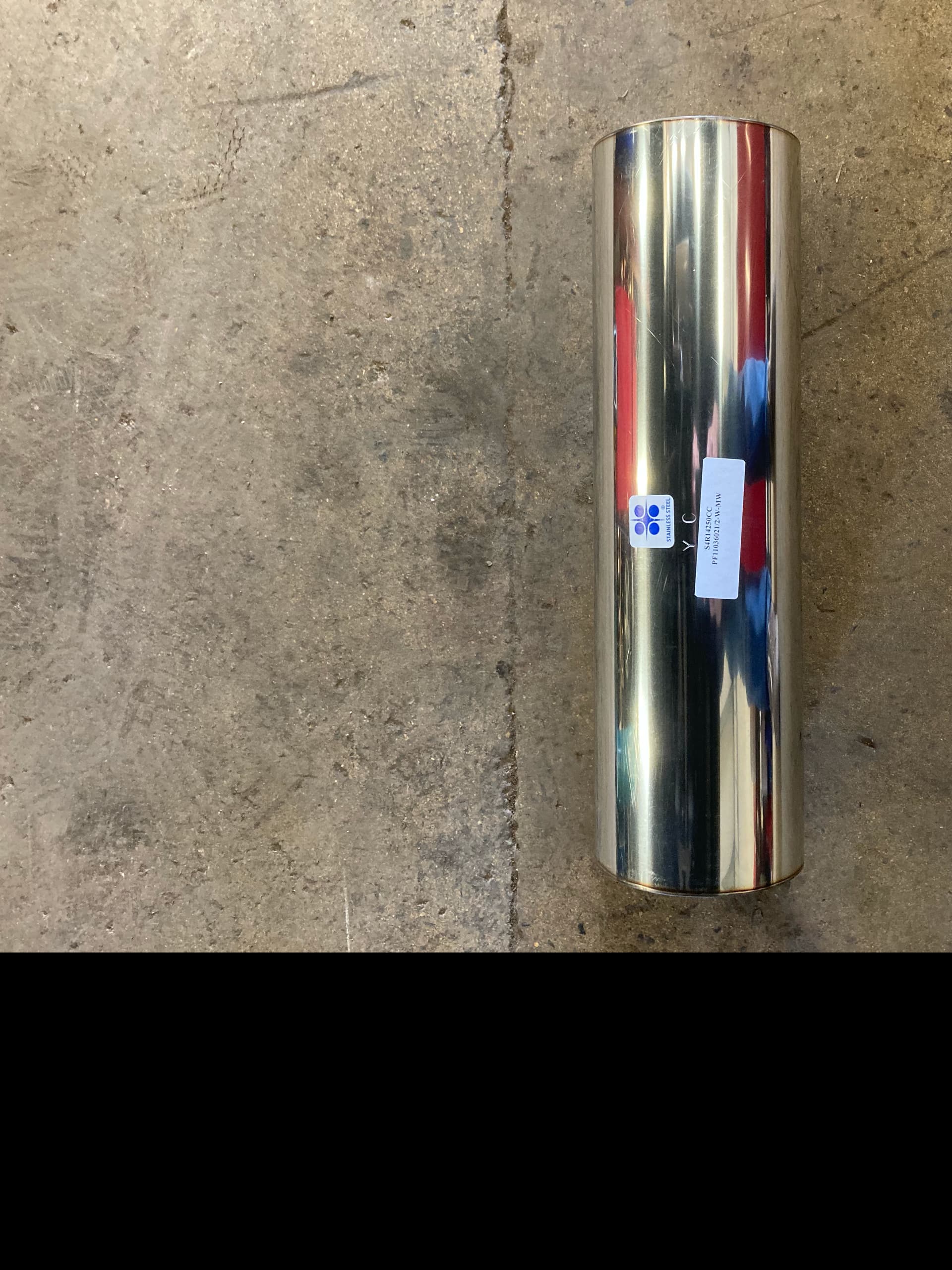

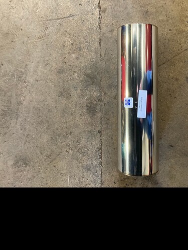

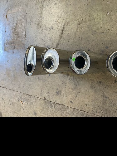

The company went out of there way and ordered in 4 boxes for me so we could try and make the best “Choice”.
Went with the 16 inch one (same diameter as before) but is nearly twice as long.
From this.
To this.
The result?
Well, on initial start up it was much more quiet. Seems to have a more deep rumble than before.
The drone has “almost” disappeared.
Far, far quieter when around town and cruising.
No headaches either.
Still have a “Good” sports car sound with a few pops and bangs.
Now if you want it to sound louder the higher the revs the more noise(obviously and the point?).
But it’s now in control and a real pleasure to use and drive.
Impossible to guess the % in reduction of sound really.
BUT more important than ever, the wife loves it now!!
Cost? £200 all in and money well spent in my opinion of course. :slightly_smiling_face: :+1:

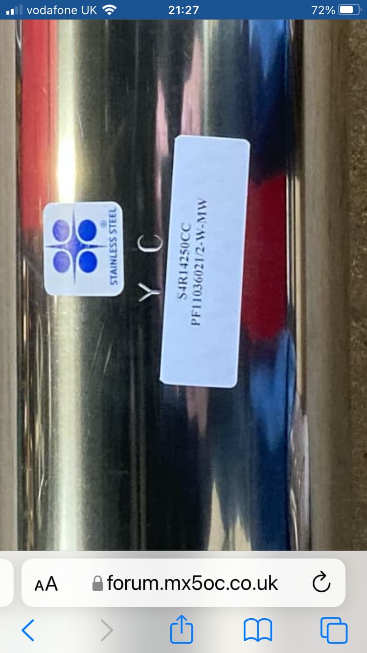

@Scarletpimpernel What is the actual diameter of the new silencer?
I believe it is 5 inch from memory. If you look at the picture of the 16 inch silencer above it has the part number/code on it. :+1:
In fact here you are.
