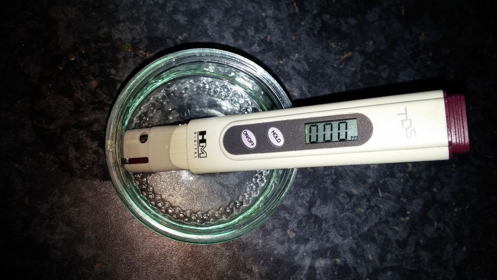

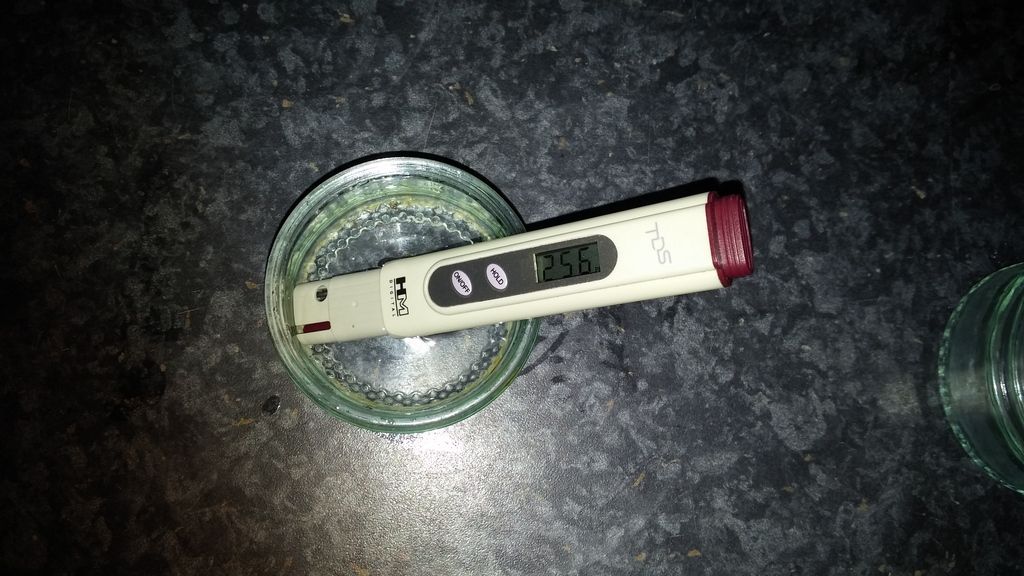

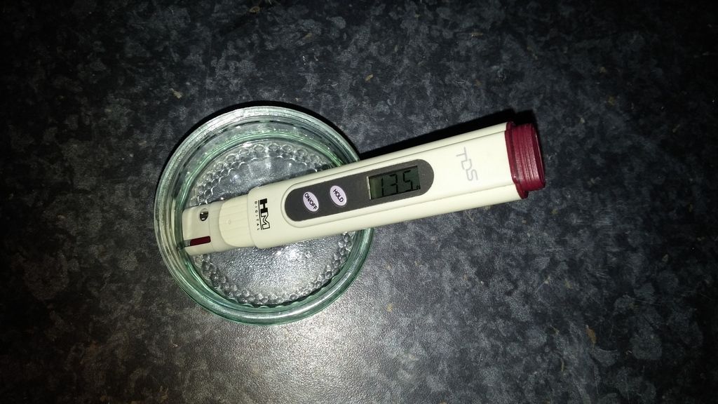

End result:
Standard tap water:
Brita Filtered water:
Unger DI Filtered water:
Even when it does not quite do 0 ppm it at least means I can remove the water spots with quick detailer and a fluffy MF. At the tap water level 20 minutes in reasonable sun would see it etch, which then means claying, water spot remover or polishing.
Second week using it did a small amount drying to polish some areas, not one spot formed happy days. :slight_smile:

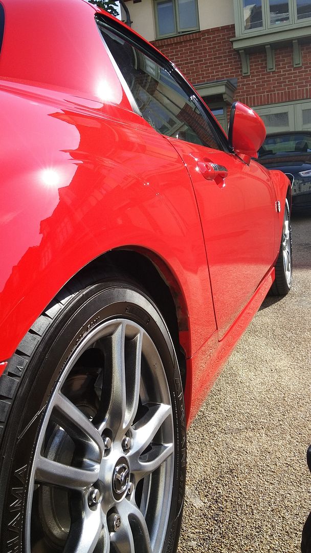

Final result (still rocking Zymol Vintage, but I have been round and reapplied without Raceglaze Signature Glaze in honesty I can barely notice a difference, there is some RDS and the odd swirl around but not major swirlage!):
