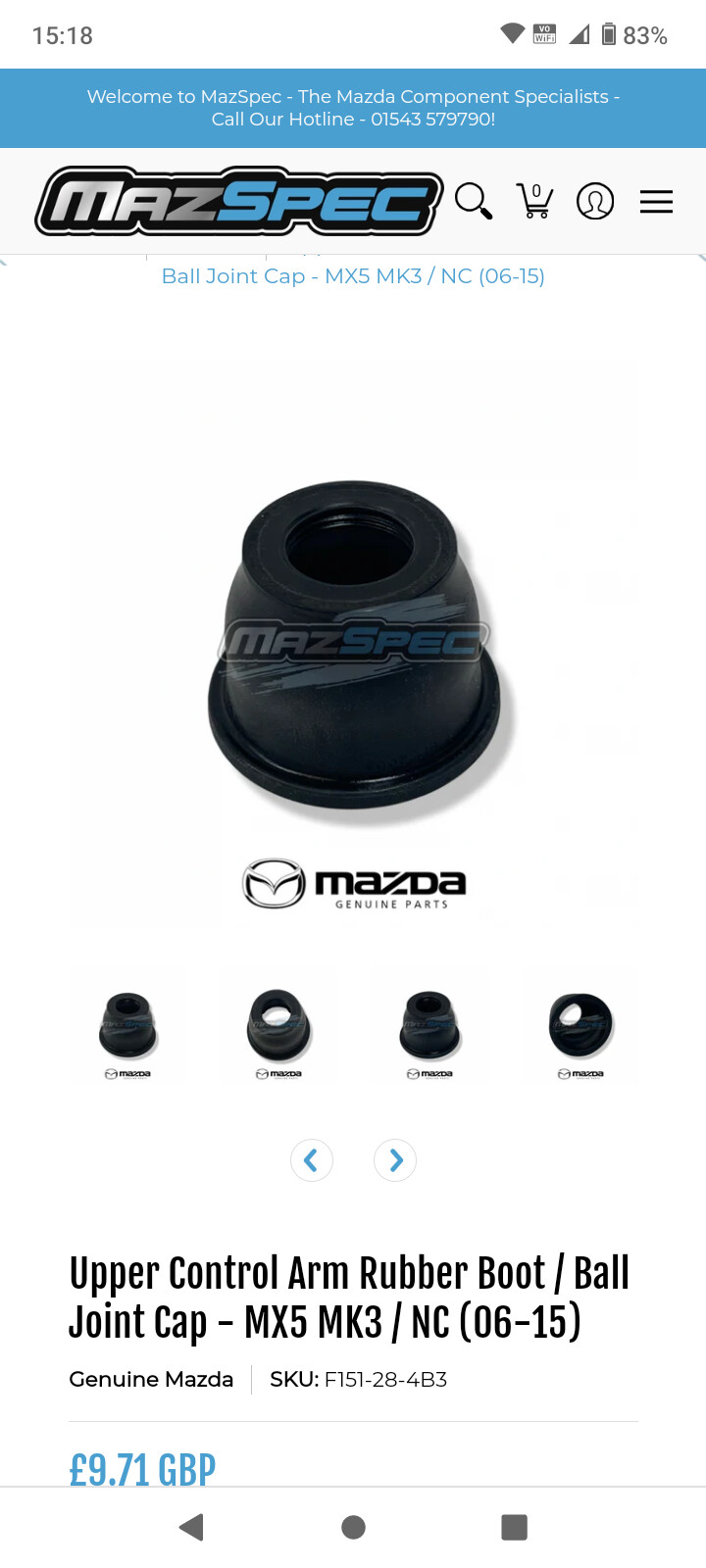

Wondering if any members have replaced ball joint boots.
If so any tips would be appreciated, ie technique / tooling required.
