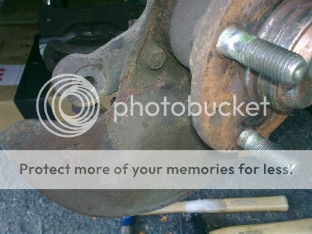

Here’s the bit you want to hit:

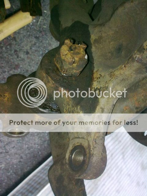

And here’s the other side:
