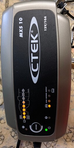

This CTEK dose just the job,

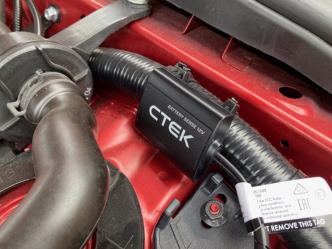

Just a little up date I bought this today as everyones watching the £££ with electricity bills I am not keeping the CTEK charger on All the time …I bought this accessory which will inform me when the the battery is low so I can power down the garage electrical sockets till needed well they say every penny counts… :wink: :wink:
TRACK THE HEALTH OF YOUR BATTERY WITH THIS UNIQUE BLUETOOTH ENABLED SMART TRACKING DEVICE.
CTX Battery Sense is a Bluetooth® enabled, smart battery management tool which helps to prevent vehicle breakdowns and maximises battery performance by offering valuable, simple to understand information regarding the current health of your battery charge. The device is linked to a free and easy to download app, a connection is then made to the Battery Sense Monitor which is linked to your battery. Simple in-app instructions are given and your mobile phone will provide battery data 24hrs a day, 7 days a week, all year round. When and if your battery’s charge falls to a critical level, Battery Sense will send a notification to advise on connecting your CTEK battery charger.
Features & Benefits:
  • Provides advanced notifications in case of battery failure
  • Suitable for all cars & motorcycles engine starter batteries 4.5AH or over
  • Automatically syncs via Bluetooth®
  • Continuously monitors battery’s charge
  • Records stats for up to 3 months
