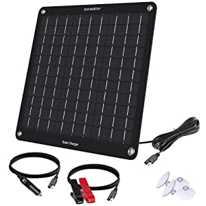

My ND2 battery will be flat in 3 or so weeks. When parked at home, I turn off the internal sensors (bottom key button). I also attach a 12v solar panel if I’m going to be using my Eunos or regular car.

Linky
It’s safe where I live to have this propped up on the windscreen or rear roof, but it will still work if propped up against the windscreen inside the car, but not as efficient.
