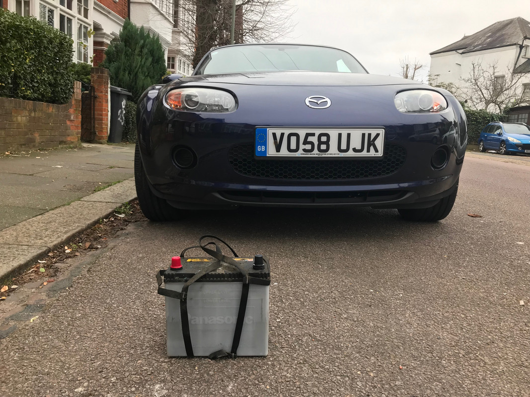

Bought my Mk3 2008 a few months ago, has gone from regular use to weekends only and kept needing to jump start it.
Took Rhino’s advice re the Yuasa 5000 - bought from his link and very happy with the result .  Had a 9v DC transformer holding the settings during change.
I was pretty impressed that the (presumably) original Panasonic battery had lasted for over a decade!
