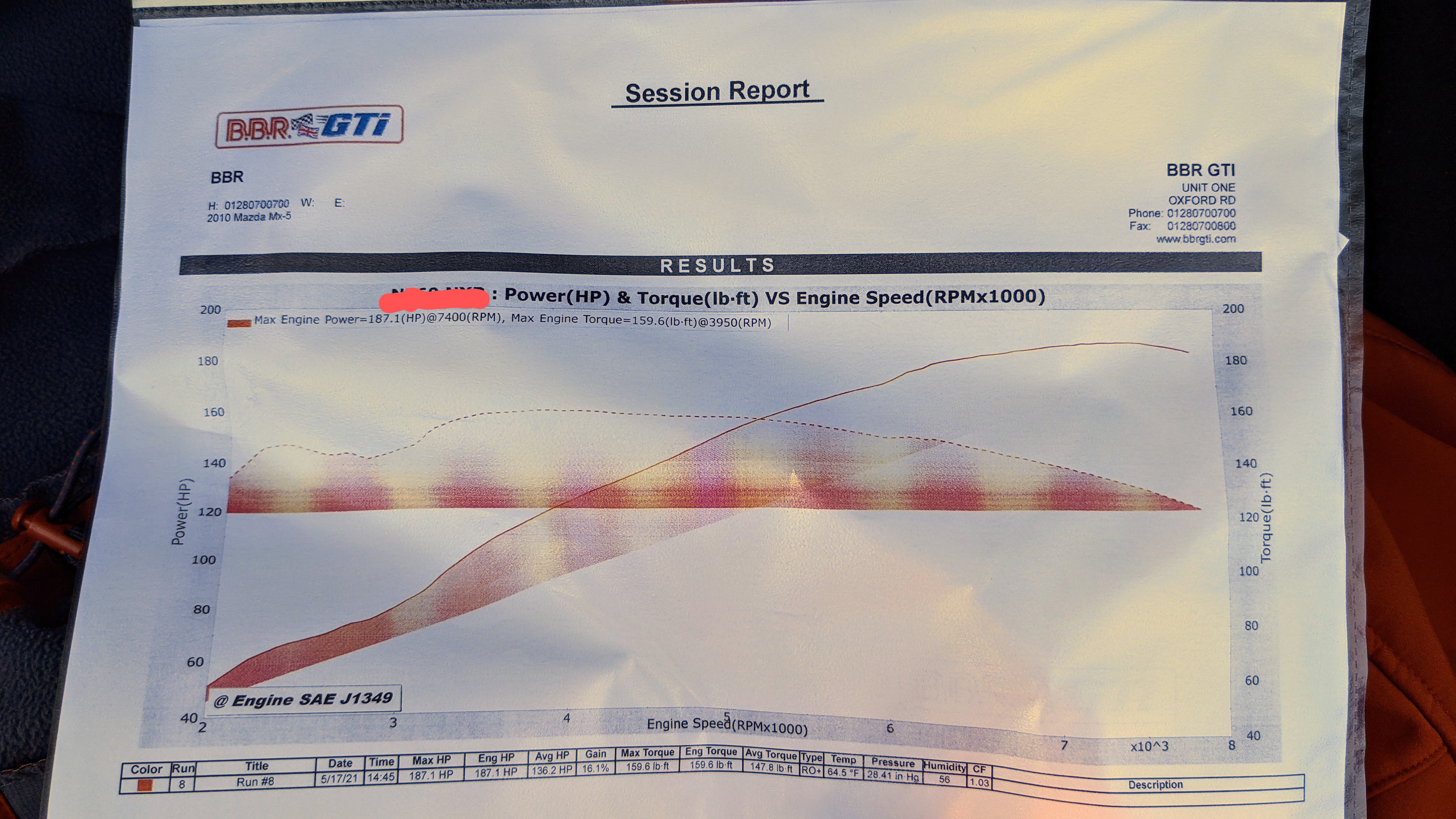

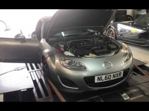

Similar to mine! BBR mk1 and getting 176 at the wheels
Hi H,
176 at the wheels is very good, the 187 on the graph will more than likely be a ‘corrected flywheel’ figure not ‘at the wheels’.
7k in 2nd
Daveya
