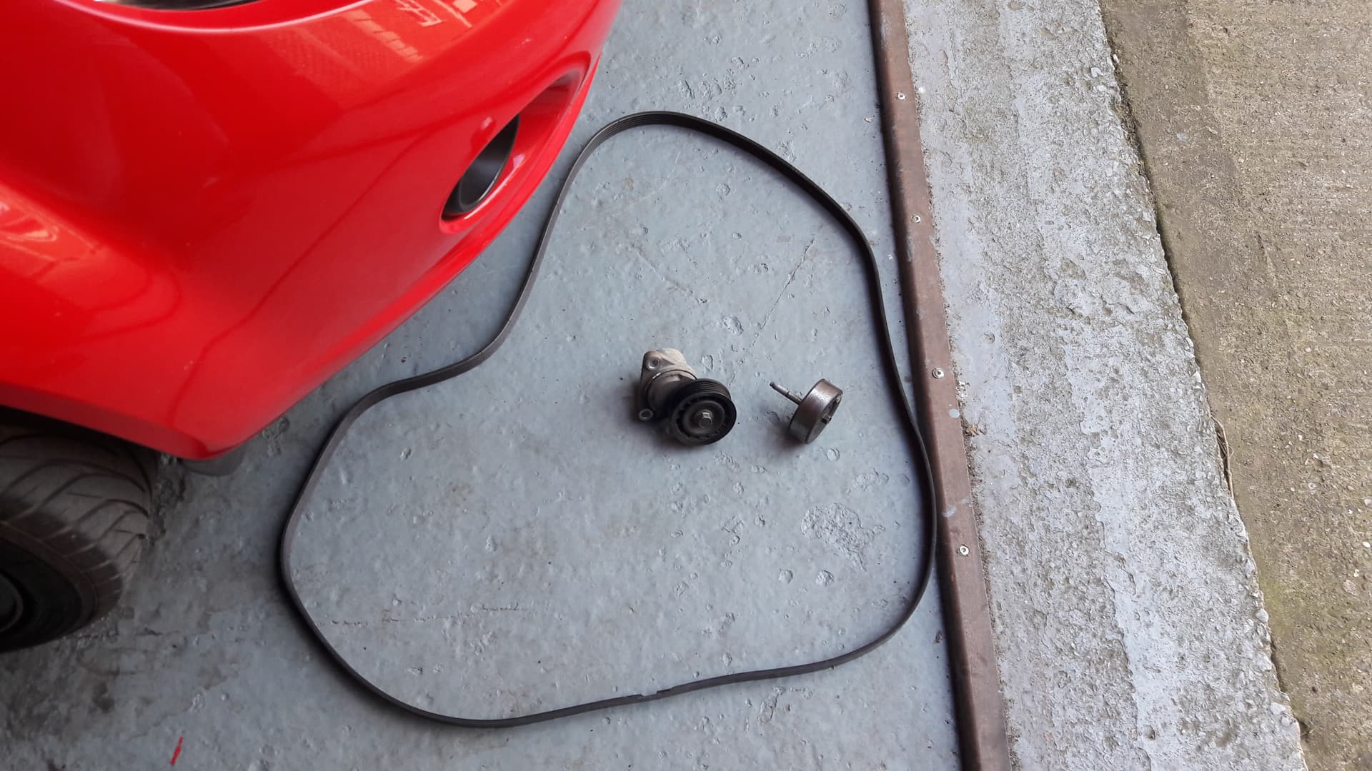

on a prevoius 5 i owned i had a similar noise , it became more apparent when passing a row of shops or houses on both sides of the road ( similar circumstance to you in cheddar gorge)…
i took it to a well known mx5 specialist who told me the engine was “shot” and required a £2000 rebuild ( 5 yrs ago ) :disappointed: :disappointed:
After some research ( google /forums ) ,
i removed the serpentine belt , restarted the engine and it ran silent and smooth :partying_face: :partying_face:
£100 bought a new belt , idler pulley and tensioner :+1: :+1:
around a hour to fit … no issues since ( the new owner is still in touch with me :+1:)
its worth trying ,

To echo bally3’s comments, I had a ticking noise on my 2006 2.0 NC in the early days of ownership, I replaced the idler pulley, the problem completely disappeared, I now have a BBR200 kit fitted, no ticking at all.
That would be my first point of investigation.
Tell the garage to remove the belt and run it briefly without. If that doesn’t stop it then suggest they whip the cam cover off and visually check every cam bucket face and cam lobe for abnormal wear.
