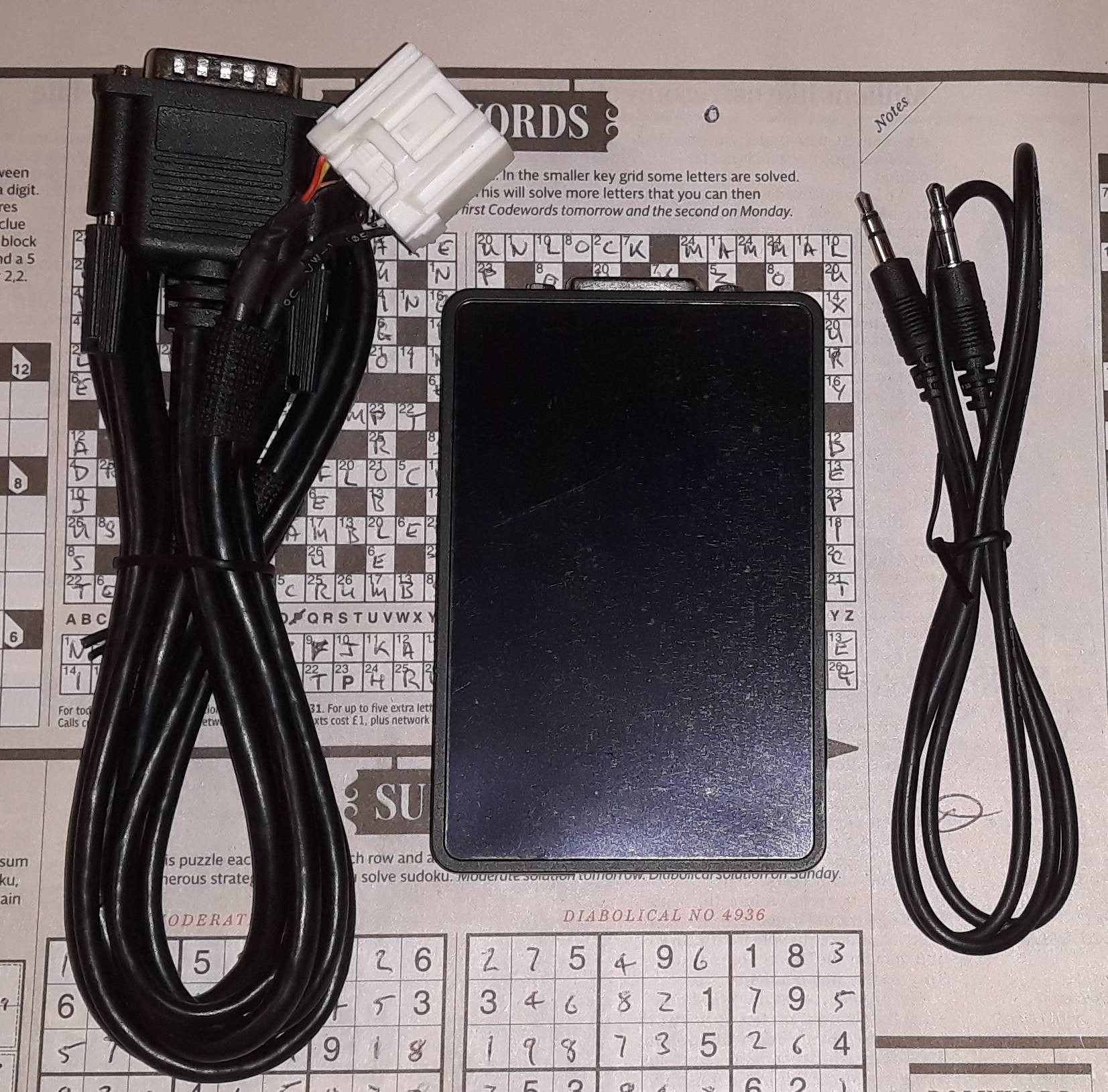

That multi-way is for an early iPod.
It plugs into a module bundled tight behind the head-unit and that module has another long lead plugged into the head-unit’s Aux connector next to the Aerial plug.
I took it out and replaced it with something more useful as here
