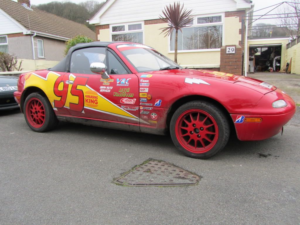

Not really Jon, 205 tyres on a 7J rim is a bit over-tyre and can lead to a bit too much sidewall flex giving a sloppy turn-in. Oddly `Lightning is on 195/45/15 fronts and 195/50/15 rears on 7J Mim1900 rims, and the front sidewall is dead square almost, would buy 45 series again if they were  were cheaper, it drives really well on the 45.
