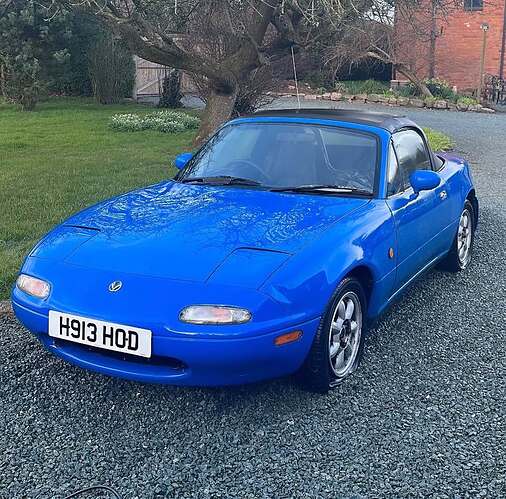

Roll on 6 months and my MR2 still isn’t ready :face_with_symbols_on_mouth: so I was looking for another project car. I bought a 2003 WRX that is an absolute nail and wasn’t really blown away by it, so it is going up for sale, in the mean time I was searching Facebook Marketplace and eBay frantically looking for a convertible project car before the sun disappears again! I look at a few Z4’s and Audi TT 225’s but nothing stood out to me until I found this:
It wasn’t too far from me but I didn’t have chance to view, the seller had it up for £1000 as a non-runner due to what he said may be a faulty immobiliser. I found someone to deliver it to me for £100, offered him £700 and we had a deal.

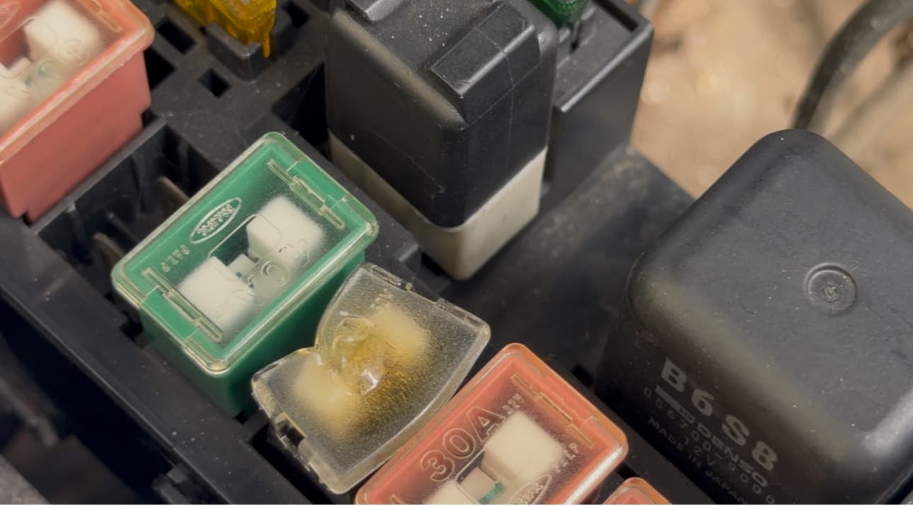

I have made a fair it of progress over the past week, including being able to take it for a quick run around the village. The first issue to solve was the non-start issue, after having many Japanese cars and trawling the forums and Facebook I concluded that it would either be the 80amp fuse in the engine bay, an immobiliser issue as the seller had mentioned or maybe starter motor. The symptoms were that the car wouldn’t even try to start, when the key was turned the blowers worked as did the radio but there were no lights on the dash at all! :face_with_diagonal_mouth:
In my mind this meant that the 80amp fuse was good as when they blow, nothing works but I checked it anyway as it was the easiest thing to check.
Didn’t look good so I replaced it anyway! She still wouldn’t turn over though :weary_face:
