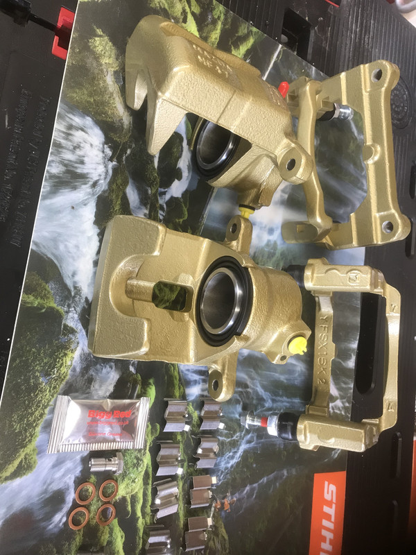

The pic you put up appears to show a clean and relatively rust free caliper which is in itself rare on these cars - just look at the crusty used big brakes on sale in the usual places. I bought a set in very good condition to clean up and sell. It took me a day to clear rust off carriers, calipers, etc and hydrate 80 - did triple my money though.
Having recently got into some brake refurbishing myself I can tell you that replacing the seals, gaiters and piston on an MX5 brake caliper MK1 - MK3 is not difficult and is a worthwhile job, if required.
Pistons on yours will likely be chrome plated. Check them by removing caliper from disc and pumping(gently)/adjusting(rears) piston forward enough so the gaiter can be removed from piston and pushed forward to check for rust, leaks and splits. If there is none of that and the piston moves easily enough just a case of lubing with red rubber or silicon grease. Other important parts to check are the slider pins. They should be clean and rust free with adequate red rubber/silicon grease lube. Carriers should ideally be clean and rust free which is difficult to maintain particularly if car outside and used daily. grease contact points on piston, caliper, pads shims, etc. Wheel should spin when all assembled with no strong stoppage but a little brushing of pad to disc is not an issue. There should be no serious heat generated in driving where not created legitimately with brake use.
Most of us do not service our brakes anywhere near enough and wonder why they fail or fall apart on inspection. MX5 brakes when compared to something like a VW Golf MKIV for example need a lot more looking after. I would say inspection/lubrication at least once a year and serious attention every 2 years.
