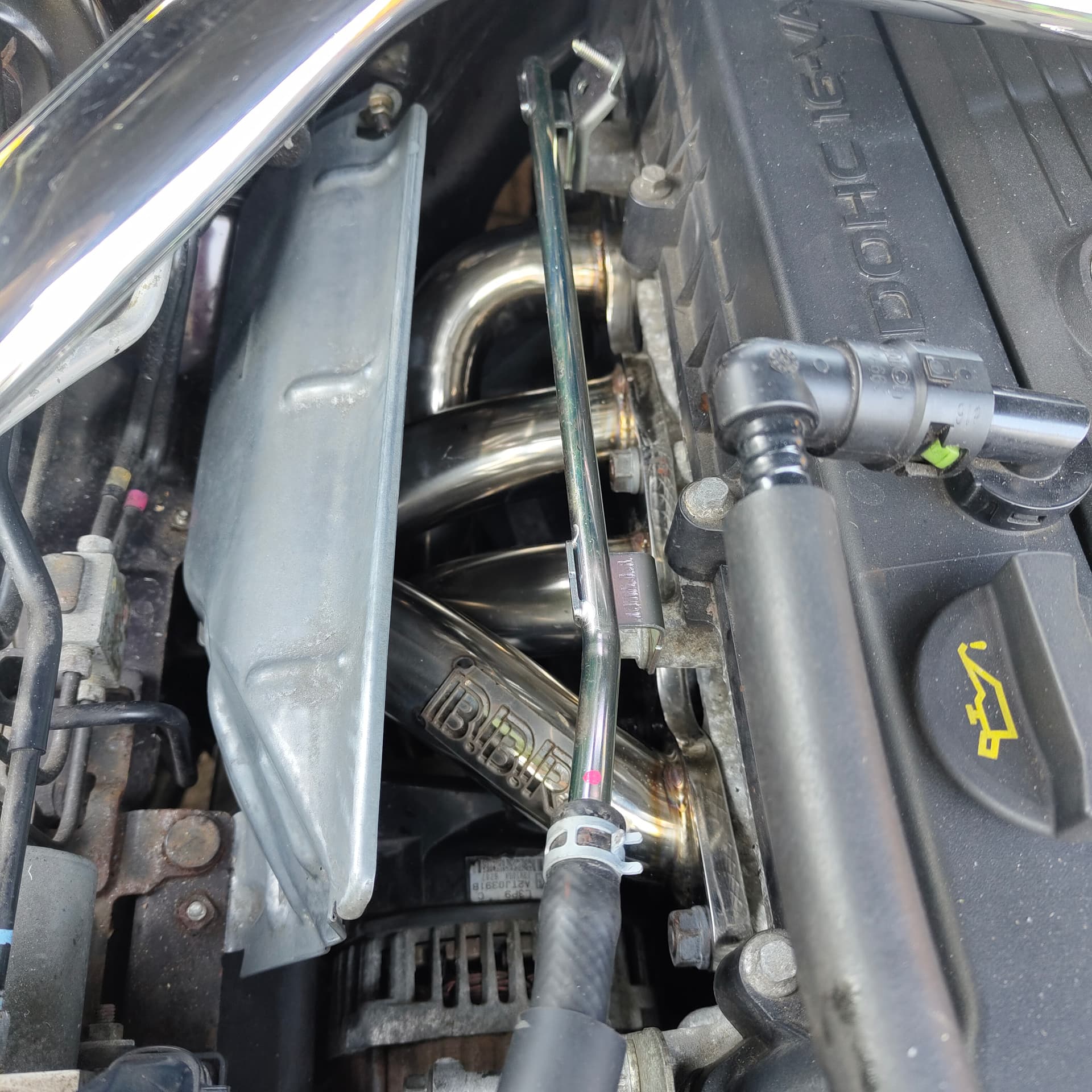

Continuing the now a little aged posts about manifolds and MOT’s …
I had been having problems with my O2 sensor occasionally lighting up the CEL… Cleared it, but it would come on again in a few weeks.
The car was fitted with a BBR 4-1 manifold (non cat) and catted IL Motorsports catted mid pipe with O2 sensor before that cat and downstream sensor removed and mapped out
Went in for MOT and fate had it that CEL came on so tester took a look and failed it for also not having the manifold cat. It’s now in the mor history so couldn’t just replace the O2 sensor and go to another tester…
So… Just finished fitting the BBR Catted manifold. Doesn’t look much different installed (from the top) but at least I won’t have those problems again.

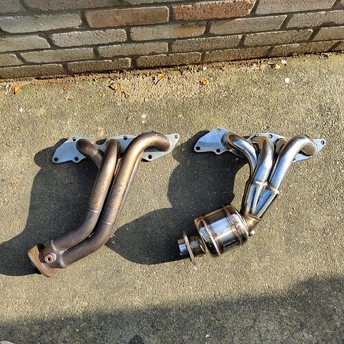

Would you sell the old manifold

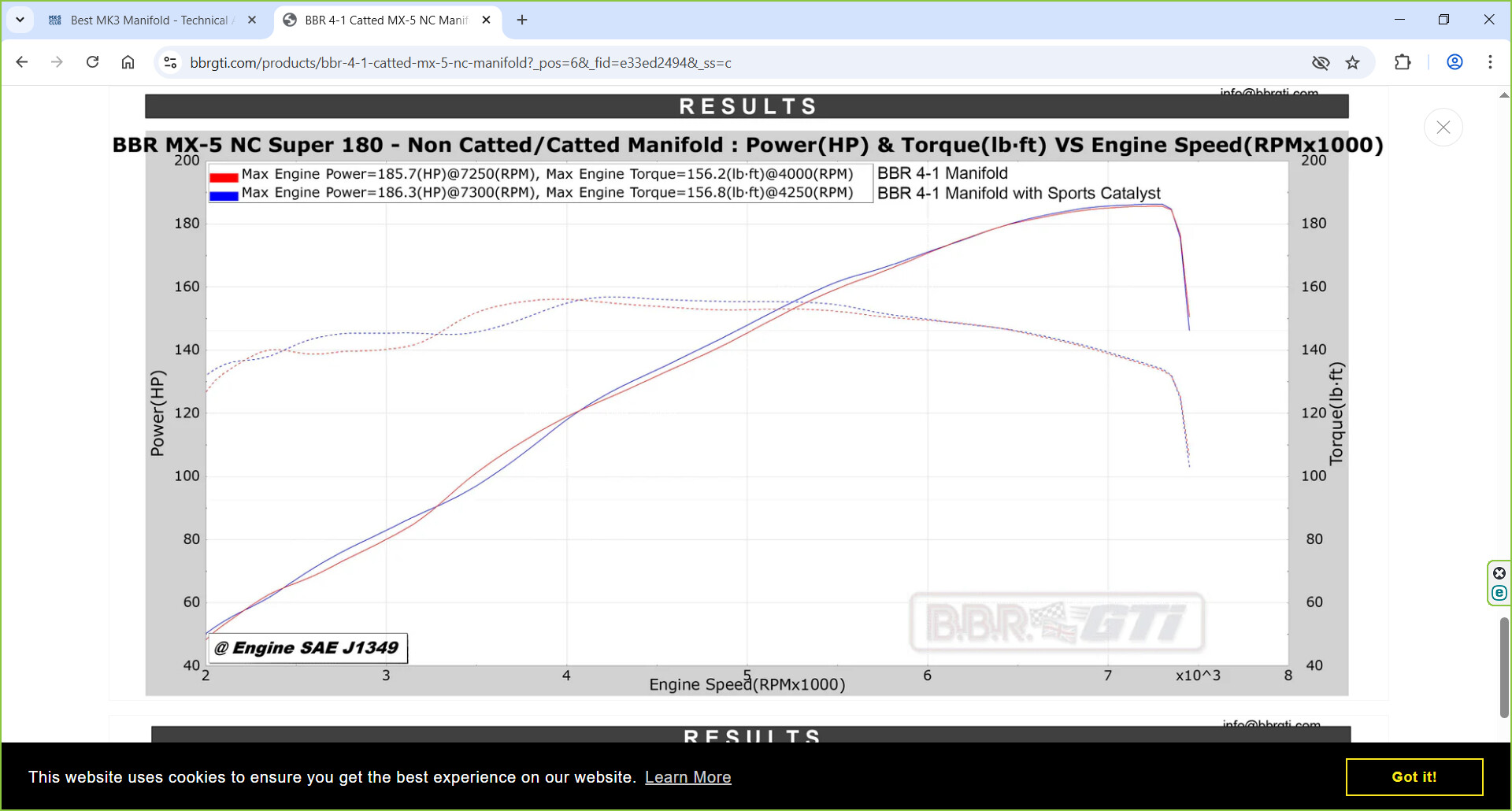

The power graph on BBR site shows both manifolds on the same chart for the 180/185

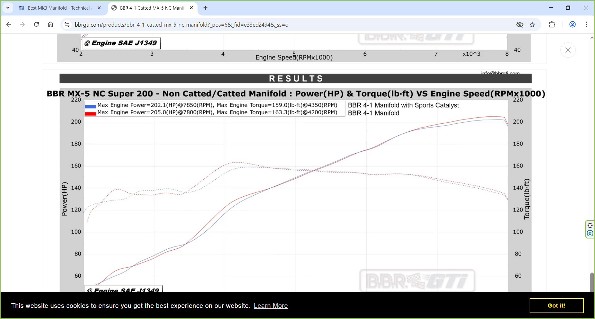

And also for the 200
That’s including their camshaft, not the manifold alone?
The 180/185 package does not have the cams

Looking at the BBR Dyno graphs, I would tend to agree with the comment regarding little loss on the catted Vs open manifold. NC1 … I have k&n panel air filter, Ilm centre pipe, stock back box… Had BBR straight through manifold and ECU Tek map but failed MOT so had to put the catted manifold on.
At higher revs the car continues to pull well through to 7,000+ rpm.
But at the 3250 point, where cam timing changes cut in, the catted configuration feels a little ‘flat’ compared to the open one. Just don’t get that ‘surge’ that I used to get.
You can see on the 185 torque graph that the blue line dips below the red line through the 3000-4000 range and you can clearly feel that.
It’s a critical operating region for a road going car and I feel I need to hold it in a lower gear for longer before changing up. Probably ok on a track car though.
