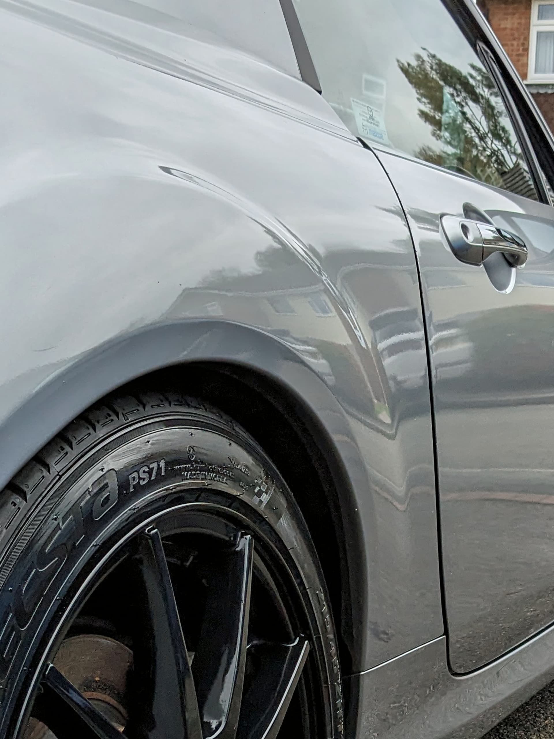

I think I know the area you mean, check out the rear arch lip on this NC below. I had a couple of very minor rust patches a little edge corrosion on the lip. I could have spot painted it but it needed grinding back first to remove the surface bubbling. I decided to get the rust treated, painted with a suitable rust converter, then painted over with Bilt Hamber black epoxy. All masked up I painted the whole lip about 10mm in. The black epoxy, then grey primer, a few coats to cover the black, then finished in a few coats of body colour.
All being sanded back a little between coats to leave a smooth finish. Finished off with a lacquer coating.
Nearly 3 years still looking rust free when I sold the car. You have to look close to see the paint join.
I also used the Bilt Hamber to coat the inside of the lip, wheel arch liners out then sprayed over with Dinitrol underbody seal.

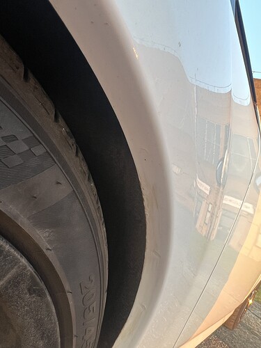

Thank you. This is a poor photo.l but may show what I mean
Thank you. That’s very helpful. Which product did you use to convert and treat? Looks awesome!
Yep, same area. On mine it was a slightly wider area onto the arch and I took a very similar approach to Mick.
Masked off, took a wire wheel to the area, then sanded, cleaned back and applied BH Hydrate-80. A couple of coats and left to dry. Then BH epoxy, grey primer and finally colour.
