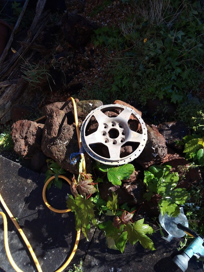

This stuff worked:
Starchem Synstryp
https://www.spraygunsdirect.co.uk/index.php/starchem-synstryp-paint-stripper-5-litre.html#sthash.ZNXhu7mc.dpbs
Nasty stuff, had to wear a full visor to pour this stuff. Use outside, the fumes were bad.
But it worked.
The powder coat basically softens, and you use a paint scraper to get it off.
