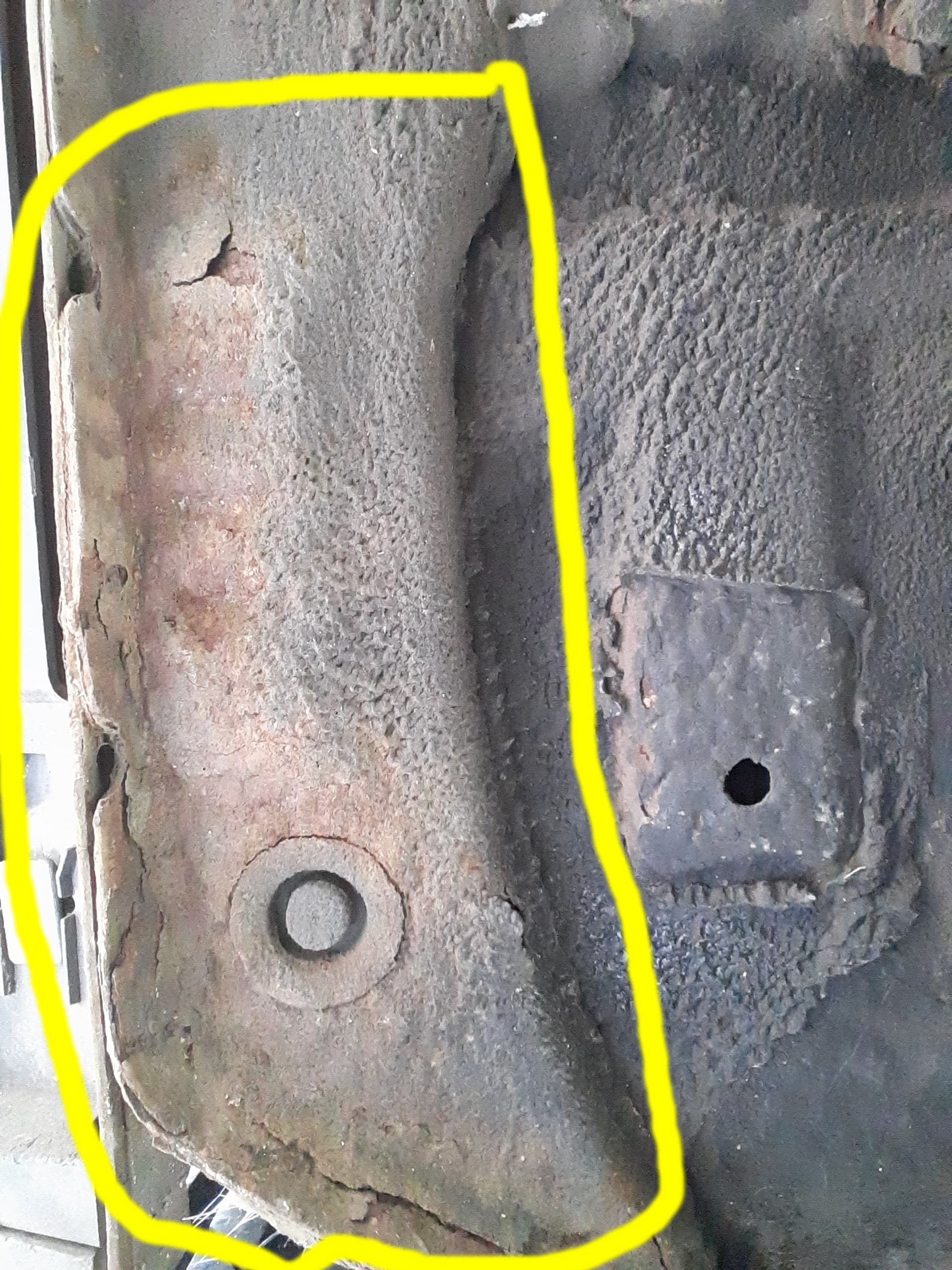

I am getting my car treated with Lanoguard next week (2010 NC2). There are pros and cons with different methods but after research I am going with that then a yearly top up. Most of the factory underseal is sound and well stuck on, even if there is rust underneath the Lanoguard over the top will suffocate it so I don’t see any point in removing it.
My question is, the factory underseal on the rear sills is breaking up and showing signs of rust underneath - I know this is a well known problem area. Clearly it needs to come off here, but once it’s off what is the best thing to treat the bare metal in these vulnerable areas with?

You would normally start by cleaning it back to see how bad it is first, if its not bad then use a rust remover (not converter) and re paint it, something like rustoleum combi colour is pretty good for this without going ott. Then apply your rust proofing.
Hard to see how bad it is.
I think it’s just flaking underseal and surface rust under, it feels completely solid so no need to remove the metal in that case. Lanoguard is modern, covering it in black tar underseal also has it’s downsides, that was not my question though. I was asking what the bare metal should be painted with to protect it.
I don’t think it’s rusted a hole, just the underseal is flaking and surface rust under, it feels solid.
That’s the exact spot I treated mine with the epoxy mastic. I first used a flap wheel to grind away any rust, it was only surface stuff then zinc primer under the epoxy mastic. I finished off, because the epoxy needs a coating over, with Dintrol underseal black.

Rust converter minimum, if by a miracle there’s not a hole the size of an apple hidden under factory coatings.
Wire wheel on an angle grinder, small hand wire brush and some rough sandpaper. Get it all as shiny as humanly possible. Prime with red oxide, which will act as a rust converter, rust proofer and primer. 2 coats of red oxide ideally. Top with underseal or bituminous paint, although because this is easy to reach I would use underseal, which is just a bituminous paint with lots of big soft particles in. The bitumen repels water and the big soft particles absorb stone hits and to some degree sound deaden the metal.
