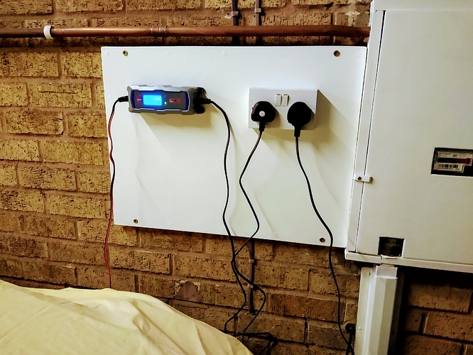

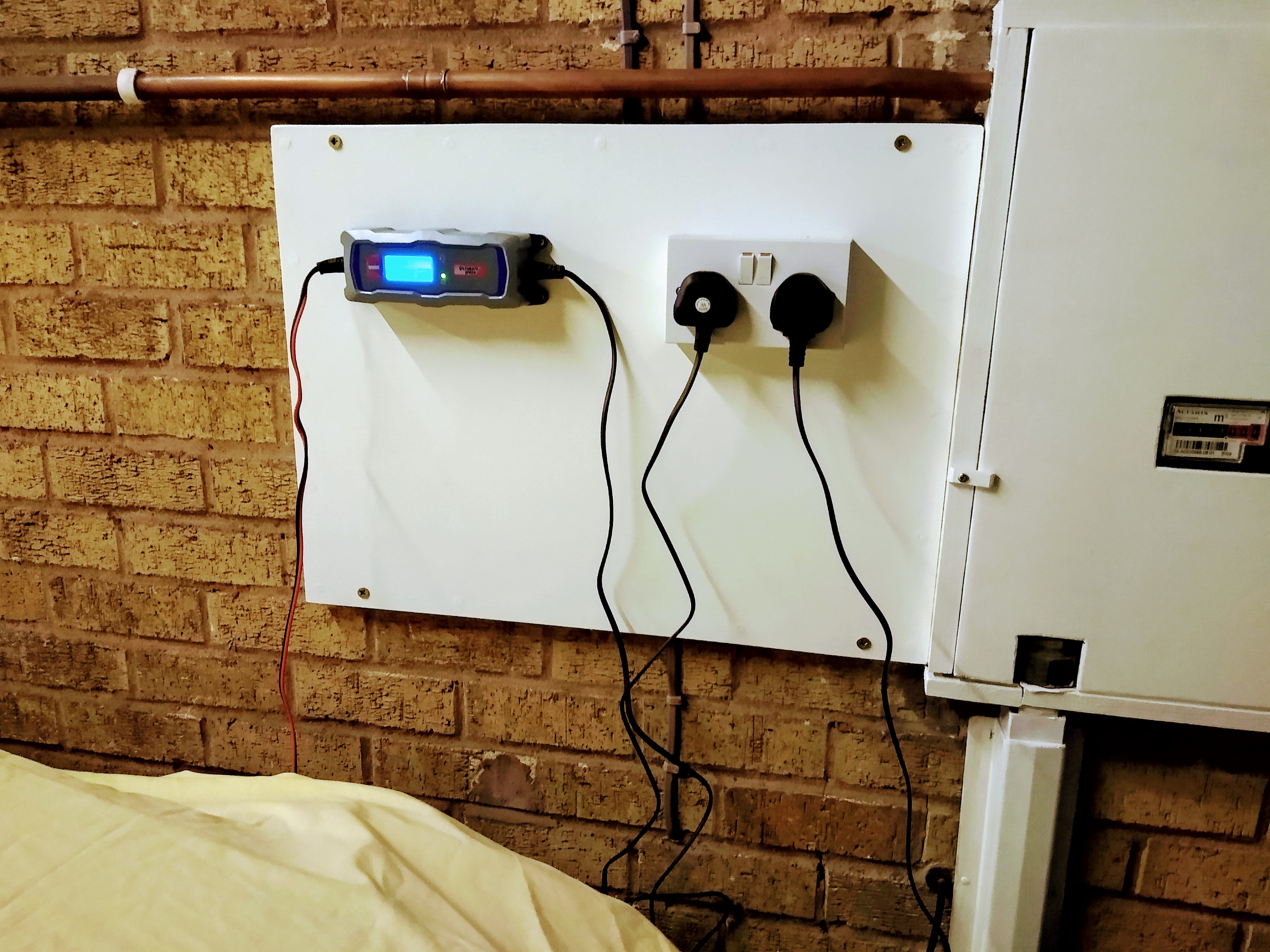

I’ve got the Aldi and Lidl one in operation right now, not much to choose between the two, do the job.
