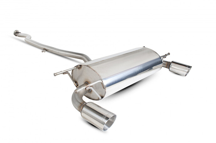

The Scorpion cat to back system is what you want and need.
