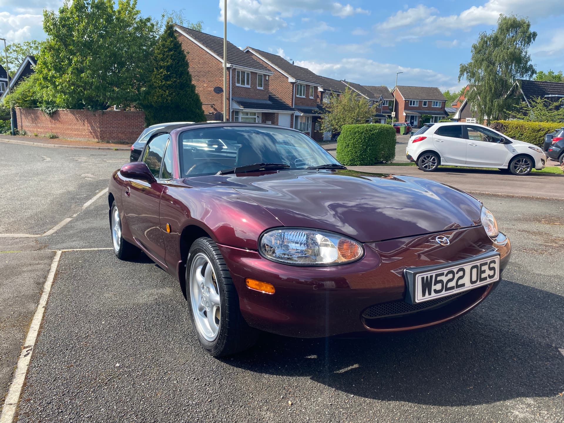

Hi all have my car back from paint shop and looks fab and finally found original s e badges but terrified to stick to new body work!! Anyone have a view on best method?? Much appreciate any guidance, cheers Stuart

Your car looks smashing Stuart :+1:
Thank you so much

Looking Drop Dead Georgeous :smiling_face_with_three_hearts:

Hey thanks! Really happy with it good luck with it!
