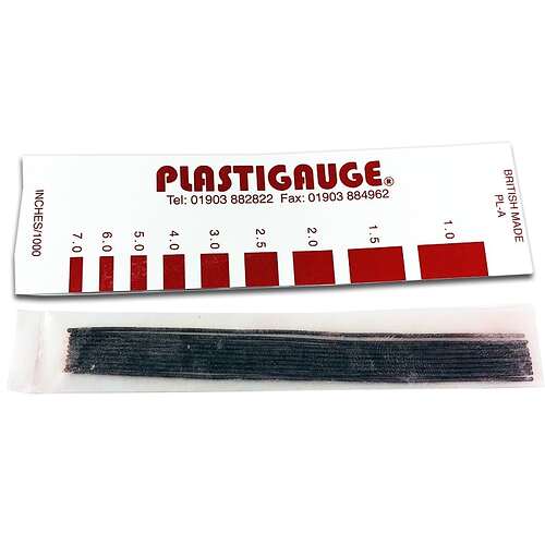

You can always buy some plastigauge to check its all OK.
OK thanks for the advise.
Have now bought the 025 oversized shells which should now be at the correct tolerance. Thank for everyone’s input.
