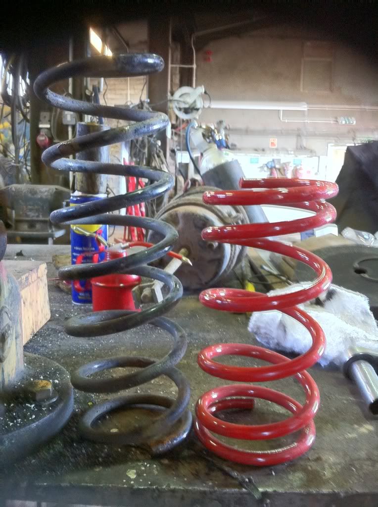

I recently put a set of Mk2 Bilsteins (complete with original springs and topmounts) on a VR-Limited customer car, it jacked the car up quite a lot but it drove beautifully, customer decided he wanted it lower and bought a set of -40mm PI lowering springs which I then fitted for him, I have to say it looks fantastic and he absolutely loves it but does admit the shorter springs have firmed-up the ride a but too much for very long journeys.
See the difference in spring length (rears shown):
