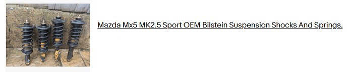

My vr limited is currently on kyb agx struts and unknown springs. A set of mk2.5 bilstein struts and springs have become available not a million miles away (for once!)
Whats the ride likely to be like if i were swap to the billys??

If factory NB springs, the car will ride high. NB Bilsteins had better rates than the NA Bilsteins. I would change the springs for a NB lowering set, such as Tein mediums. The ride will be better mainly because of increased rear shock travel. Obviously include all the NB top mount hardware, and renew where necessary. All NB original factory shocks are now old, so I would use cautiously. Would have been ok 10 years ago putting on low miles used shocks, but those NB parts, unless more recent replacements, are now 20+ years old. Bushes, bumpstops will all be a bit worn. The used parts need to be marked up LF, RF, LR, RR.
