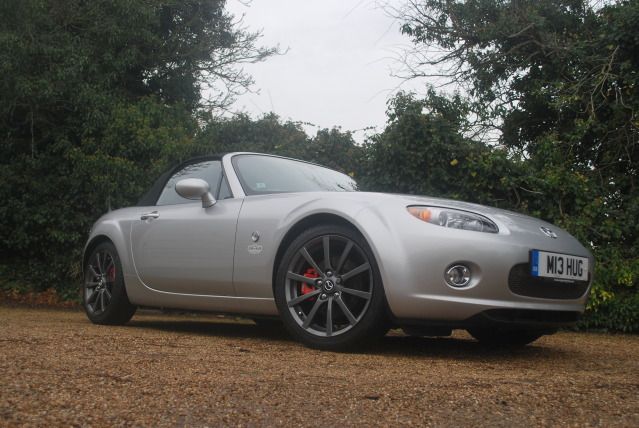

Just a few but it should help you decide Laughing
Anthracite here, it gives the spokes a chance to show up against the black wheel well - and imo, that’s better :slight_smile:

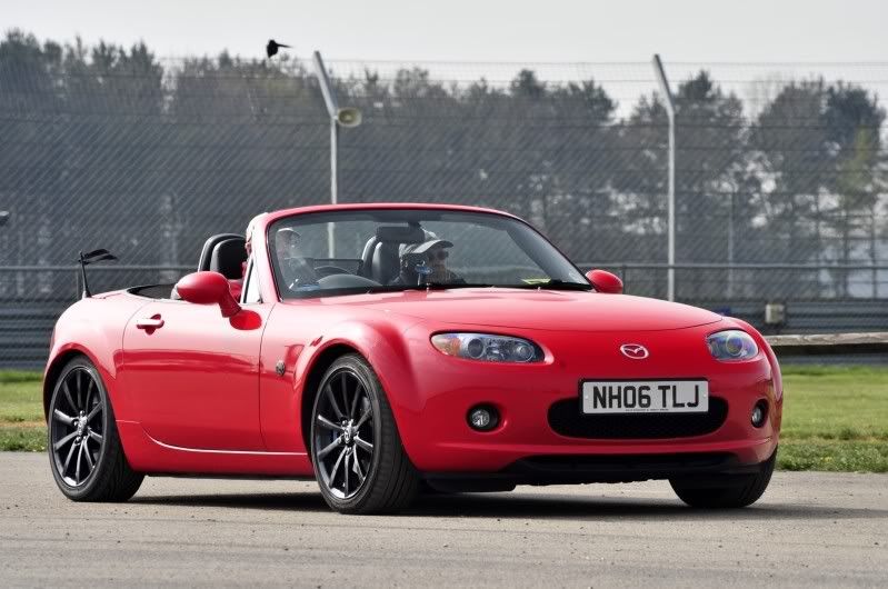

Morning Glory by PGDesigns.co.uk, on Flickr

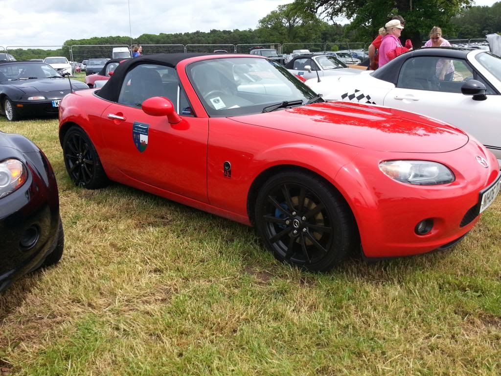

My Black NC MX5 by PGDesigns.co.uk, on Flickr
I think the car looks much better with dark wheels and want to have mine painted.

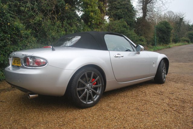

So eventually I had this done to them…
Silver over Black, inner barrels have been wetsanded and polished, front face polished and then protected with Zaino Clear Seal, Z2 with ZFX and Z6.

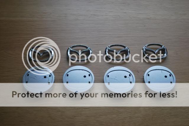

The centre caps are easy 4 tags and the Mazda logo falls out. Much better than £59 from the dealership!

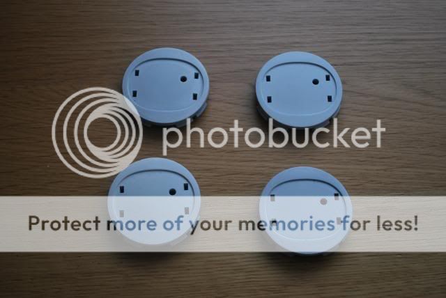

These are standard MK3 Sport wheels powder coated dark grey. I painted the centre caps myself with satin black spray paint.
I sprayed my centre caps, really quite straightforward.
Carefully remove the Mazda logos
Rub down and prime the caps
A few coats of satin black spray, replace the logos when dry. Job done.
