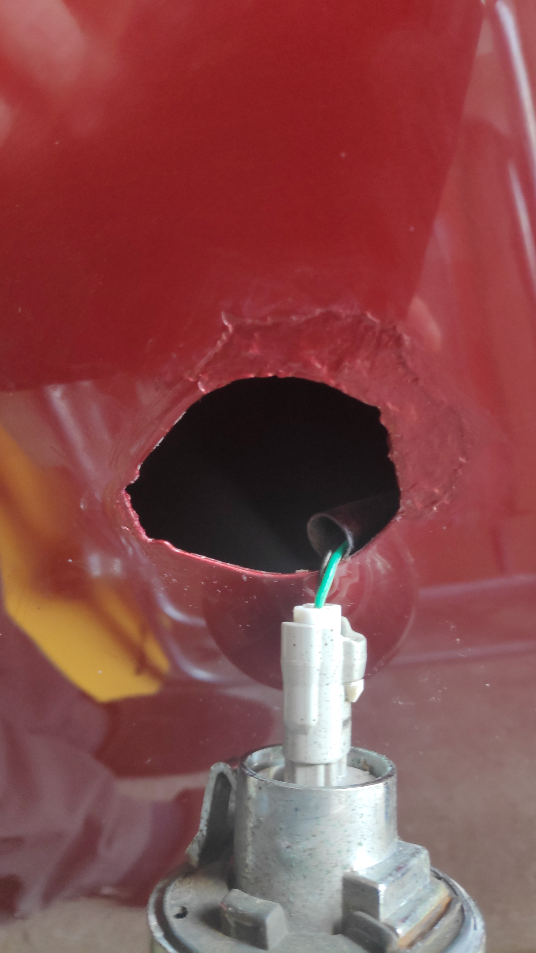

I’ve just discovered surface rust around the offside side repeater. I’ve removed the rust and treated the area, then primed and painted the area to protect the area. Unfortunately the surface is now rough.
Normally I’d take it to a body shop but I’m being made redundant so will need to fix it myself.
The last time I did body repairs was on my father’s Marina in the 80s so I’m rather rusty on this.
I wonder what the best easy to sand surface filler is?
I’d like to keep the amount of repainting to a minimum.
