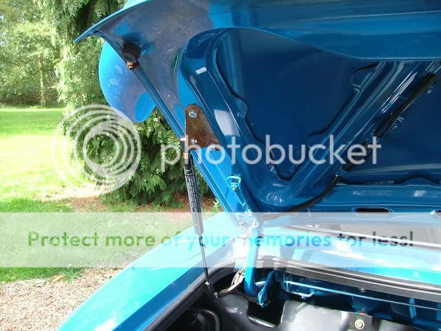

Do you know if this kind of setup can be made to fit a mk1
Yes
These are from RS, I hadn’t painted the bracket when the pic was taken. I’ll get a part number tomorrow
Great thanks, I dont have a spoiler but I am fitting a boot rack, do you think it will work as well ?
Mine worked with a boot rack and spoiler, but didn’t like a 20kg suitcase as wellWink
That was my next question  mmm guess I’ll have to remember not to carry luggage on my new luggage rack Embarassed
