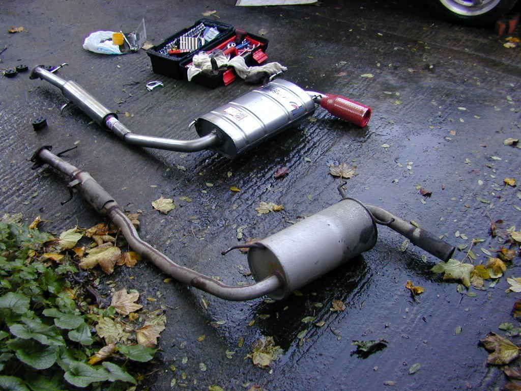

The rusty scrap below was a 18 month old Timax, taken off a 1990 Roadster. Note the hangers.

To summarise, there are 3 different backboxes for the three different length cats. The bracket you mention indicates the wrong part for your car. These parts vary in length and are not interchangeable - I know because I sold a customer the wrong part as the Klarius listing for the later UK cars was incorrect and ended up retrieving and re-supplying.
